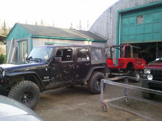

The day after I towed it home

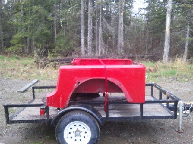

My Tub as it was delivered from the junkyard, looks way better in these pictures than it really is! has a lot of patching and bondo in the floors and rockers.
On my little trailer behind my JK about to get hacked up!
I will end up having to cut it back further I just wanted to get the tub down to a more manageable size to work with

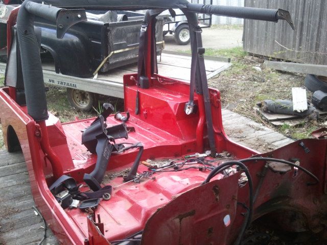

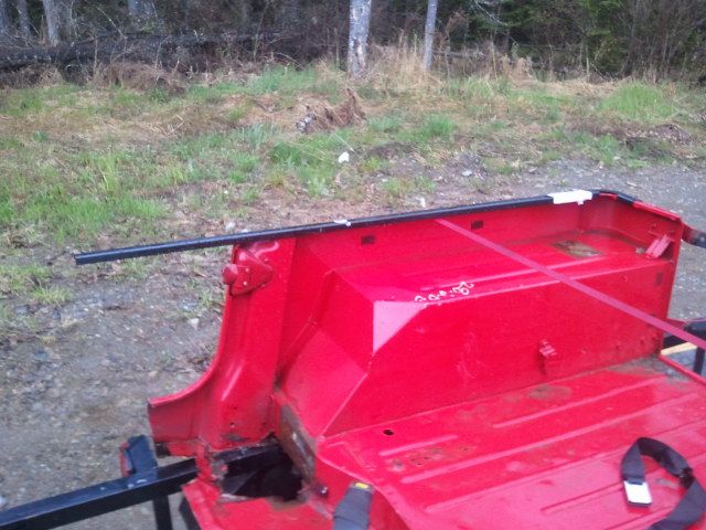

I bought the LJ belt rails from the Jeep dealer, here is one sitting on the donor tub showing how much length difference there is!
I searched high and low for an LJ roll bar...the only one that I found the yard wanted ridiculous money for. I bought a TJ bar from my local yard instead. I will end up using the main hoop and front spreader bars and fabricating my own rear bars.
Here is the YJ with the LJ top sitting on it, also a junk TJ upper in the half door. I started pealing off the nasty decals too!

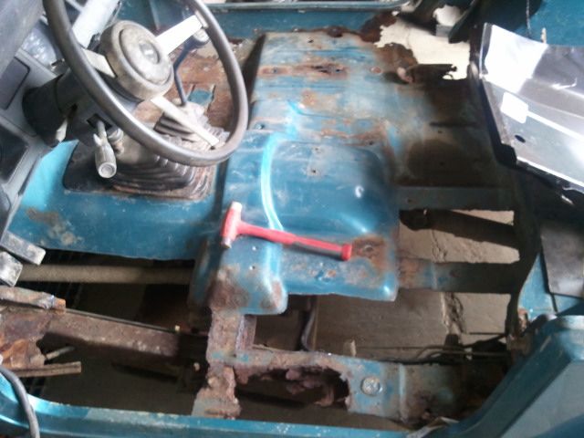

I began cutting out the floor pans with the plasma cutter. I left the metal on the floor supports for now, need to drill out the spot welds and remove the remaining floor material.
This is where I ended up yesterday afternoon. It is tough to find time to work on this as I work 60 hours a week at my full time job during the weekdays, weekends I work as a reserve police officer at night, plus I have a wife and 13 month old son!

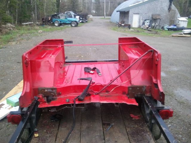

In the time since my last post, I went and picked this up!

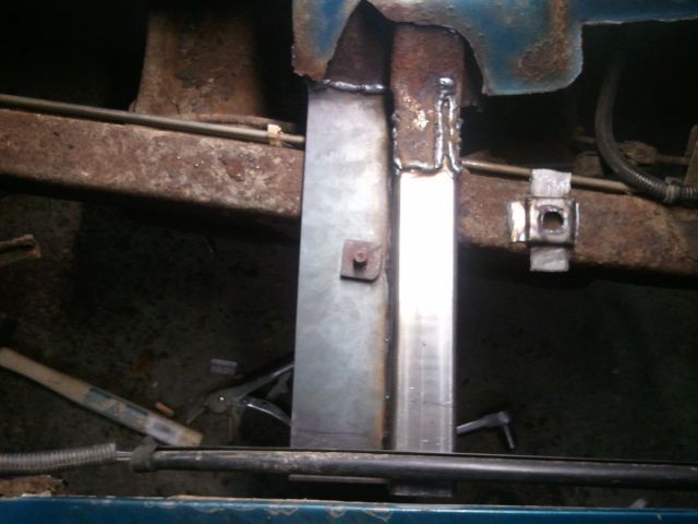

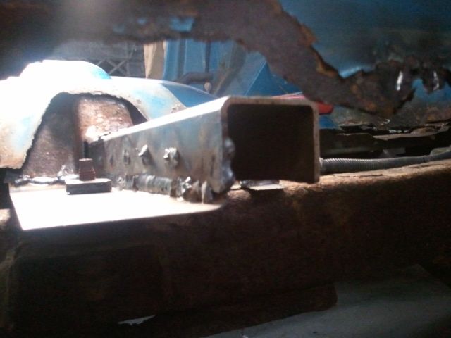

I had a couple of hours tonight to work on the old rusty jeep! I have the floors pretty well removed. The floor support channels that also serve as the body mounts are pretty well shot on this side of the jeep. I considered buying the classic enterprises prefabbed floor supports, however it would have cost around 200 for the 4 pieces that I need to replace (assuming pass side is just as bad as this side! I bought a bunch of steel from my local yards scrap pile and only have about 13 dollars invested in more steel than I will need to complete this repair!
I started with a piece of 2"x2" square tubing that is 1/8th inch thick. I cut 1/4 inch off of one side of the tubing to open it up into like a c channel. I then took a piece of 16 gauge steel and put a 90 degree bend in it with my metal brake (quite a task in a cheepo metal brake!) Welded the 16 gauge to my c channel and welded all of that to the good metal that remained of the factory brace.
Here are some pictures...
In this picture you can see the cage I am building for to capture the body mount nut.
I think that I am going to boat side the rockers, If I do that this piece will have to be cut down some!
Hopefully I can get another chance to get into the shop this week and rebuild the rearward body mount support channel. Then I will be pretty well wrapped up on this side and can start welding the floor pans in!
