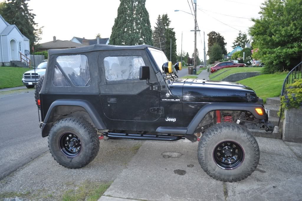

Here is a pic about a week after i Bought it.
August:

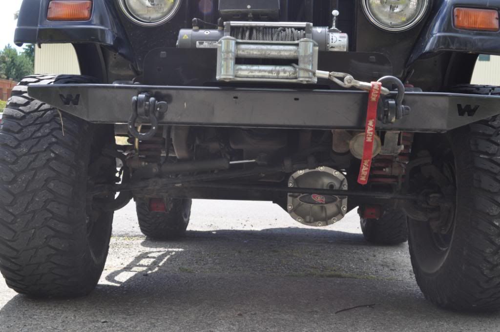

Early september I sold my streetbike and decided to put the money into the jeep. I started with a Warn winch bumper and M8000 Winch included all the goodies as well as a hi-jack. I bought some used boggers off craigslist and had them mounted on new steel wheels at les schwab. After a few other small things and an aussie locker in my dana 30 the bike money was gone.

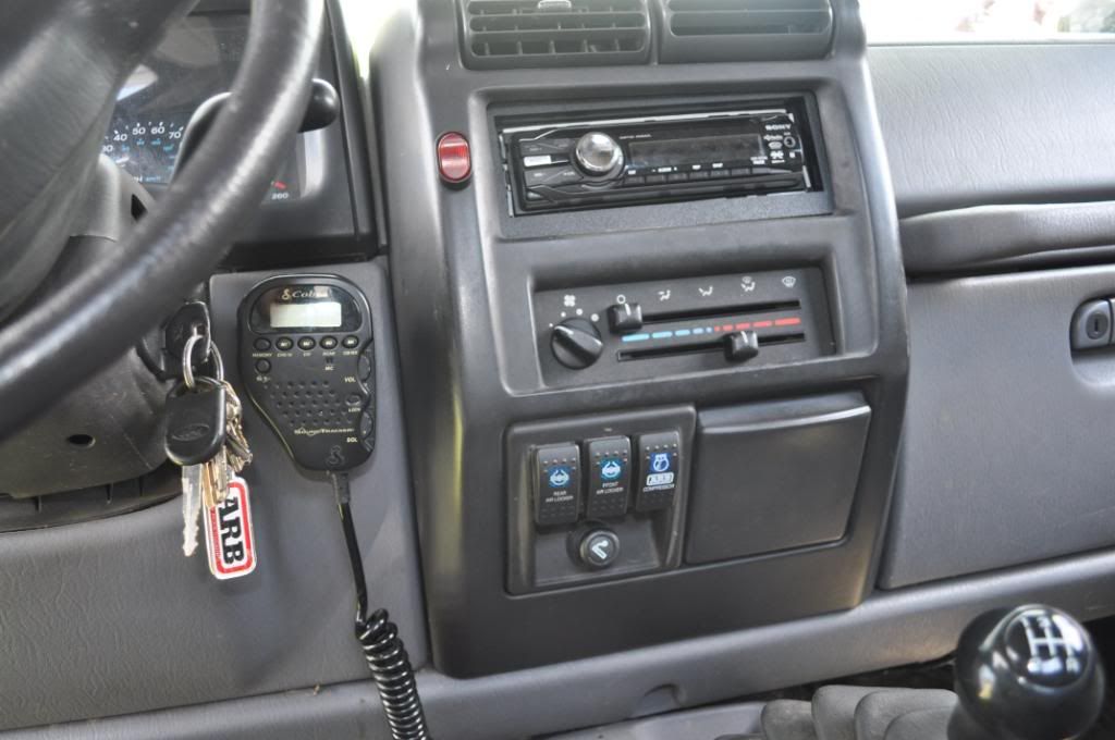

With christmas coming I only managed to get a cb, speaker, and antenna

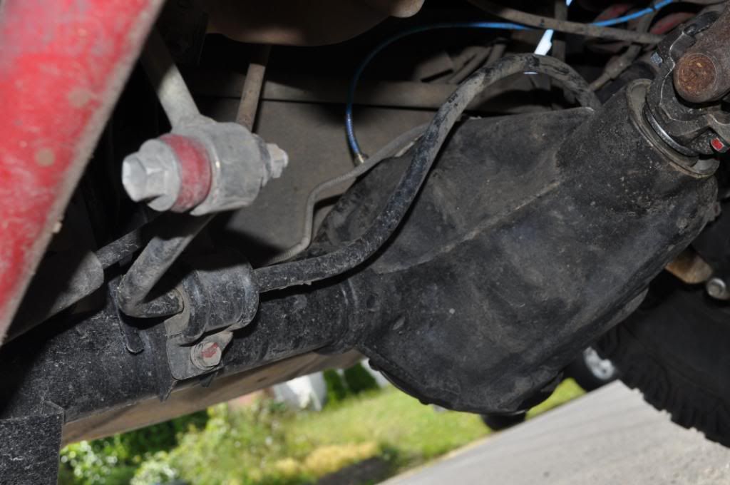

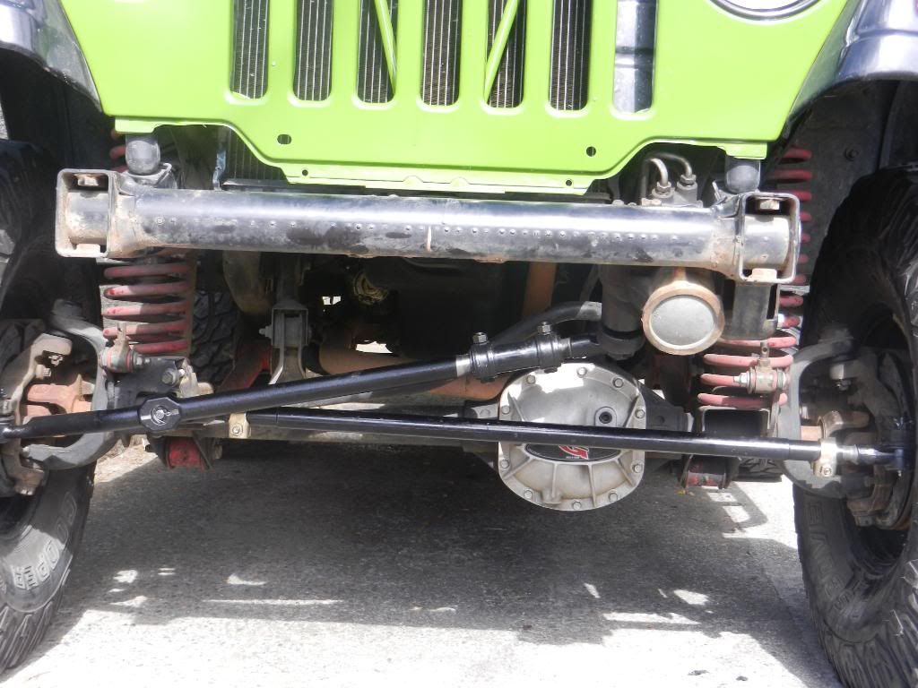

Had my first major break. Broke a drivers dana 30 axle Shaft destroying the carrier in the process. I was winching out my bro's stuck 4runner on 35's and trying to back up I know mad choice. He was swamped. I had the dana 30 Completely tore down and rebuild with Chromoly axles, new carrier, bearings ect Also the aussie was reinstalled.

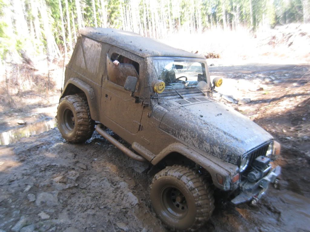

Anyways thanks for viewing my build Its still a work in progress and here are some pics. These were taking the day I broke my axle a few weeks back.
