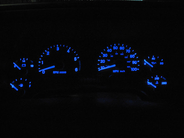

another small mod i did since i dont have much cash left, i had a few dollars ($11.64 to be exact) left in my paypal account so i decided to go ahead and buy me some blue (i dont like blue, but my jeep is blue)LED's for my guage cluster. It looks pretty cool actually.. below is a picture of the now blue lit cluster.. i couldnt take before pictures since it was to light but im sure ya all know the dull color.... Also please excuse the fuzzy picture, i didnt have my camera..

That looks cool man I might just do that myself...was it easy?

It was very easy.. pop off the top trip over the dash, take out the 3 screws in the top of plastic trim over gauge cluster(phillips or 1/4 socket) then pull that plastic trim off then the 2 screws by the knee panel, after that the entire gauge cluster is exposed and there are 4 more screws and the gauge cluster comes right out. then replace the 5 bulbs with the brown color socket, they twist and pull right out.. Now you need 5 LED wedge bulbs, i ordered from V-LEDS ill get you a link if you want.. they come two in a package so i got six..
Any questions lemme know...
