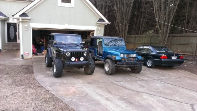

Here's a pic of back then:
its not much but i love it. i was overwhelmed by maintaince as things went wrong over the past year so i could not do many mods but in the past year i have put 16k miles on it. here's a list of everything that was rebuilt/replaced

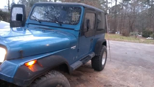

a few months after having it i was looking for a new soft top because the black one was getting old and stretched, found a tan best top with 3k miles on it for $150 but actually got it for $145 because the guy i bought it from didnt have change for a $20
I liked the tan top much more, i think it goes better with the paint.

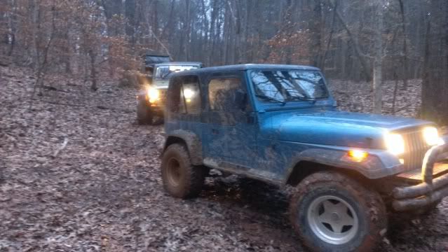

once it started warming up i went on my first wheeling trip with a group i found on FaceBook which i now consider my 2nd family.
Three Wheels!
Who needs a jack when you have an Andrew?
I had a BLAST that day! We hit up Dodd Rd, Persimmons Rd, and Bell Mountain! When i first met up with them that morning i was nervous after seeing everyone there was running 6in lifts and 35's because i thought i was going to be the hold up all day. To my surprise i made it through everything they did, i just had to do it in 2nd 4wl with more skinny pedal.

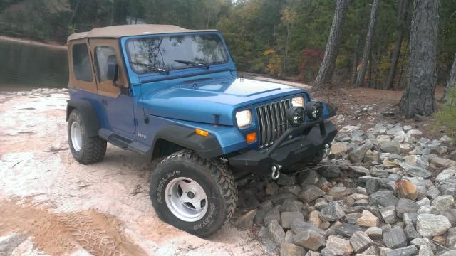

Look at my rims compared to the first pic i posted! i used the stuff we use on pontoon boats to redo the toons, all i did was spray it on then rinse haha they look new!

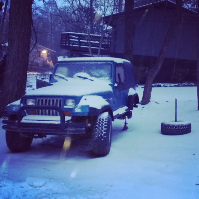

fast forward to present day this past week we had snow. im not sure about you northerners but snow in GA is rare. this ment 3 straight days of trail riding!
sadly i had to stop after 3 days because at the end of day 3 i busted my steering box and had to get her towed home, it was a sad day. my first trail breakage.

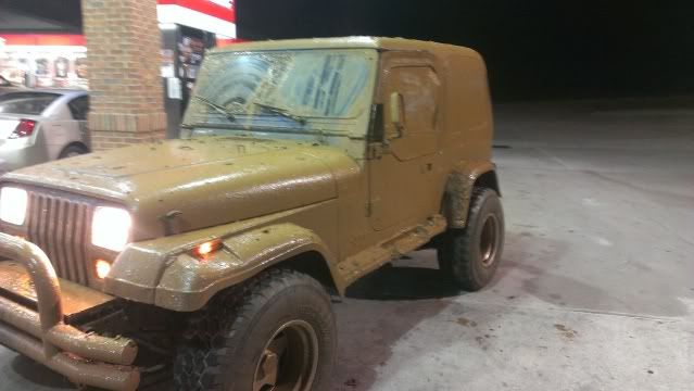

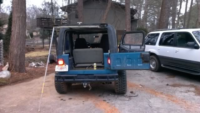

well i was in a hurry to leave the trails because something came up and well.... i was going too fast and wasnt paying attention to my lines and ended up in a mud pit...
after $18 in quarters at the local do it yourself car wash
still lots more cleaning to be done, i've pulled the back seats and the console. luckily for me i work detailing boats and have everything i need at my disposal to do a full detail. even better tomorrow we dont start until 11 so i'll go in early around 9 and clean out all the mud from the inside. this thing is far past due for a full cleaning. i may even buff and wax it

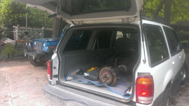

i got on Craigslist and found a complete D35 with 120k miles for $80 so im waiting until i can get my explorer out of the driveway to go pick it up.

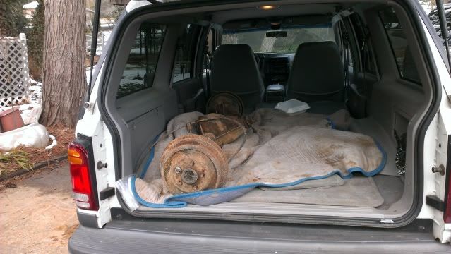

well the story continues. i was browsing Craigslist trying to find a D35 i could buy and pull the drivers side shaft and brake assembly from. i found one for $80 so i went and picked it up... well... turns out that there were 2 versions of Dana 35's the earlier ones had 10 inch brake hubs and did not use c clips to hold the shaft in. and the axle i got was the wrong version so the next day i bought another off Craigslist now knowing which i needed and how to spot the difference. between the two axles there really are not ANY interchangeable parts.
here is the first one i bought, all loaded up in my trusty exploder

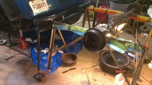

and after that one didnt work i got another that did work, here is from when i had it apart doing the swap
got it all put back together today and now im just waiting on the sealant to dry so i can fill the axle with oil and i should be on my way. i dont have any pictures of it all put back together because when i finished my only concern was taking a shower. i was covered in gear oil, kerosene, PB blaster, mud, brake dust, and brake fluid. it was awful.

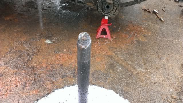

not really much of an update but i got my jeep running last night and drove it all over today everything seems tight
Here's a pic of what i spent hours pulling out with a magnet haha
there were a whole lot more smaller chunks and tons os shavings. luckily all were in the tube and didnt make it into the diff

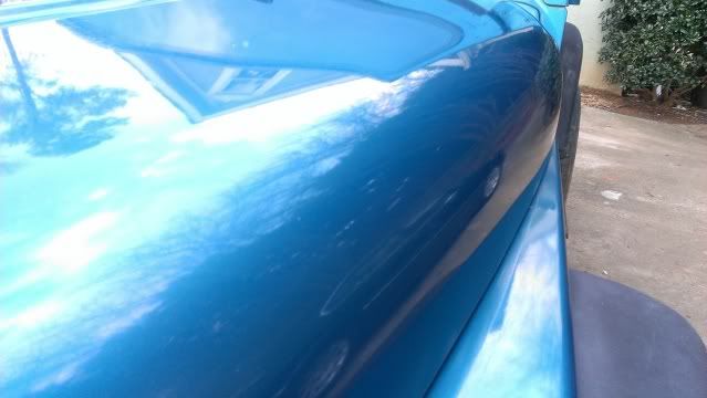

after work i decided to buff and wax it. the paint was getting "etchy" feeling if you know what i mean and needed attention. turned out well!
sadly i did it at a friends house and didnt have my doors on.... so doors did not get buffed and waxed but thats next!

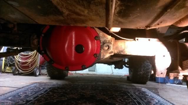

oh yea, while i had it apart i paint my diff cover, just because haha

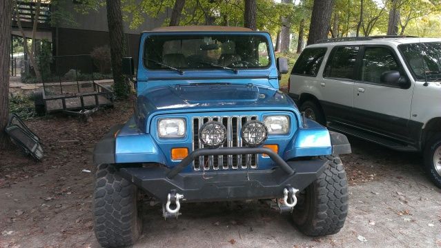

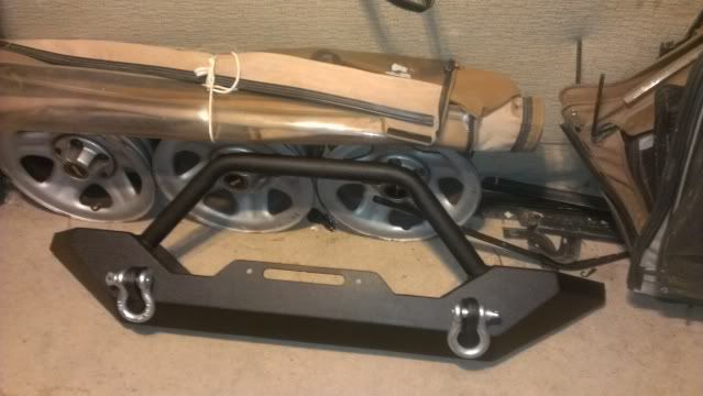

well awhile ago i bought a new front bumper and today it showed up. i didnt tell my parents i had ordered it and it came wrapped up in a bunch of stuff instead of in a box. this was the texts between me and my mom
here it is
getting the old one off was a *****. a PO had welded the tube bumper and a bunch of other junk to the frame that i had to get off. took 4 hours of grinding, saws-all-ing, hammering and prying. then i find out that the mounting holes were a good 1/2 inch off so i messaged the seller making it seem worse then it was and asked for a 30% refund. even if i dont get it i will keep the bumper. it was too darl to get a pic, but it actually looks really good on my jeep. soooo much better then the barbie jeep bumper that was on it!

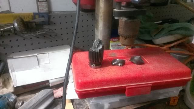

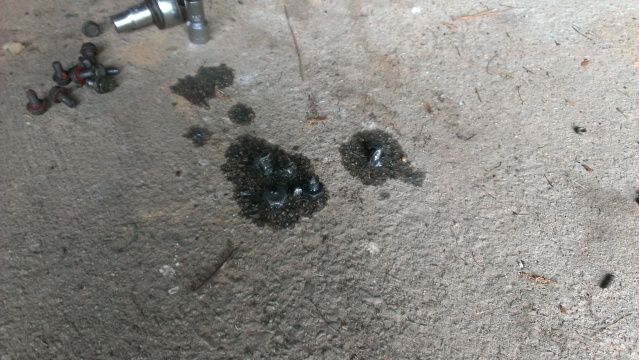

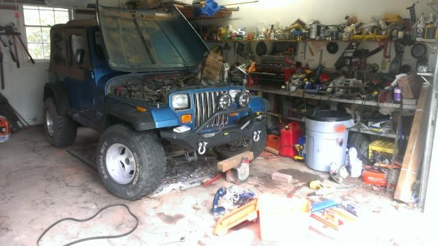

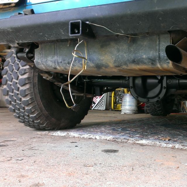

this little puddle of oil and metal is what was left the bolts that hold the ring gear on the cluster in my rear axle. at this point it wasn't worth rebuilding and since it was the 2nd time in just a few months i had broken a dana 35 i figured it was time for an upgrade.
after a day of hunting at the local pull-a-part i found an 8.8 with 179k miles, 3.73 gearing and LSD. i know the lsd is not as strong but i plan on getting a locker here soon so until then its more fun on the streets with LSD. i can not weld so after i got the axle i turned it over to a very well known local off road shop called SBC for the install. halfway in they told me i needed either a tc drop kit or a SYE. if it wasn't at there shop i would have installed a SYE myself but since it was there and i couldn't afford an SYE and labor for then to install it i had them put in a 1 inch tc drop.
SBC did a very nice job putting the axle in. and the jeep was soo much better for it too. before it would vibrate and make bad noises under acceleration but now it drives very smooth. i could not believe the difference. it made the jeep much more drivable.

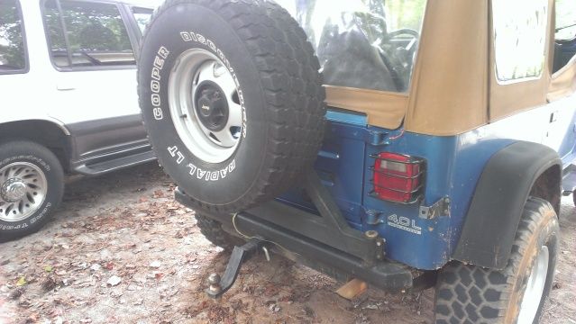

one day when i was at work my dad came in and showed me a picture of a rear bumper and said the guy wanted $80 for it. i said hell yes and told him to go get it for me. here's my $80 rugged ridge rear bumper and tire carrier

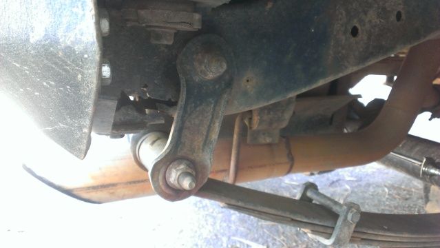

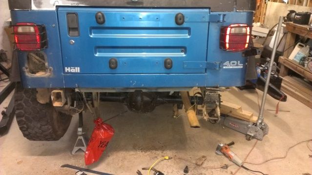

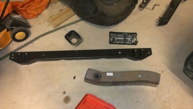

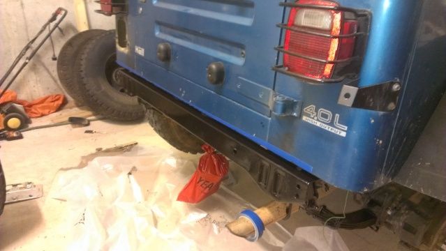

well this last week has been pretty eventful. been working on my frame pretty hard. this is what went on

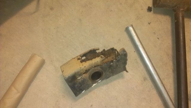

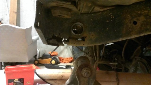

well my rear passenger shackle was rusted and the rear cross member was rusted and crack so my rear tire care had a lot of movement and it was just scary.
after cutting the cancer out
mhmm tasty.
to go back in
all put back and painted
im going to go ahead and paint the entire frame with por15 to protect it all. i was pretty surprised with myself during this being 19 i cut the frame out and put it back. it was not something i really ever thought id do.
and i know cosmetically it doesn't look like ive done much since ive bought it, but its a completely different jeep then it was. next on my list now that its back to a good running platform i plan on collecting parts for a power steering conversion using a durrango box. after that im going to look into a high quality 3.5-4.5in lift to replace this skyjacker that i believe it about 10-14 years old. i like the size and dont want to go much bigger over the next 5 years i'll be doing a lot of traveling and this jeep will probably take me to Chicago and back a several times so im going for a reliable daily driver that is comfortable to drive on long trips and still good for weekend trail riding but nothing too extreme. we'll see what happens.
