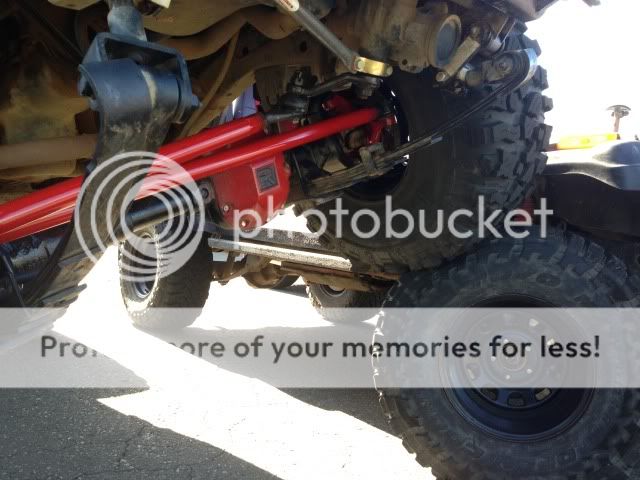

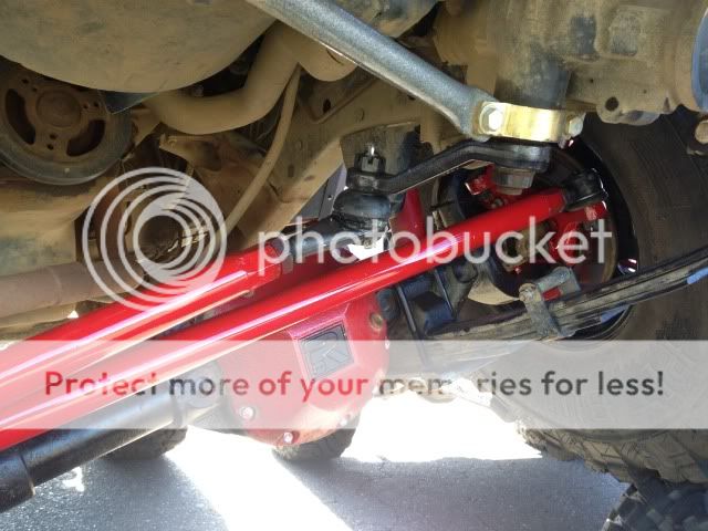

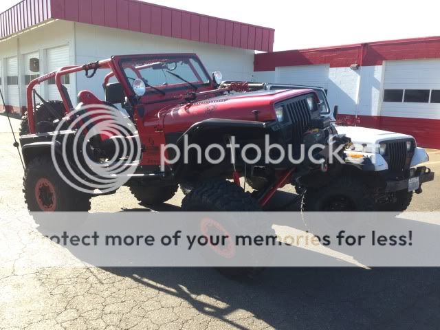

So I got the knuckles back and threw some paint on them and also took measurements for the draglink-22.25 and tre 40 inches. I plan on havering the shop cut and weld them soon!

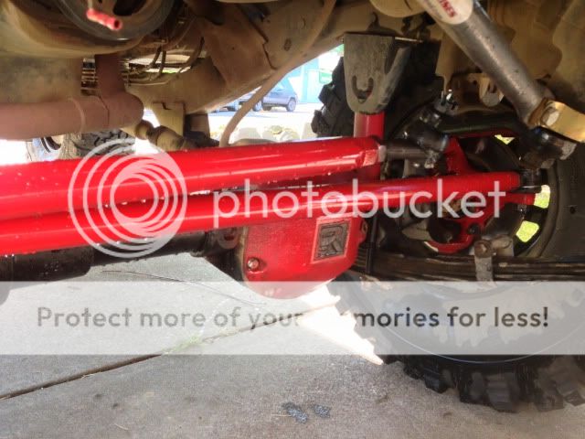

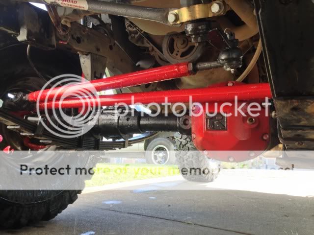

Steering is done, I put it on the alignment rack at work only to find that I eyeball set the toe dead on. All I had to do was adjust the draglink

Did you cycle that yet? The drag link and tie rod look really close in the pic.
I have't flexed it out yet if that's what you mean, it does fine on the st, I do plan to replace my springs at some point so that should help!

Are you using the "high angle drank link TRE" ruff stuff sells or is it the "standard TRE" for the TRE on the pitman arm? Set up looks really good man

It the high angle draglink tre at the pitman arm, and thanks!

Looks good, but I have a feeling your pitman arm TRE is going to hit the tie rod when you flex you driver side. It looks really close in the picture, especially knowing as the spring flexes the tie rod is going to move forward. LouieYJ had the same issue. I got the ruffstuff 3/4" Heim steering so basically similar to yours but with Heims. Looks good in red!

Ok so I drove up my buddies yj (33s) to see if it would hit but it clear fine not saying it won't stuff more but........
On a side note after rotating my tires on the way home a had a small wobble in the steering wheel......do you guys think it would matter if a added a couple oz of off air soft bbs to my dyna beads?
