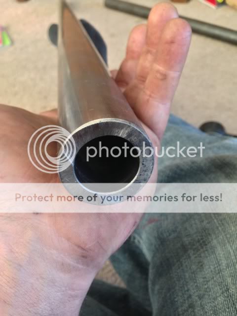

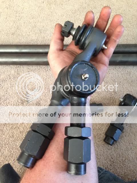

Lol all puns intended? Haha well some new news my steering showed up today and all I can say is DAMMM! This stuff is beefy

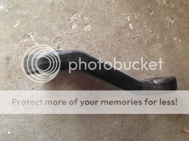

I heard max backlash is .015 so I figured that .010 should be gravy, either way I'm go to rock it until the gears fall off haha. On a side note I got a stock pitman arm from azdevilyj (big thanks) in the mail today, I plan to have the local Offroad shop drill and ream my knuckles/ pitman arm mid next week. I would start tonight but I have a Memorial Day run on Monday So.............
