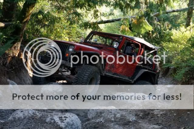

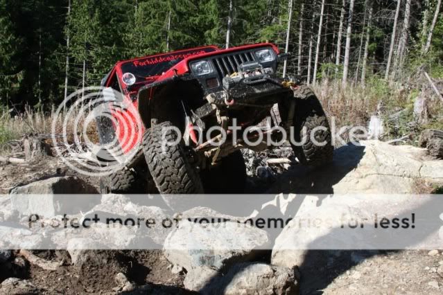

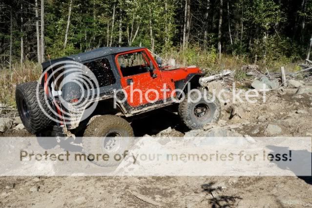

Looks like a fun terrain to wheel
Oh it is the trails are always changing here with rain,erosion,buggies etc haha!

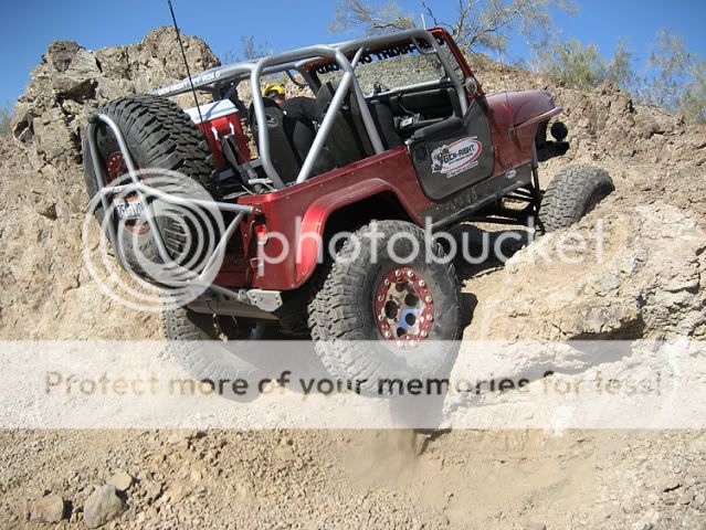

Looks good. What are you going to do to carry your spare? I have to get out with you again some time soon.

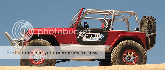

I plan on getting a genright style carrier my current bumper jusg weighs to much with out the tire it weighs about 150 by its self haha! Genright claims there carrier is only 55 lbs! And yes we need to get out together sometime soon haha maybe a snow run?

I've been planning on building something like that for a while. I just can't hammer out a final design. It'll look good on your rig. We need to get out before there is snow. Snow runs are good too though.

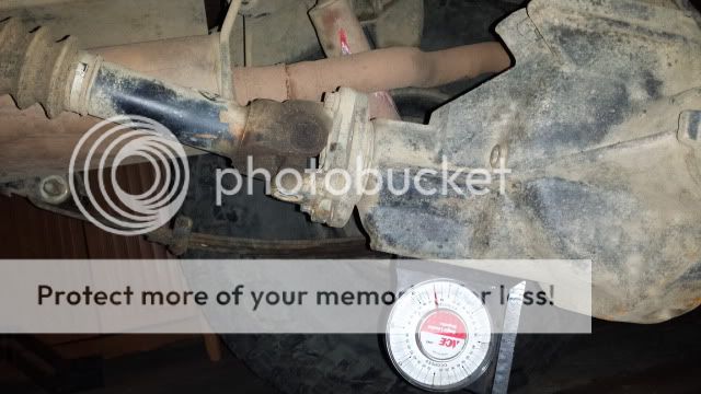

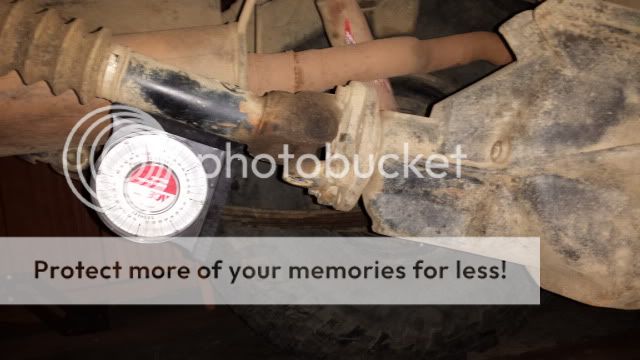

So ever since I installed my 5 inch springs my pinion angle has been of causing vibs since the perches had been burned in when I had my sagging 3.5 springs, so I ordered some degree shims which should be here thurs.
The drive line is at 24 degree angle
And the pinion is at a 19 degree angle
So I figure a 4 degree shim should get me real close right???? Haha

Does the Genright carrier fold down or swing open like normal? I like the way it looks
Swing down
if it was an option, id say 6-7* looks best?
I say 4*.
Remember you want it 2-3* low to account for axle wrap...6-7* would put it high.
The pics on my phone make it look right to my eye. Just a tad below dead nuts straight which is what you want...
Not to mention 7* shims will be like 5/8" thick! That's a lot of lost lift and weird pressure on your ubolts, ect..
When/how are you getting vibes?
Cheers
