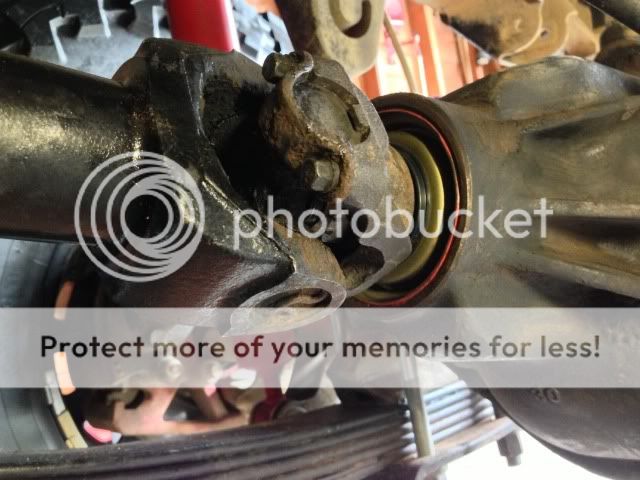

So I change my front pinion seal this morning, and I didt take a pic of it but I may be ready for a new yoke up front there was a small grove worn in it where the seal sits........not sure if that's why it has been leaking or not!
My rear yoke was the same way! I replaced it
You replaced the whole yoke? I am going to price them out tomorrow!
Yup, i had a spare from that 35 I bought a few months back. Is your pinion bearing tight? I think that's how I got the grove in mine...
Yeap like a tiger
