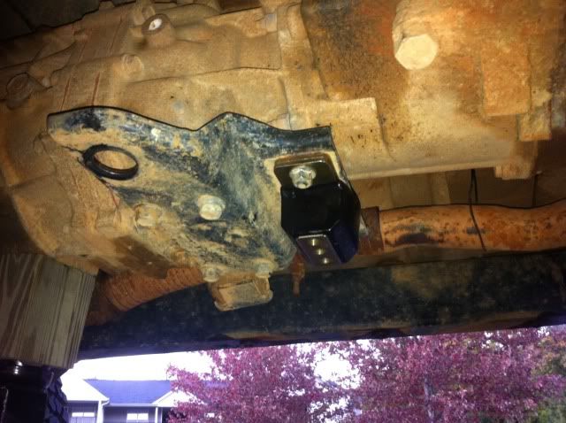

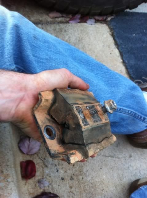

Originally Posted by trailrider787 View Post
Did you end up using the poly mount? Yeah I was surprised at its condition.
Yep. Here's mine. I think the MML will ease some of the angle.
Lou
YJOTM July 2012
YJOTM February 2014
Yeah I see the nice crack... I'm gonna keep looking for a replacement but possibly a shorter one. I could always modify my belly pan if I wanted.
