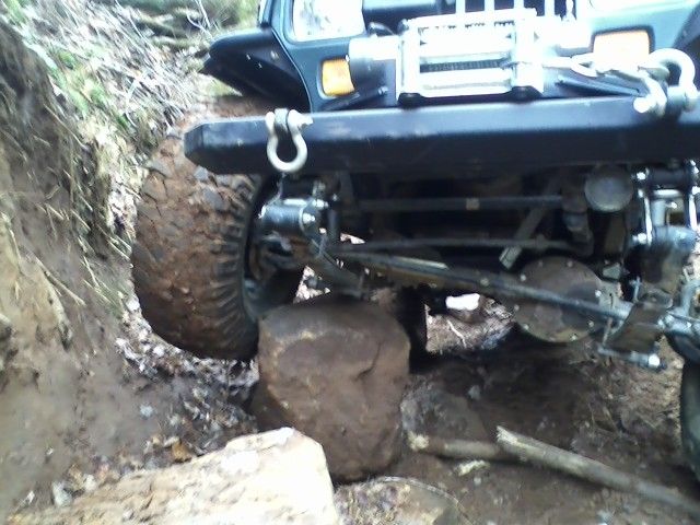

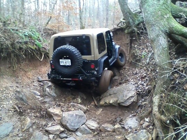

So the trip to Morris mountain was great...up until i broke my driver front shackle mount. Thankfully my buddy I went with knew how to temporarily resolve the situation to limp home. We actually kept riding after dropping mine off at camp. It's always fun to be a passenger / spotter. I think I will end up buying some MORE replacement hangers.
