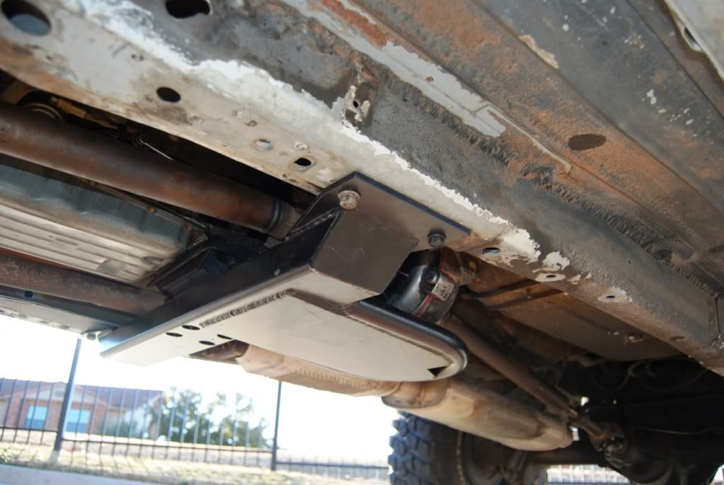

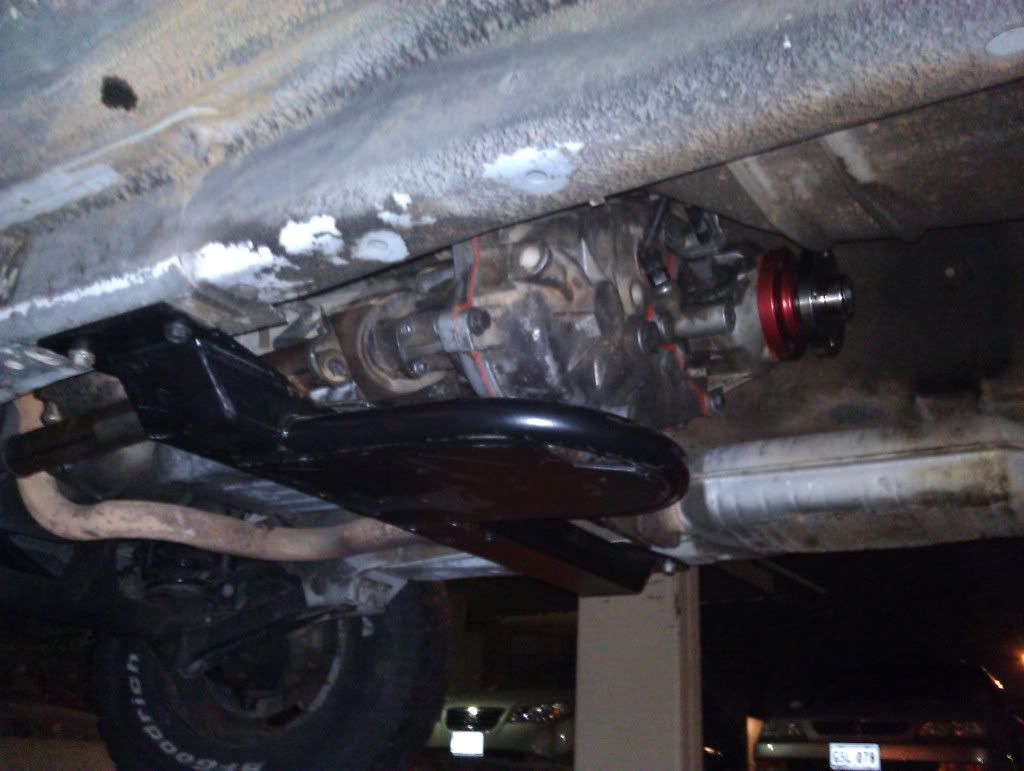

Got the tcase in. But messed up on the last ujoint on the driveshaft so I'll be taking the driveshaft to someone that has a shop and the right tools to do it. Tired of beating on ujoints. So frustrating!
Anyways, heres a picture. Also installed the 40lbs package I got.
Just need to get the driveshaft figured out, then I'll put my new wheels and tires on, along with the 96lbs package and the 60lbs package.

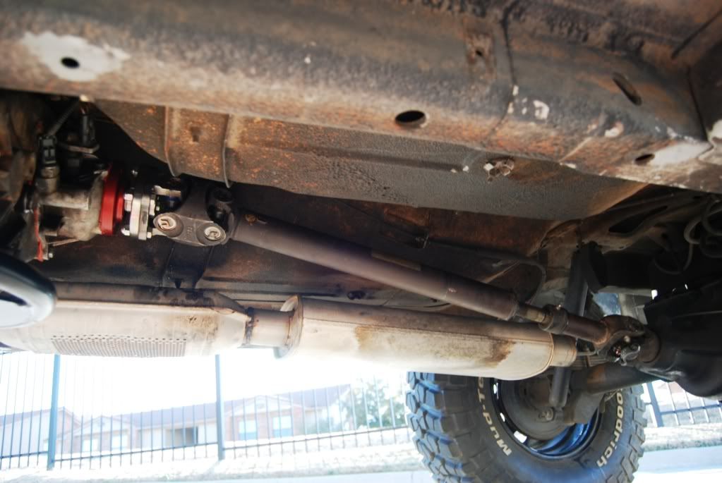

Been an awesome day in my Jeep world.
Left work early and picked up my rear driveshaft from Baertrax. Got home, filled up the tcase with fluid, installed the driveshaft, jump started the Jeep, and drove it for the first time in 3 months! Oh how I MISSED my Jeep! Up next was putting my 32s on. Finally got that done, and cleaned up the messed in the back of the Jeep.
Now for the pictures.
Now to paint my other packages then install them.
