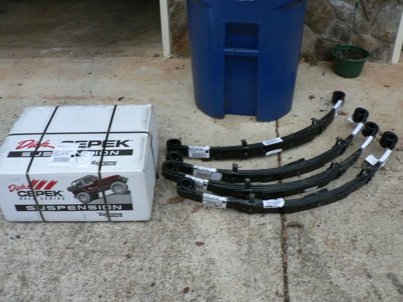

In the meantime, UPS brought me some goodies yesterday. I got an exhaust pipe (from the manifold to the cat), a Magnaflow cat, a tail pipe (from the muffler back), my spring/shackle bolt kit, and my RC big-bore steering stab.
I also got an email with my tracking # on the lift kit... it's supposed to be delivered this Friday.
This Jeep is gonna look funny with 3.5" of lift on 235/75R15 tires!
