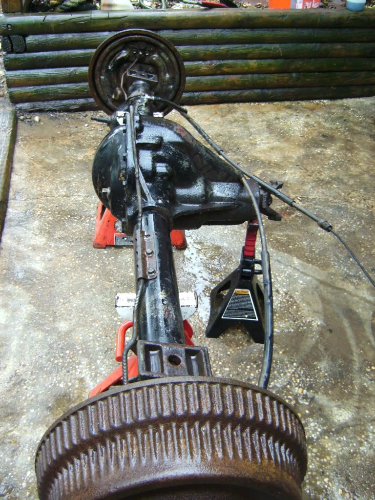

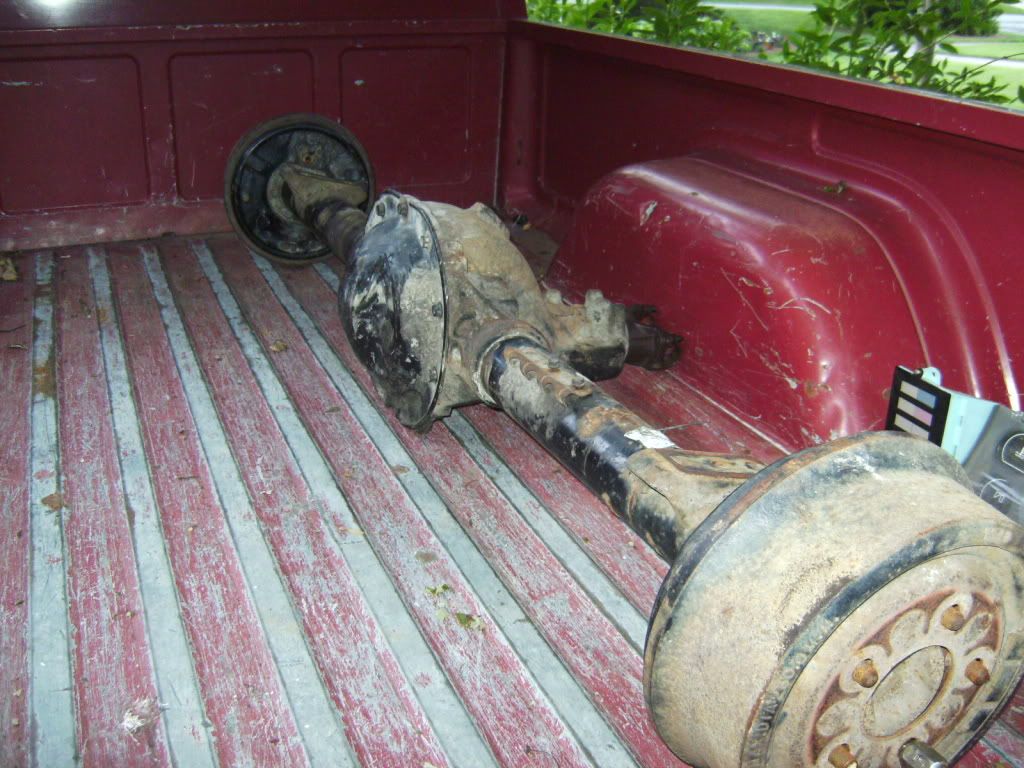

I'm staying with my original plans and using the 8.25 that I've already started on. I was really thinking of selling the D44, but I've been swamped with a bunch of low ball offers so it looks like it will stay in the basement (there's always the next project). The D44:
Here's the 8.25 I'm starting with. '99 model, drum brakes, 29 spline axles and 3.55 gears.
I spent today cleaning the 8.25 up and getting it prepped to have the new perches welded on. If everything works out I hope to have it ready to go in by Monday or Tuesday.

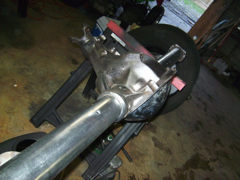

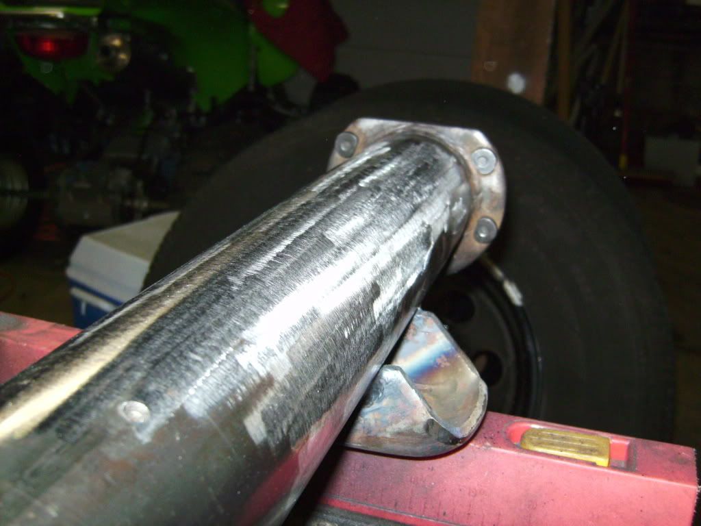

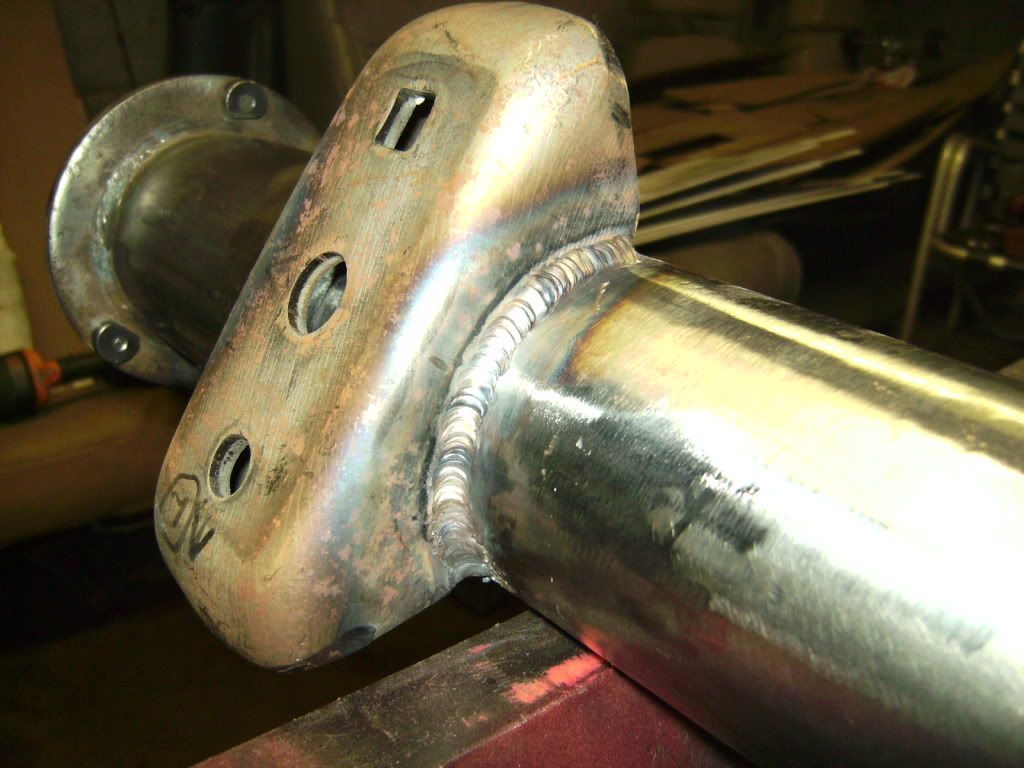

Making some progress on the rear diff. Got the perches welded on, the brother in law did a pretty decent job. Some pic of the welds:
Another shot:

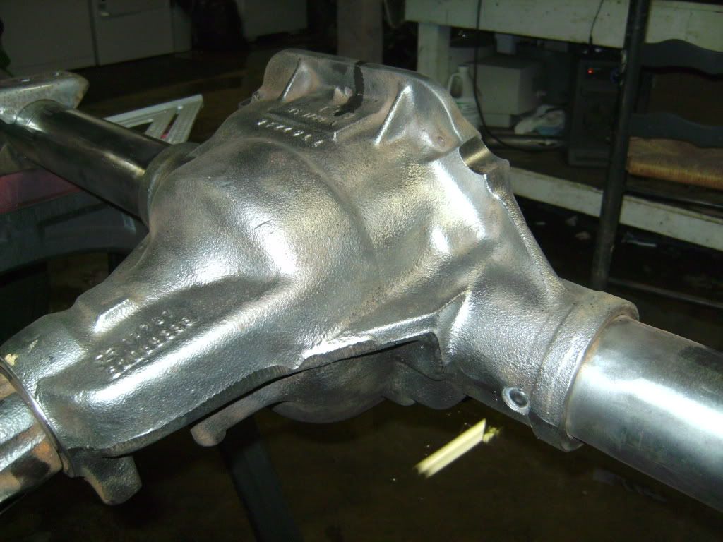

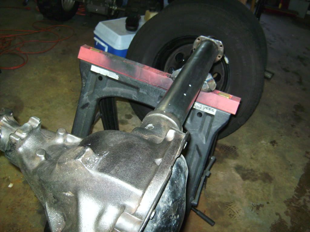

We welded the perches parallel to the old XJ ones and after they were welded I cut the old ones off and smoothed the tubes out:
Ready for finish sanding:
Finish sanded and...:
...ready for paint:

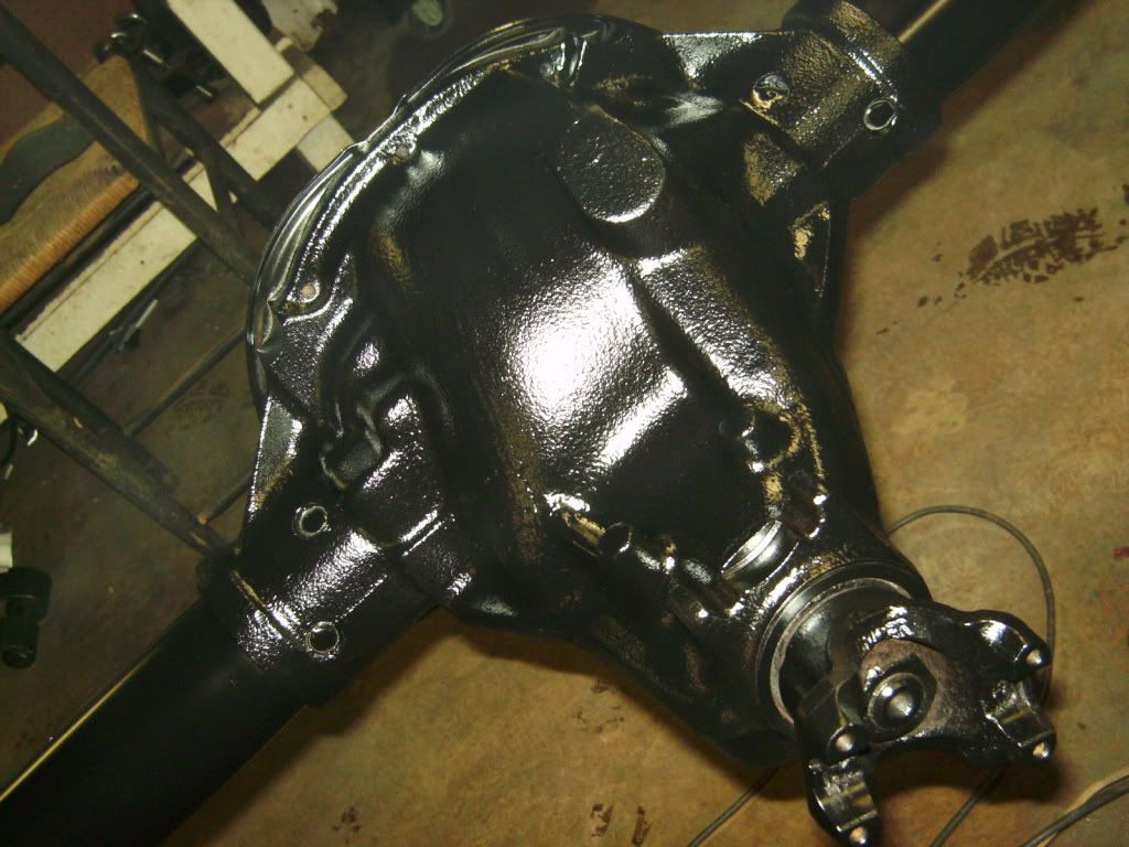

Painted up:

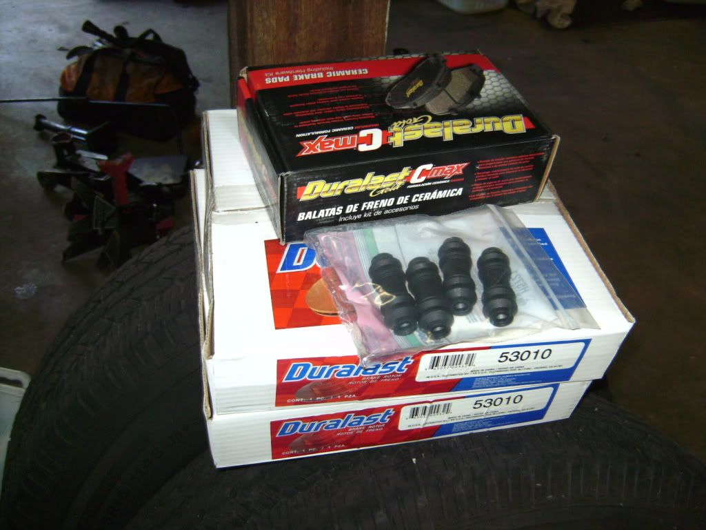

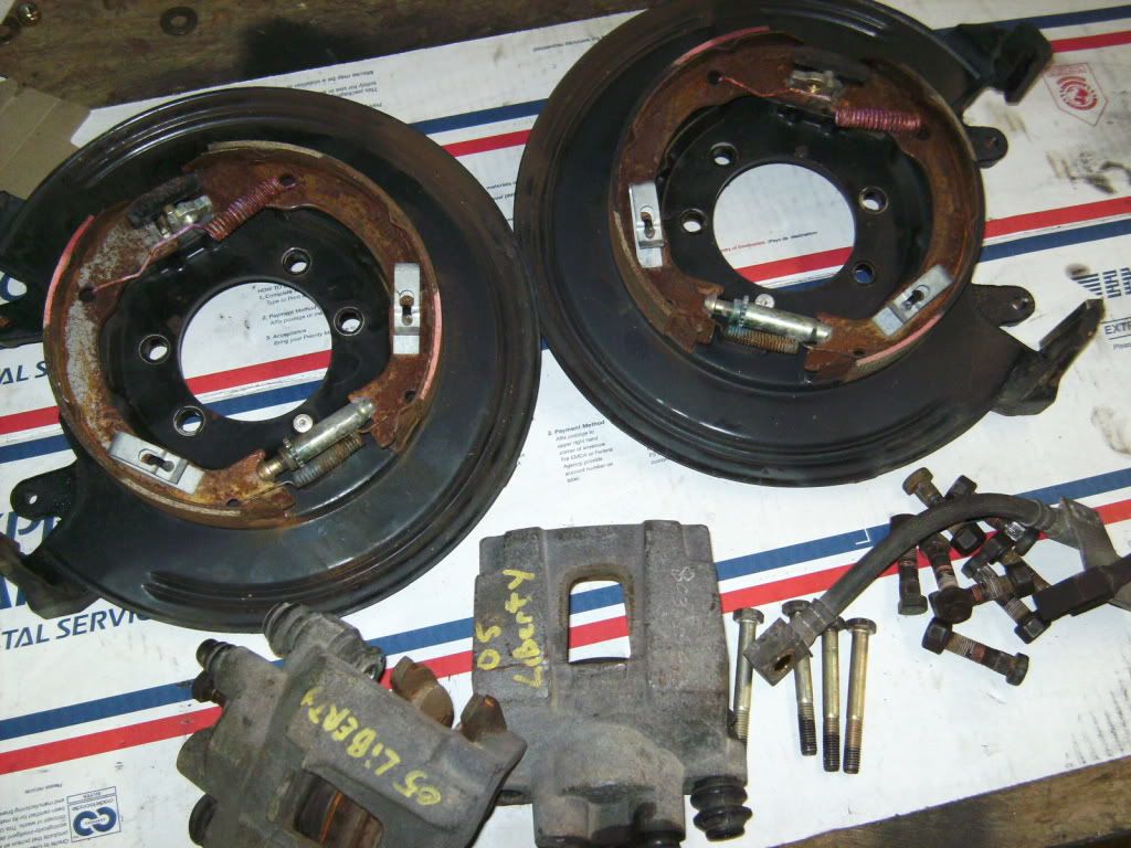

Monday I headed out to the junk yards hoping to find some ZJ rear brakes, but after 2 yards no luck. I went to the third yard and scored better than I expected. I found a set off an '05 KJ with 49K. The backing plates, calipers and the assorted nuts and bolts - $85. KJ's came with an 8.25 from the factory so no grinding out the centers of the mounting brackets. Just bolt them on. I had read about using the KJ brakes here:
http://www.jeepforum.com/forum/f11/f...5-axle-750112/
Ceramic brake pads, new rotors and some hardware from the 'Zone' $115.

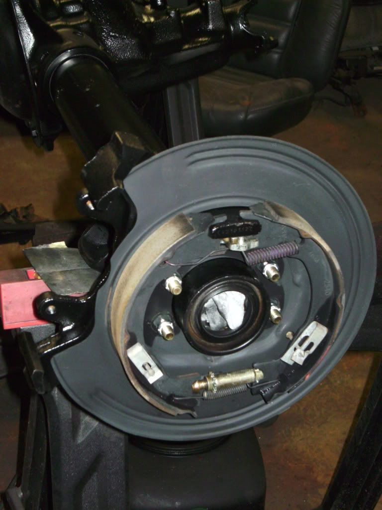

Parking brake assembled on one side. I picked up the longer mounting studs for the backing plate/caliper bracket, but they were a PITA to reinstall so I drilled the holes a little larger and used 3/8 grade 8 bolts with nylox nuts.
The install is surprisingly simple, the only real obstacle will be installing the soft lines.

Wow! Looking very good. What is your process for cleaning the axles?
Jeepless...
'06 Tundra DC TRD 4wd
'03 VW Jetta TDI - Commuter
woodkrawler is offline
post #134 of 557 Old 11-17-2009, 03:50 PM Thread Starter
kabowabo
1988 MJ Comanche
Posts: 424
A cup style wire brush on a 4 1/2" grinder (Craftsman 2-3/4 in. Wire Cup Brush) I'd do it outside, it makes a mess.
