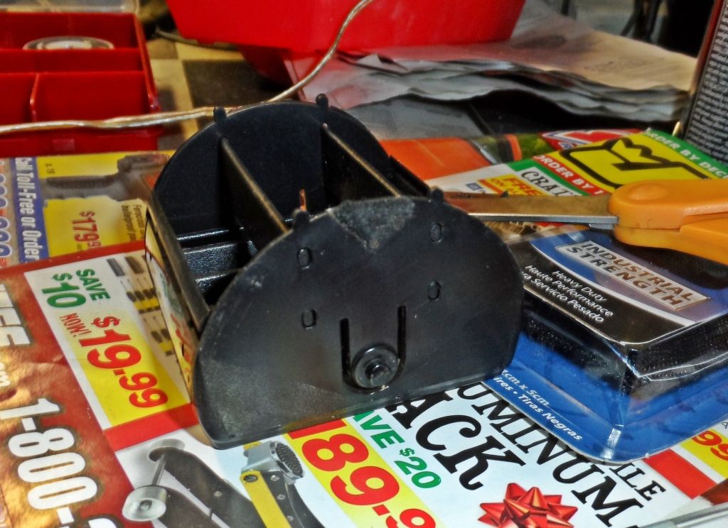

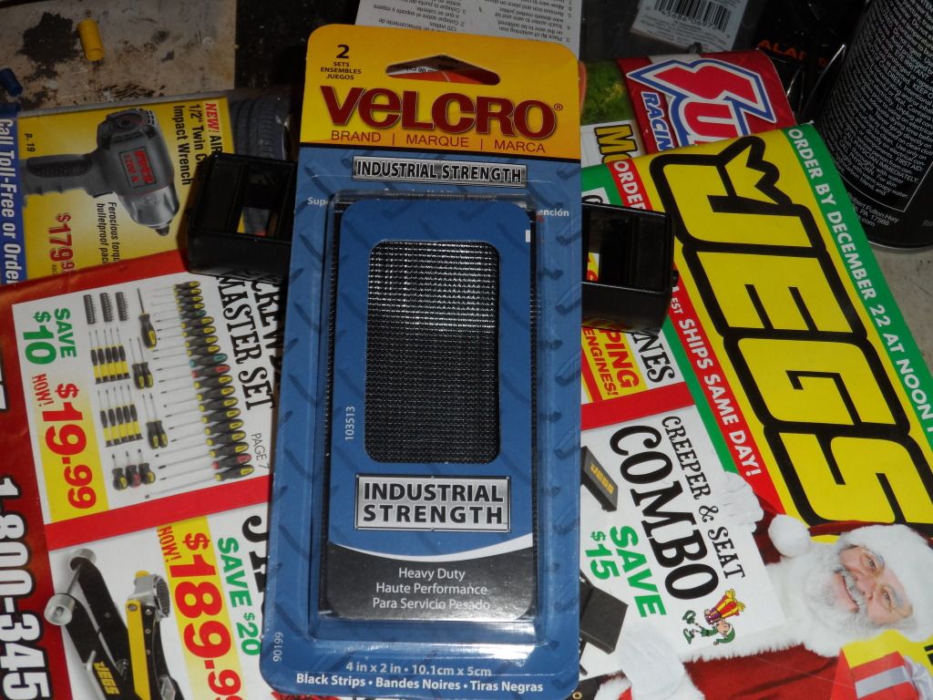

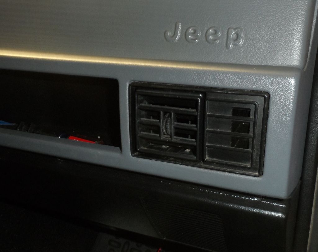

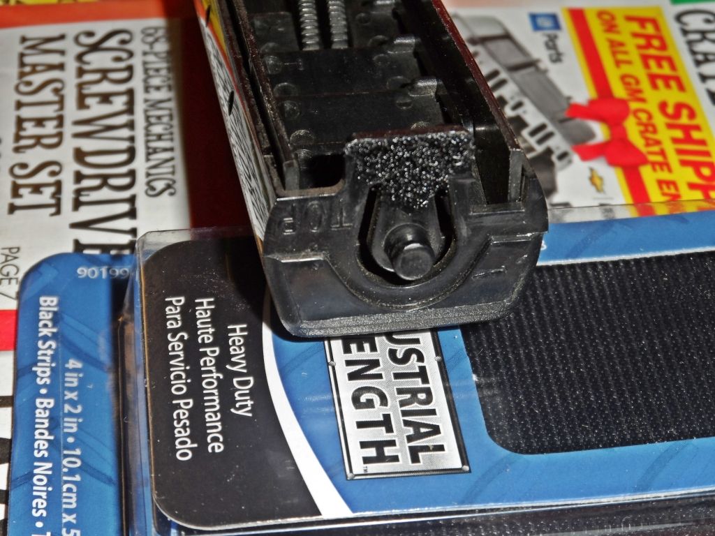

I got tired of looking at the center vent pointed at the floor, so after installing my head unit I pulled all of them out. This piece of felt and one on the opposite side are all that hold the vent in position and deteriorate after time.
Not felt tape, but the loop side of some HD Velcro is pretty close. $2 at Home Depot.
Old felt tape cleaned away...
and same size Velcro piece in it's place.
and no more floppy vents.
Vents now work as designed. Quick and cheap.

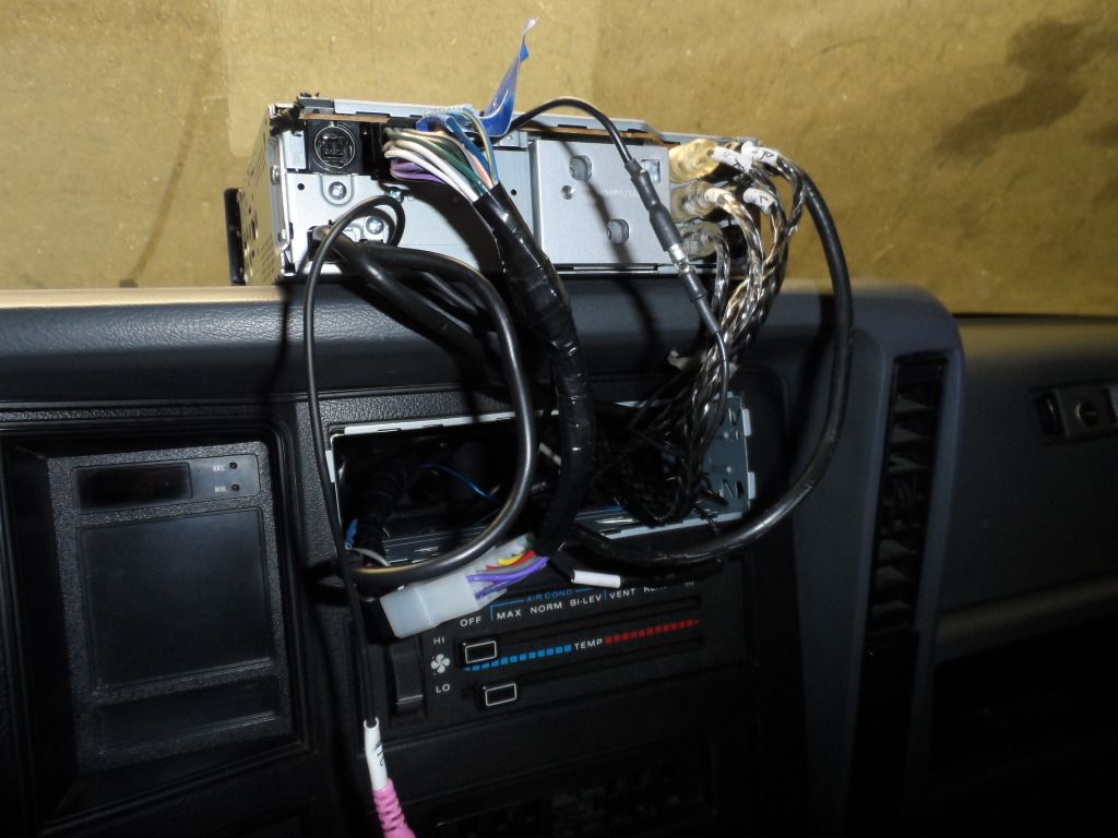

Head unit installed.
Done.
Needs adjustment, but the battery is about dead. Done with it for today.
