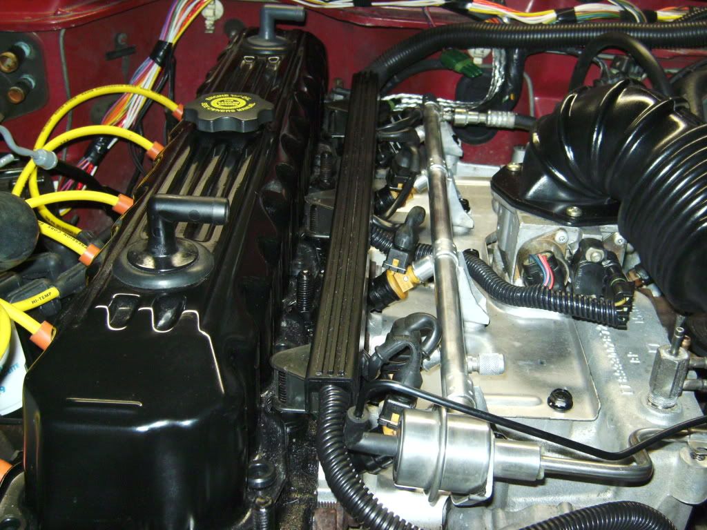

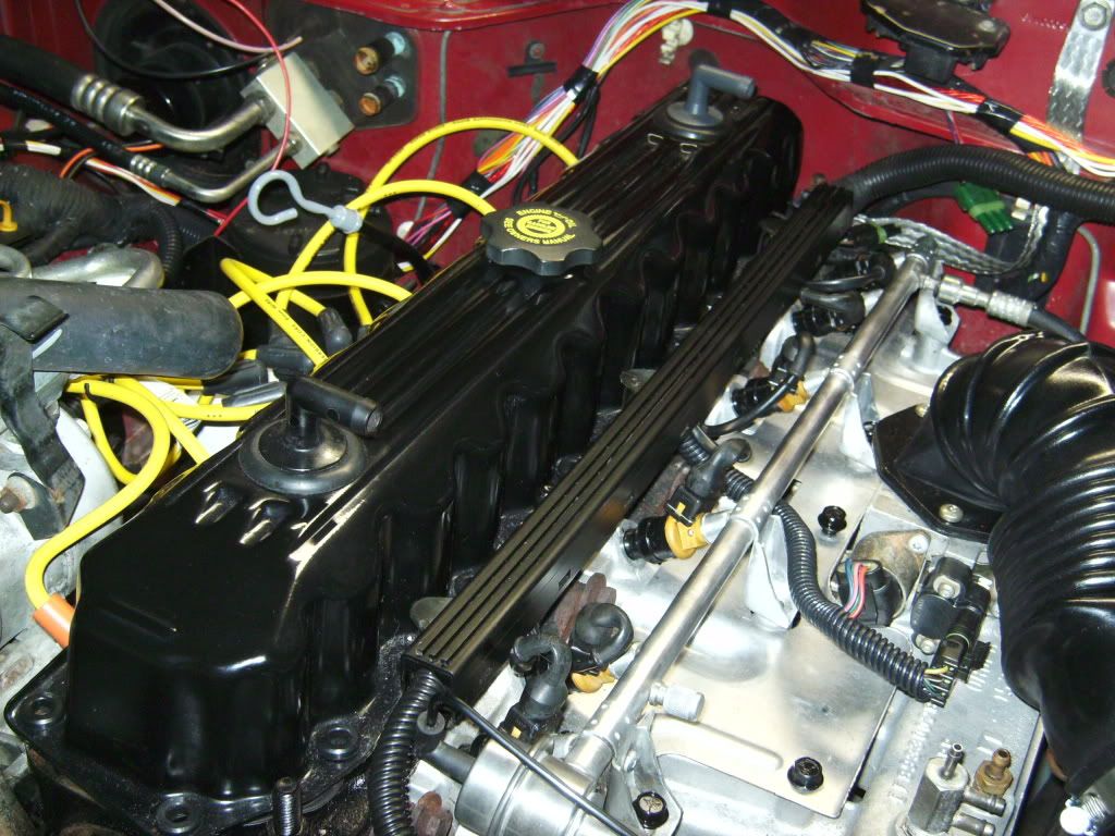

97+ Valve cover test fit...
The old cover had a small leak at the rear corner. This should take care of all but the last leak at the filter housing and upgrade the PCV system as well...
Ford injectors, the old #1 injector was leaking...
Taylor engine to firewall ground strap...
Installed...

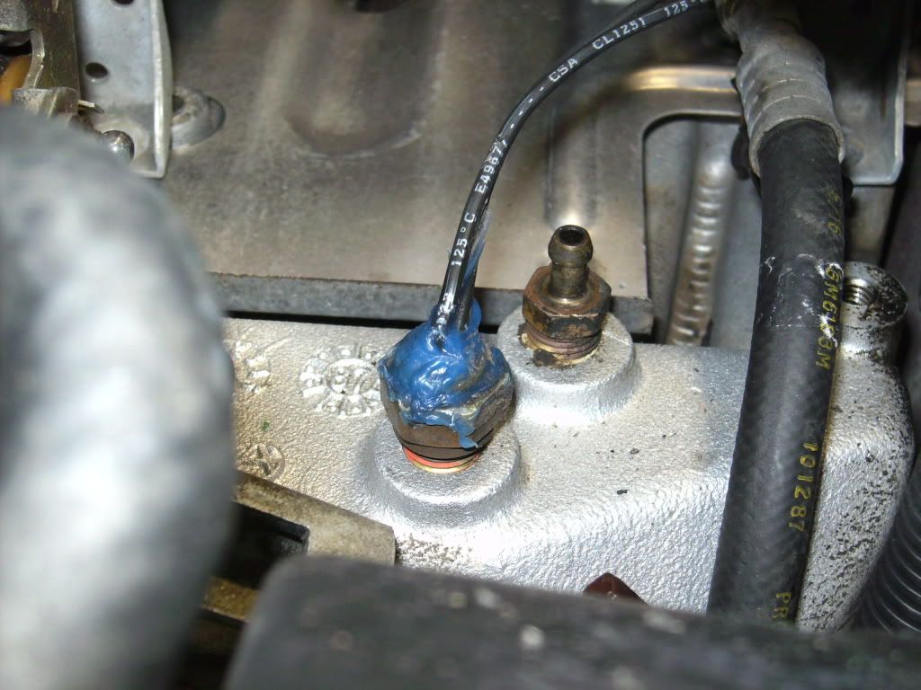

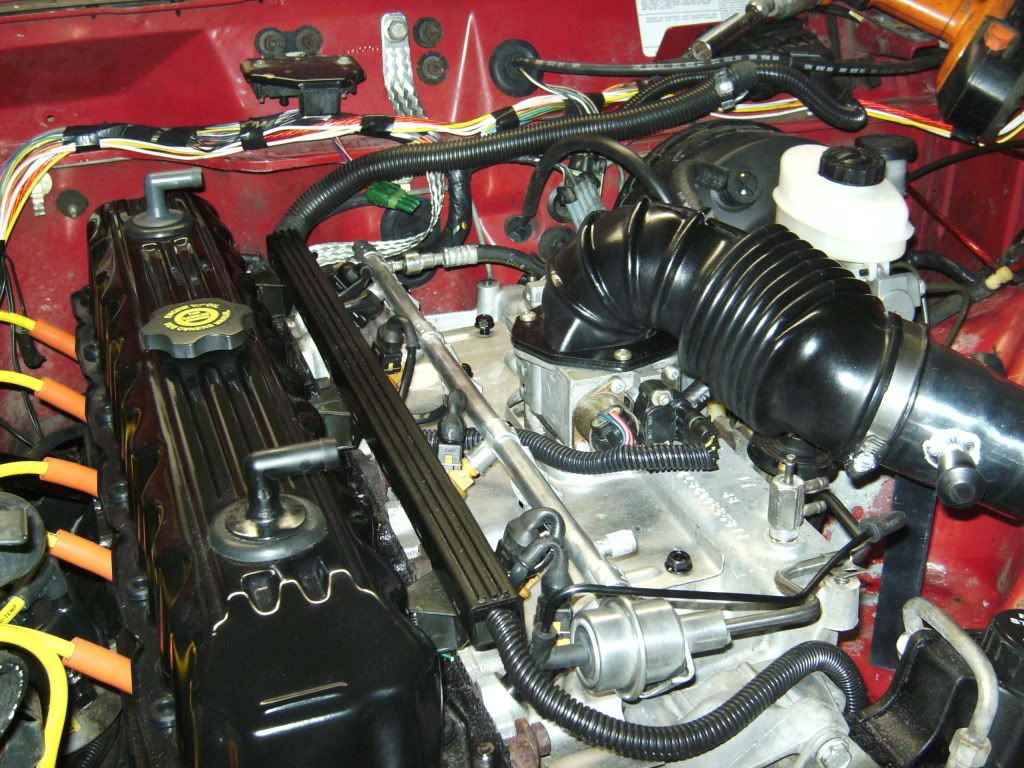

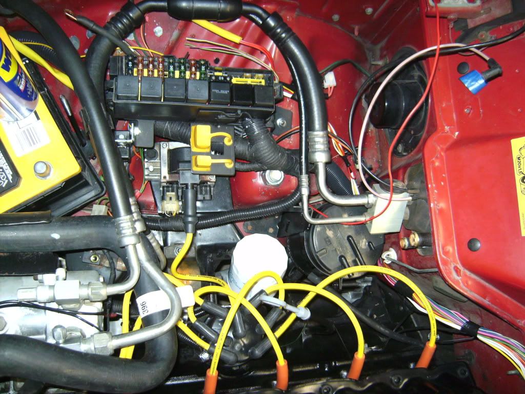

A little gift from the PO...
Ford injectors and fuel rail installed...
Also used an HO injector harness to replace the flex conduit...
Still need to do the vacuum lines...
I'm about 90% done on the lighting and underhood wiring as of now. Still need to redo the cooling system and few more details under the hood to finish up. Then back the the headliner...

Fantastic work. I really like how much care you are putting into the under hood wiring harness. The adaptation of the ZJ PDC is a great idea. You should never have to pull your hair out searching for a blown fuse link now.

was the 97+ valve cover a direct bolt on? i would like to use one for the better gasket next time i do it.

Thanks, and I hope you are right. The leaking clutch master cylinder and the PO pretty much wrecked the electrical system, hopefully this is the last of it.
great wiring work. that stuff scares me.
It's a direct bolt on. I've read you can use the new style gasket on the older valve covers as well.
cool thanks. i guess ill try the new gasket and pick up a newer style cover just in case.

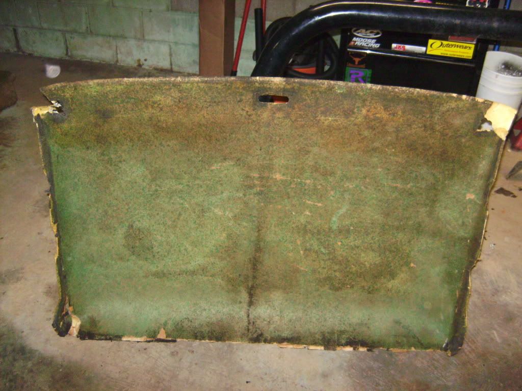

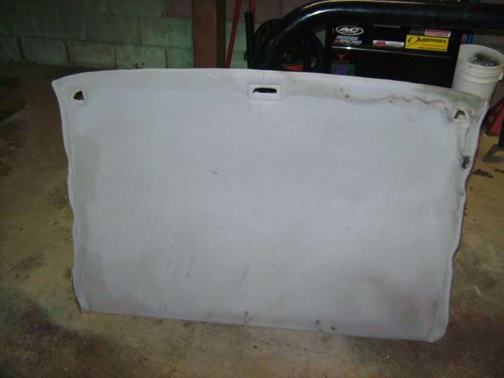

$20 headliner

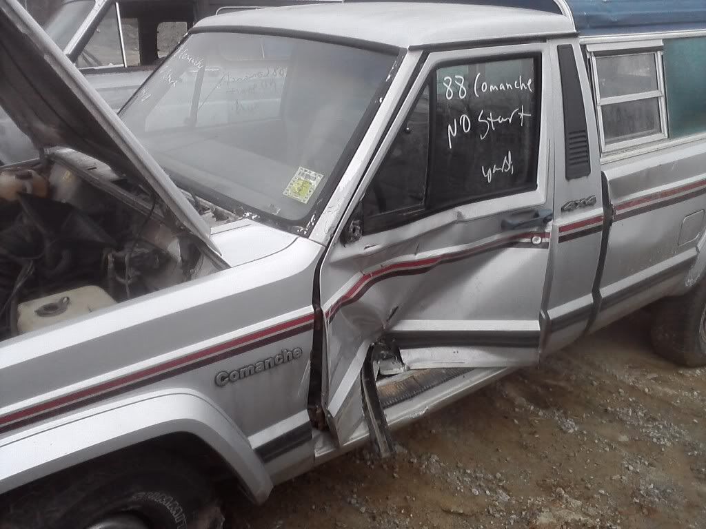

Since my old headliner was ruined, I had to start from scratch. I found this guy that "remolded" (his word) the backer boards and then covered them in any color fabric you want. $100 shipped. Fair enough I thought that will save me some time and when I get it I'll just toss it in. While it looked good out of the box, and I followed his directions for installation it now resides at the dump. Poor fitment, misaligned holes blah blah blah. So I posted a WTB in a local forum to find an old factory backer, this is the first $20 backer...
My son picked it up for me, and it is even uglier in person. It's unusable without major work and there is a least an inch and a half missing off the bottom edge. I went to the pull a part on the other side of town to pick up some nuts and bolts and scrounge around. Seems they had just gotten an '88 long box in that had been hit in the drivers door.
The headliner was in great shape just dirty. So here's the second $20 headliner...
I'm going to pick up some fabric and glue this weekend, and hopefully this will be the end of the headliner ordeal.

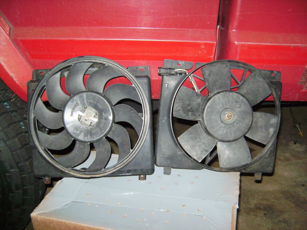

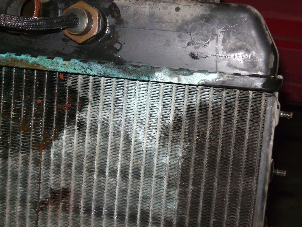

I yanked the radiator and remaining hoses tonight. I also flushed the block and heater core. The stock radiator is toast, no big surprise...
Water pump and lower radiator hose are both OE and will be replaced. Upgrades will include T-stat and late model electric fan.
