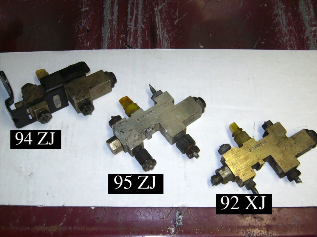

I agree with you. I ditched the original line for the rear brakes and I'm just using the old bypass line. My first thought on a PV was to simply use the old MJ splitter, and block off the bypass port. There are a lot of opinions on this, but I really like the idea of a working PV.
My first choice was an XJ PV, I installed one from a '92 and couldn't get any pressure to the rear brakes.
I pulled the PV apart, and the black cup/o-ring had come apart and was apparently blocking pressure to the rear wheels. I reassembled the PV without the cup and I had pressure to the rear wheels. The thing is without the cup in place the PV functions basically as a splitter. Not what I wanted. I found this article ZJ Proportioning Valve and I picked up a ZJ PV from a 95 with 4 wheel discs. The article explains the needed minor mods. The end result...

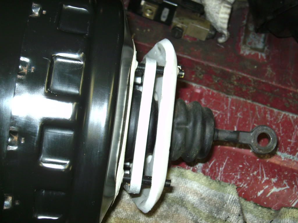

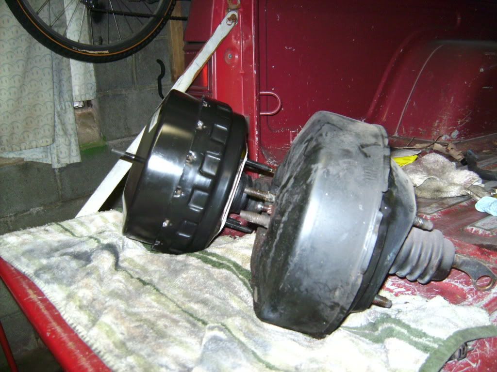

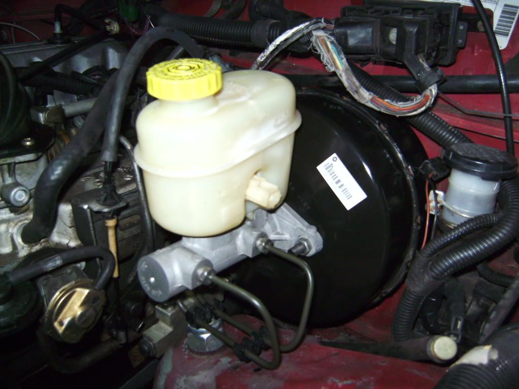

Some progress today, I pulled the old booster and master cylinder last night. The new WJ booster and the old MJ one...

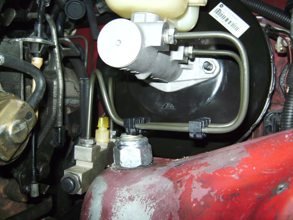

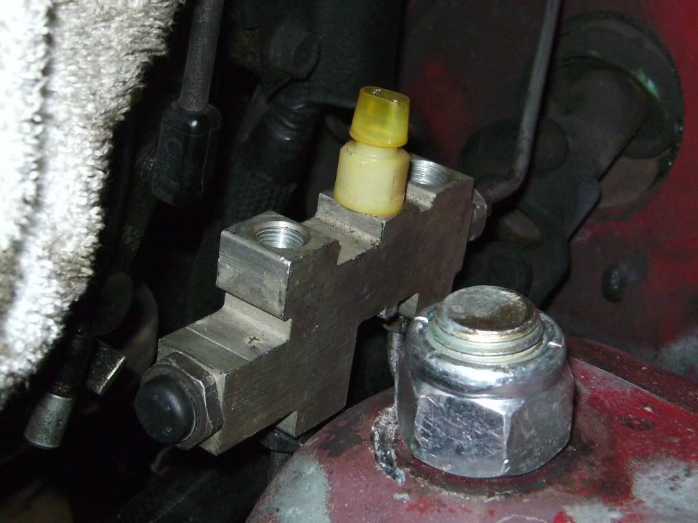

Today I installed the PV ...
New booster with spacer and gaskets...
Booster and M/C installed...
The new hard lines, showing off my less than stellar tube bending skills.

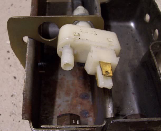

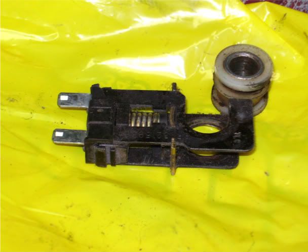

Pretty straight forward stuff. I didn't modifiy the booster rod the way some of the write-ups describe...XJ Cherokee Conversion to WJ Front Brakes & Steering...Instead of going back with the old style brake light switch...
I picked up a Renix are cruise control bracket, and I'm going to run a latter model switch. It'll look like this...
