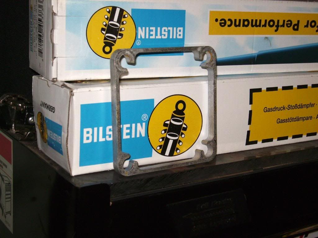

The load sensing valve is next on the list along with the '99 WJ master cylinder and booster. If anyone plans on using this mc/booster combo you'll need one of this spacers for proper pedal height.
You can pull one from a '95 or '96 XJ.
Lookin' good
I was unaware of the need for the spacer? Please enlighten me. I'm using the MC and booster from my '99 XJ. I just bolted it in place of the MJ unit and the pedal location seems to be normal? Maybe it's because I'm using the XJ pedal hanger and dash brackets as well?

Originally Posted by woodkrawler View Post
Lookin' good
The pedal hanger etc. must make the difference, without it I believe the '97+ booster push rod is too long. With a stock config. like mine, the spacer is used to run a dual diaphram booster, either from a 95-96 XJ or the WJ, and maintain the stock pedal height.
That makes sense.
