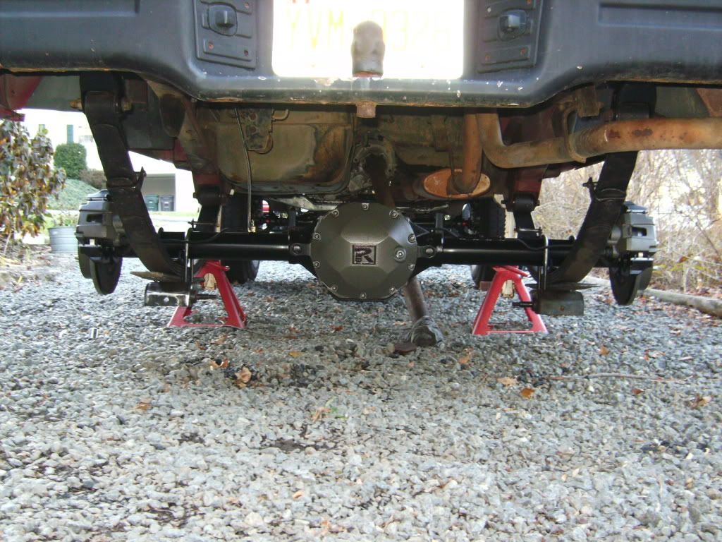

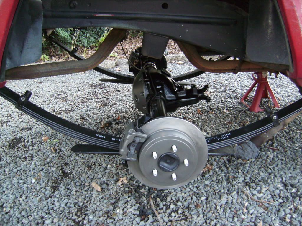

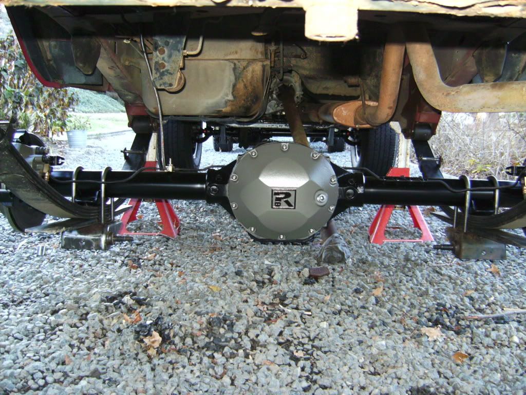

I spent today putting in rear diff, other than the cold it went pretty good. I intended to pressure wash the wheel wells and the underside of the bed etc., but 35 degrees and water don't go well together. I did the wheel wells and revised my build plans. The new plan is to get the Jeep back together enough to drive it into the basement then finish up the rear in there and out of the weather.
Before...
After...

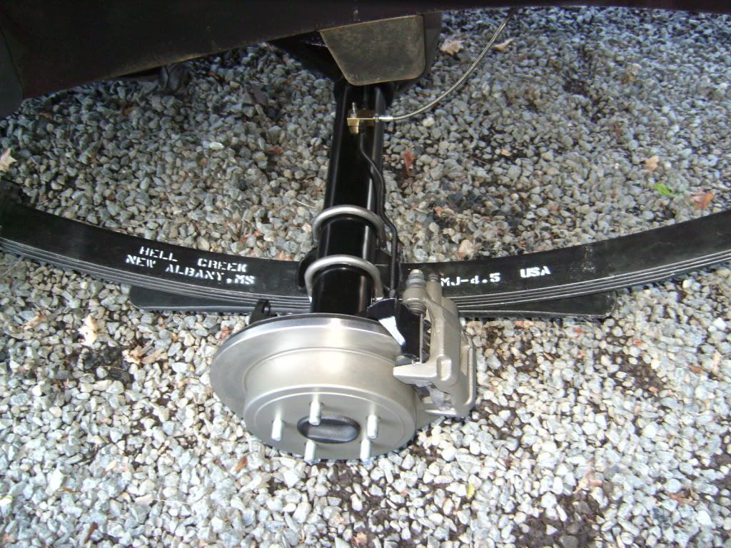

Posts: 424

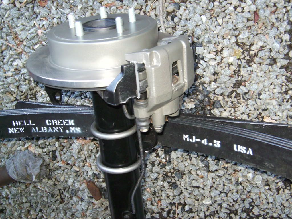

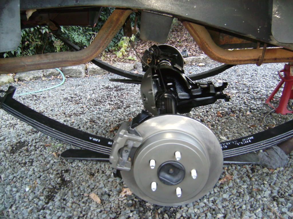

A few more pics. The Hell Creek springs both sides...
from the side...
Rear view, no shocks yet...

Very nice...! I love the Riddler diff cover. It looks great under there.

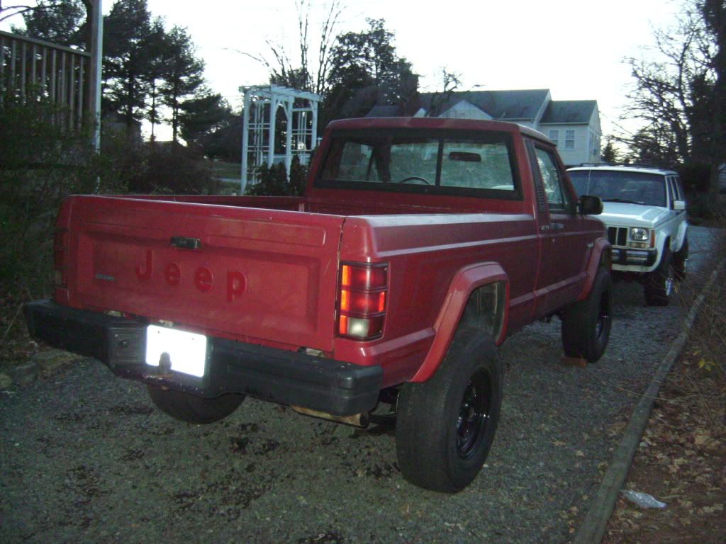

I spent today buttoning up stuff on the MJ so I can move it inside. I got the tires and wheels on and got a chance to take a look at the stance. It sits a little higher in the back, but it's a truck.
The 32's are looking kinda small...
