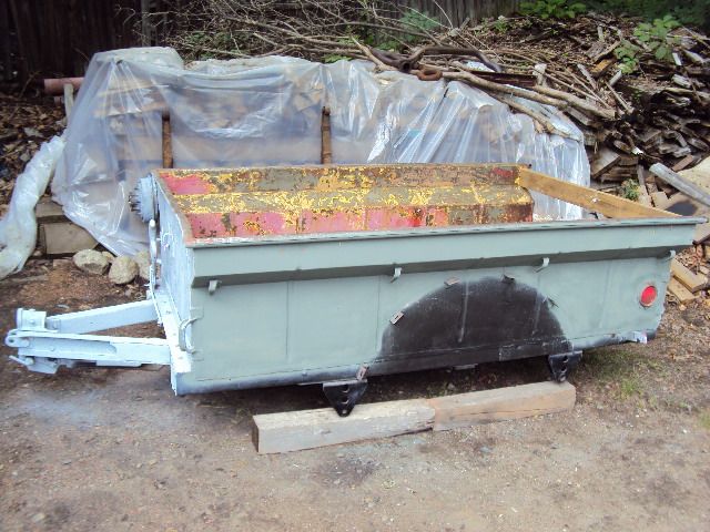

Other than that, my only other news on the Jeep is that I bought a '52 Dunbar M100 trailer that I'm resto-modding with my father. Should be a fun little project. I need to replace a bunch of the suspension components, and will be re-welding the hacked tailgate mod. But the frame and rest of the tub are pretty solid, and it should be a great little rig to use around town and eventually use as an expedition trailer (hard tonneau and RTT). Teardown is completed, and now it's just figuring out the plan moving forward. It's going to be painted to match (Sahara Tan), with a black frame, tongue and wheels and bedlined interior.
Day I brought it home:
Current condition:

I wish I could take credit for the progress, but while I've been traveling lately and haven't been able to make a trip up to the trailer, my father has been very, very busy. We still need to weld in the tailgate and replace some of the suspension components, but the frame and tub are coming along well.

Not a lot of money in the Jeep budget right now, but it was a nice day today working on the trailer.
After looking at the poor job the PO did cutting out the back of the tub to make a tailgate, I realized it would be all but impossible to weld it back in. And since I didn't really want to spend $100 on a replacement panel, I decided to use some 1 1/2" x 1 1/2" x 1/8" angle and 1/8" x 3" and 2" bar stock to tie the corners back together. After some careful measuring and cuts with a nice metal blade on the miter saw, some careful drilling and getting things lined up, the repair came together. It will still need to come apart to get prep and paint, but it's nice to see the tub whole again. And I like how it looks. The back of the tub is stout, and it should serve me well.
So while it still needs paint and I need to wire up some lights, I put it behind my JKU and took a spin around the block. I could barely tell it was behind the Jeep, the pintle and NDTs were quieter than expected and it looks great. The hitch looks a little low, with about a 3" rake to the front, but the springs are new, so I'm guessing after some use it will drop a bit and look a little better. The other thing that worked out well was the extra 4" I added to the lunette when I had it repaired allows the tailgate to open completely with the trailer hooked up. This will make access for gear (and the dog) much easier.
I'm hoping to get my Sahara Tan paint this week. Then it's just a matter of painting the tub, getting final coats on the chassis/tongue, wheels and fenders, wiring up the lights and getting a license plate mounted up. I'm very happy with how things have come together. And my father's help in prepping the tub has made a huge difference in getting this done as quickly as it has with everything else I have going on.
