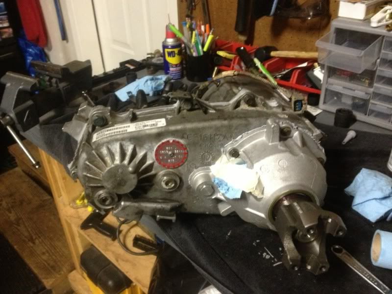

The hack n tap kit is a very good option. I beat the hell out of my Rubicon Express Hackntap. No issues really, however I decided to JB weld the flange to the shaft, because there was a wobble I wasn't happy with. I think it was my own fault because I did not shim the axle properly, so it still vibed. That sounds ghetto, but it worked really well. (I had no money at the time, and I was just starting college haha)
I ended up scoring a Tcase from my buddy Mark (sharkxj) on naxja, it had 60k miles, and I was going to put a PORC HD sye into it.
Either way, you'll really enjoy having the same output shaft as the HD unit, (and yes that is the same output as the IRO kit), because you can then use the front and rear shafts interchangeably. If you pretzel the rear shaft on the trail, you can limp home by putting the front shaft in the back.

Okay, well I can speak with certainty that my front DS, fits in the back too. I've swapped them both out front to rear and vice versa, because I was trying to fix vibrations. The tom woods shaft is slightly shorter than the rear shaft, but they both work. (Tom woods is now in back, jeep shaft is in front. The TW is shorter, but does fit with no issues.
The "HD" refers to two things.
1) A non hack n tap flange on the transfer case... a Bolt on yoke that fits onto a heavy duty, shorter main tcase shaft.
2) A heavy duty drive shaft. The stock xj shaft has maybe 3 inches of splines, and a small machined shaft sliding assembly. The tom woods shaft has full length splines, and an overall thicker construction.
