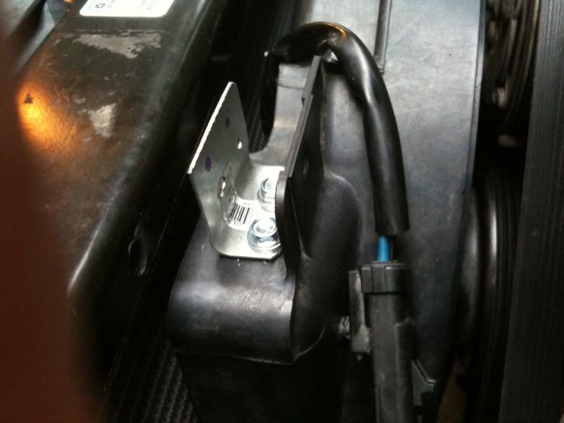

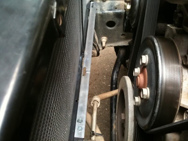

I decided to make a dual e fan set up, for more efficiency.
I used some 5/16-24 bolts for the fan pulley. It clears with about 1/4- 3/8ths of an inch.
I then used a piece of angle aluminum, slotted for the fan tabs, and screwed into the old radiator mount.
It uses the right most (passenger) side fan tab, and then the other side for structure.
I then used a piece of steel, normally used to tie wood pieces together, to hold the top on.
I had to remove the top radiator support (PITA without removing the front clip), in order to drill the bracket.
I work on Mopars

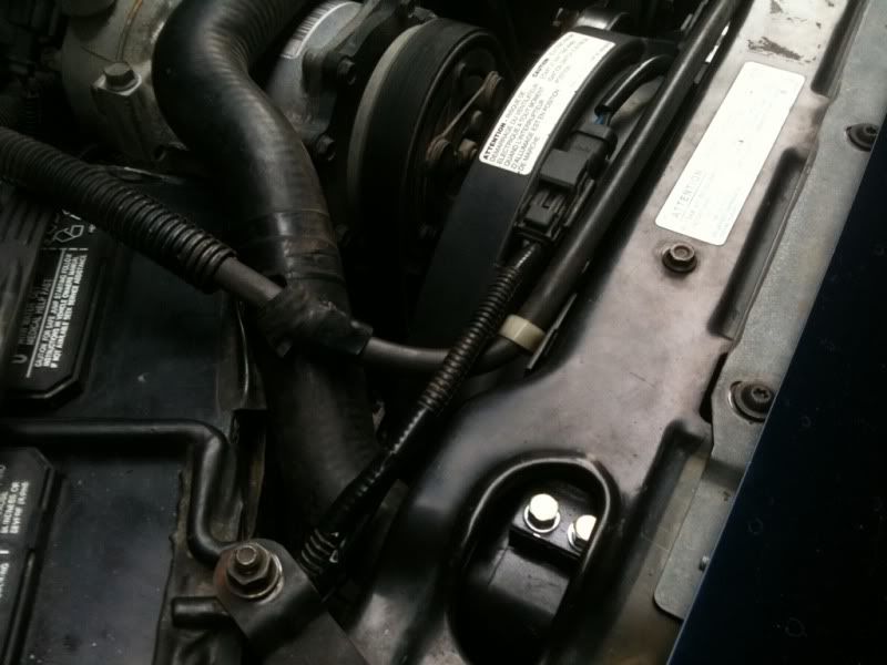

To finish-
I went to Oreilly's and stumbled upon a Hayden fan controller, part #3657.
It uses a probe that is stuck into the fins on the radiator. I like this, because I didn't have to do any plumbing, so it's more reliable. I really didn't expect it to be in stock, but there it was.
It is also adjustable, from 90-210 degrees. It has a little dial that can be turned.
All for $35 out the door. Not bad.
Right now, the fan kicks on below 210, runs for about 20 seconds, and turns off. It doesn't run hardly at all when there is decent airflow in the radiator.

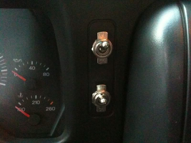

I also wired it to a switch, so now I have 2 separate fan switches, as a fail safe.
The controller.
My favorite part- I used the factory pigtail from the junkyard jeep, and wired it to the controller. I also drilled the shroud so I could use the factory harness clip.
And my 2 switches.
It works well, but the controller is wired to the battery. This mean that the fan can kick on even when the key isn't in. I will fix this soon, by wiring to an ignition (on) source.

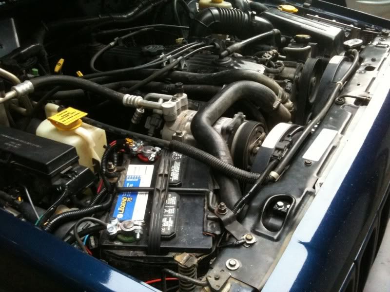

Haha thanks man. I was moving some stuff today, I parked the jeep in our driveway. The fan kicked on about 2 times for 15 seconds each, within a 2 minute period, then I think it was done.
I'm obsessed with clean work man. Some of the wiring isn't perfect, but I can fix it later. I'm picky about using conduit! Exposed wires are at risk of abrasion, and it just looks hack.
I clean the engine bay after every wheeling trip, and I rinse it often.
