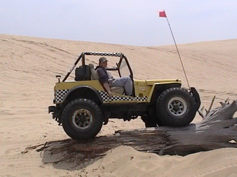

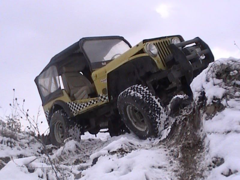

do you have any body lift. Here is mine with the wore out 36's that messure about 34 1/2 now. I have 5" of suspension lift and they rub a little in extreeme flex or with pssangesrs in the back.

^^ Aside from the paintjob that thing is sexay!

Soon to be repainted just yellow with black wheels , black cage and bumpers. The checker was just an Idea 4 years ago when i built it.
