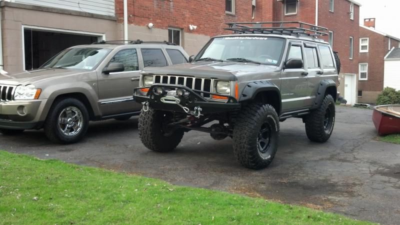

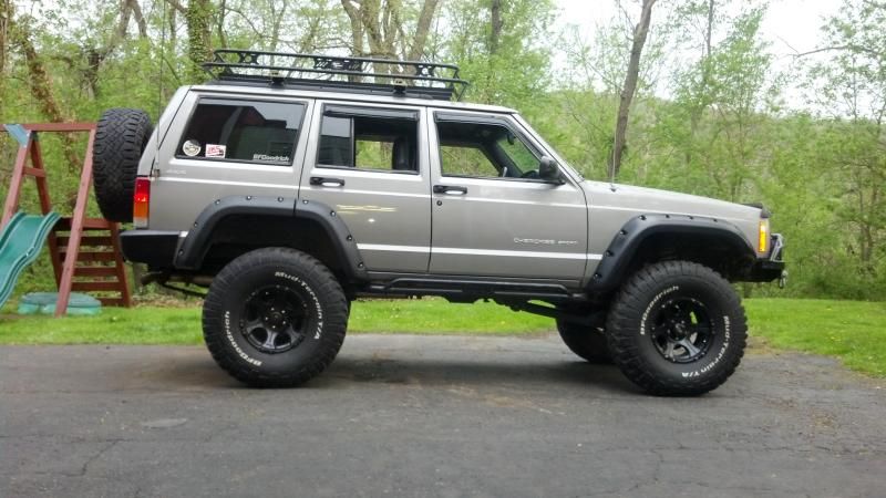

Man ive totally forgotten about this thread! Progress hasn't been much. Been putting a lot of $ into my house so the jeep hasn't been a priority. Its now on 35" km2s. Also added some new lights andAlso a lot of mechanical stuff... starter, radiator, u joints, crap like that. Nothing fun. Not sure how much longer I'm gonna keep it so I really don't wanna throw any $$ at it.
Anyway here's some pics...

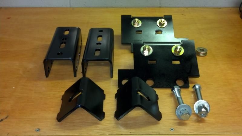

Today's project is HD offroad shackle relocator brackets. I'm sitting a little low in the rear so these will give me a little lift and improve ride and flex. I've been needing to do this for a while. Right now I'm still running the original RE 4.5 leaves with 5.5" springs in the front. We'll see how it goes...
2012 JKU Altitude Edition... under construction!
2005 WK limited... The wifes.
jeepin ruby is offline
post #135 of 151 Old 05-09-2014, 06:17 PM Thread Starter
jeepin ruby
Location: elizabeth PA
Posts: 344

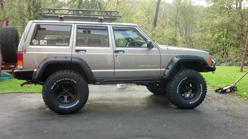

Okey got the shaclke relocators on. Install wasn't toooo bad. Had to do some trimming of one of the brackets to get it to fit in the shackle box and getting the hitch back on was a PINA, had to buy longer bolts and my nut serts in the "frame" were just a tad rusty
Netted me 2.5"of lift which was a tad more than iI wanted but that's okey. I'm gonna put a 1" spacer in the front and I should be able to wheel without ripping my fender flares off!!
Before..
After...
