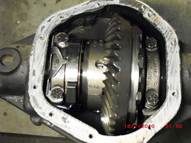

Got some pictures of the Guts.

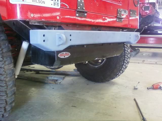

Just fitted the bumper. I have to pick up some Hardware for now.

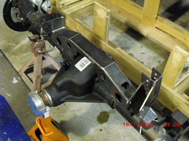

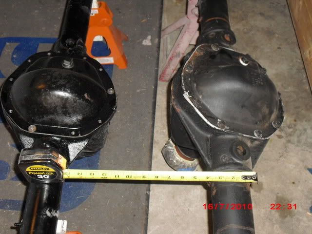

Just thought a small comparison to a D44 would be good. This rear JKD44 is huge.

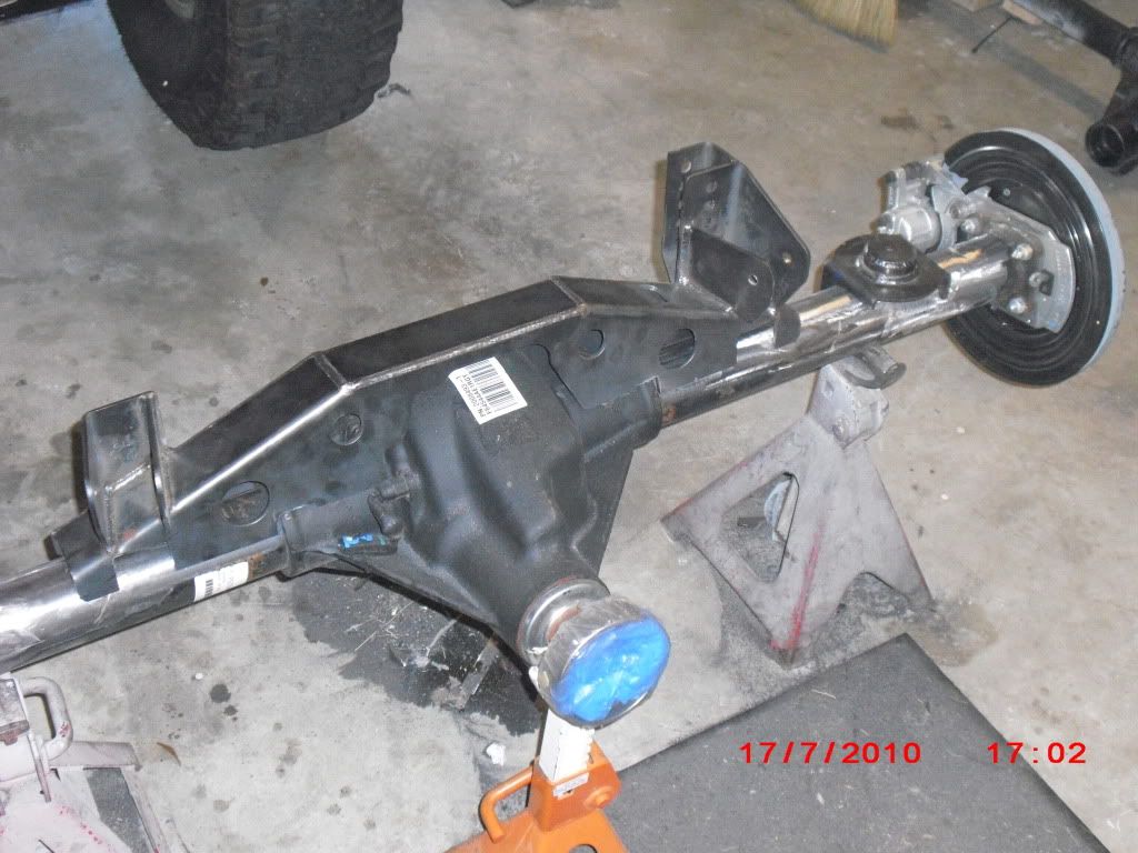

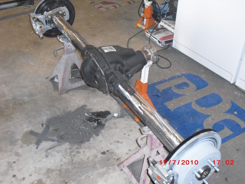

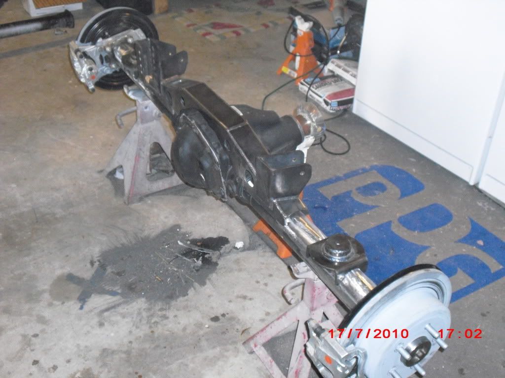

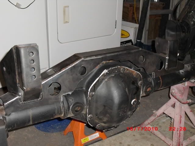

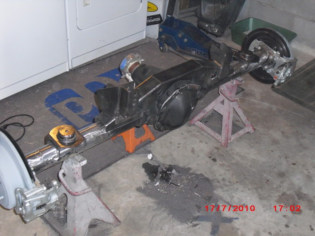

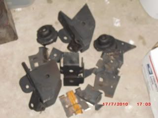

I have this small pile of scrap metal to share today.
I did get alot accomplished today. My ears are ringing badly. But the Rear D44 has Naked tubes. What a pain in the rear. I know why people use axles from leaf spring vehicles. I am not looking forward to the front at all. I would like to just pay someone to trim off the front brackets.
Naked Rear end.
Truss set up and spring buckets ready to weld.
I need to install the diff cover, breather tube and rear brake lines. Then the truss can be welded.

post #838 of 7117 Old 07-17-2010, 04:10 PM
gribbles
Location: Indianapolis
Posts: 1,678
looking good bud

lol yea I get to cut off 2 leaf spring perches and 2 shock mounts...poor me
