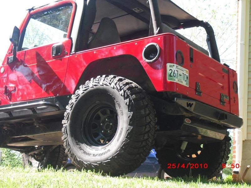

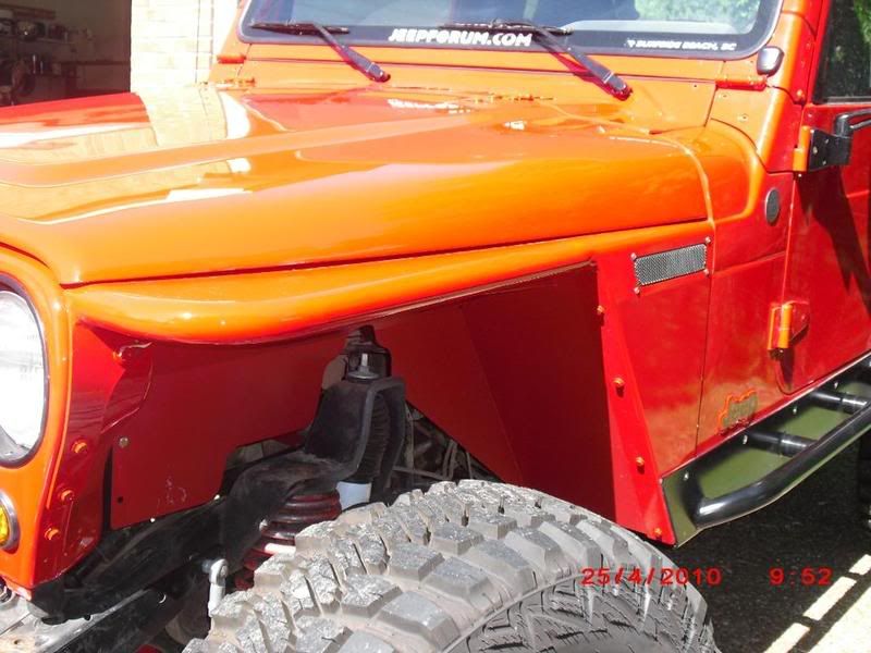

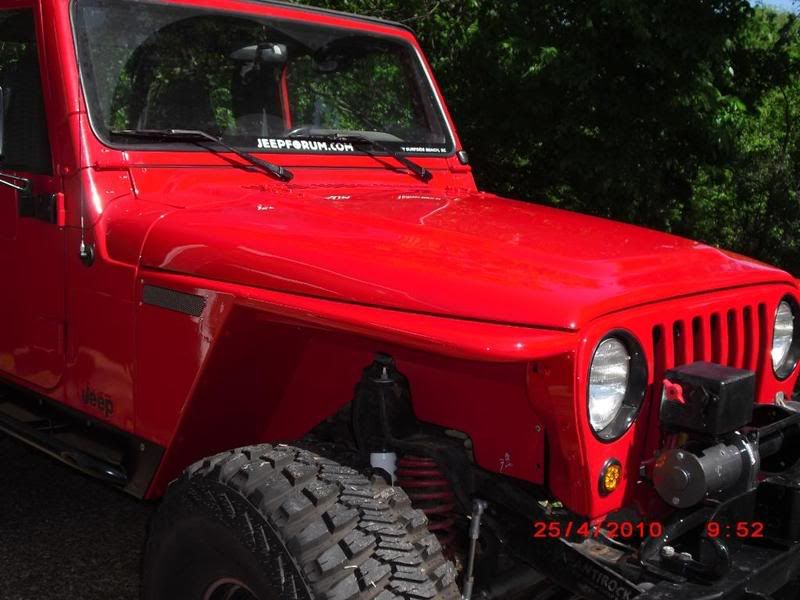

I started with a piece of junk I purchased off Craigslist.
After the complete paint job and 33s

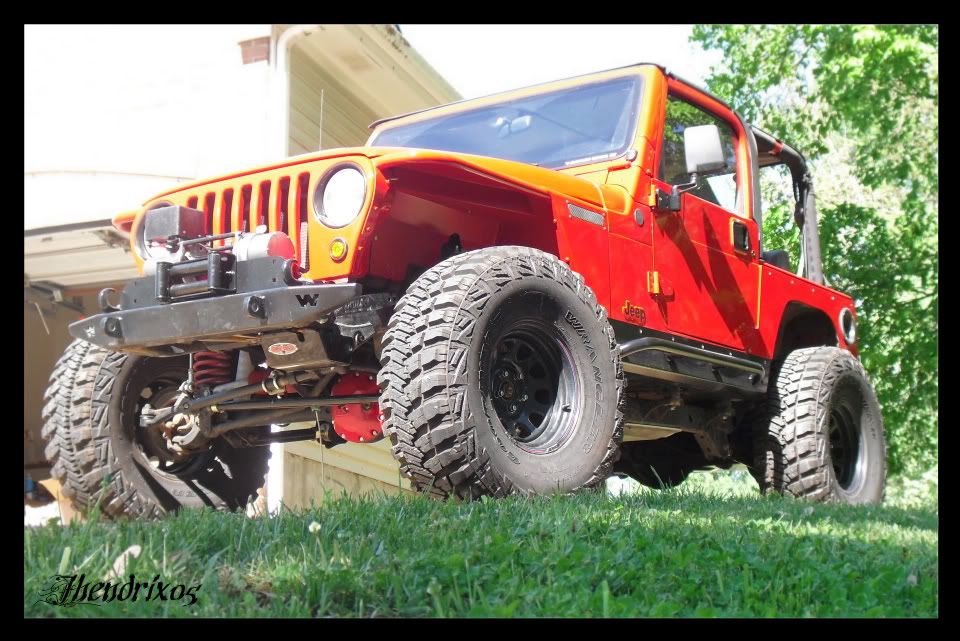

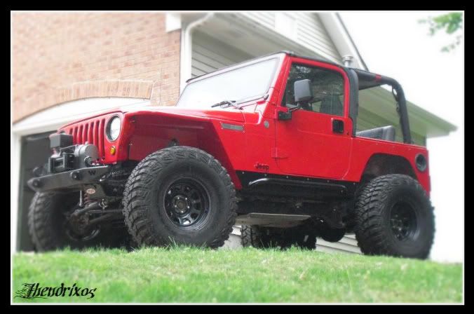

I wanted a solid DD built to drive to and from the trail. I put the Jeep on 33s, then quickly sold them to go to 35s, Just days after I finished the build all but the rear D44 and the HP30. I was hit by a careless driver and flopped the Jeep on its side. Then there was a new plan to build a Jeep on 37s with a 104" WB. The rest in history dumped somewhere in the next 400+ pages.
