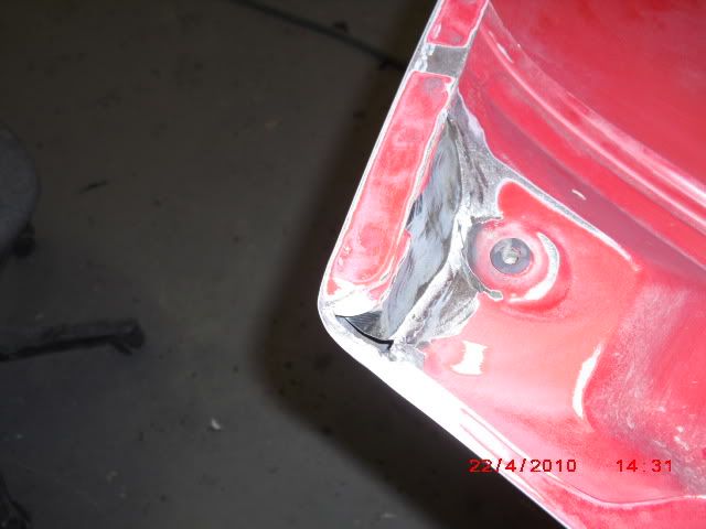

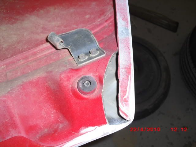

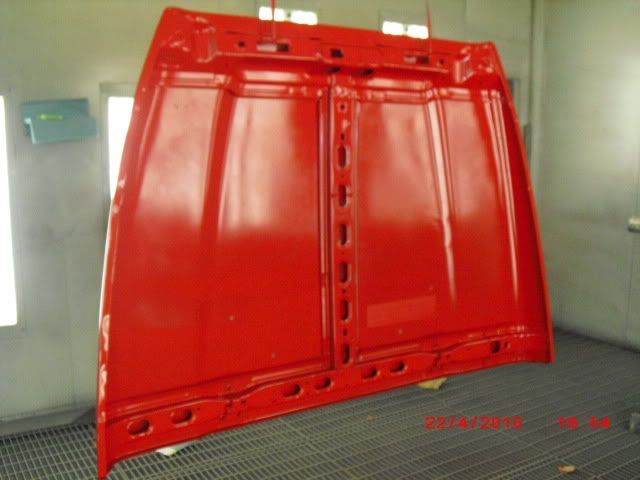

Okay, I guess I will do a little update on the Build.
Items left to do.
Install the rear springs.
Weld JKS mini skids to D30
Adjust all arms and set toe, etc. 94 WB is the target.
Repaint coil springs.
Repaint frame
Spray Hood,Hilines,corners and grille
Install Rokmen Corners
Install flip down tailgate hinges
Install winch line and D-rings
Spray Black bedliner in Tub and inner fenders (SEM)
Finsh Custom tramp stamp

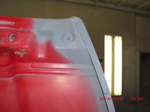

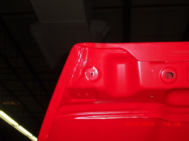

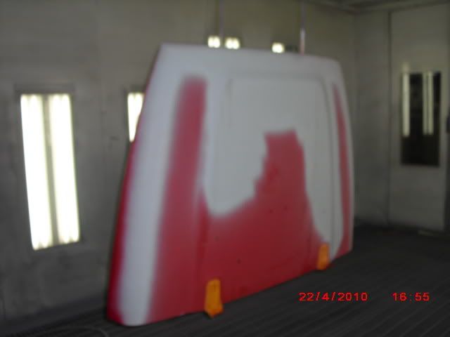

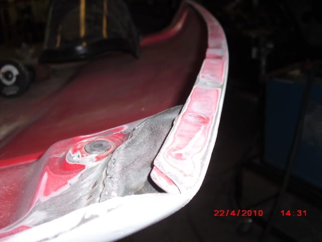

I did get the Hood done today. Primer on the Outside, welded in the cover plates in the front and welded the spot welds in the rear.
I have a Thread started with step by step process on how to do this to your Hood after the Hiline Fender install.

That is awesome. I love it when people take the time to do things right, and bending the edges over is the right thing to do.

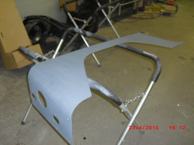

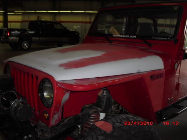

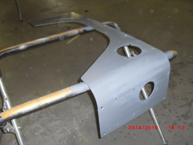

I got a little done today. I cut the new wheel opening in the corners, and primed to paint on Saturday.
Also sanded the hood and fenders for paint on Saturday. Woohoo.

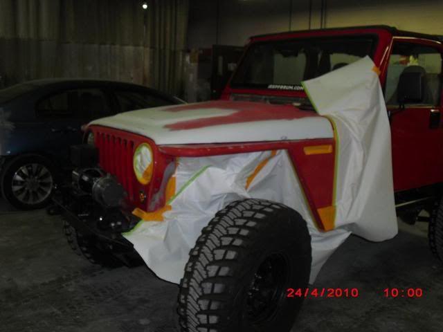

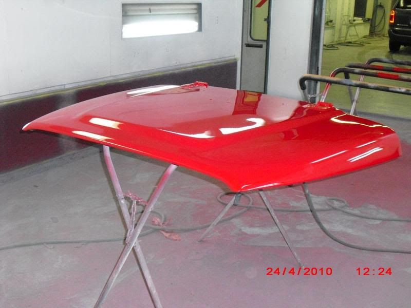

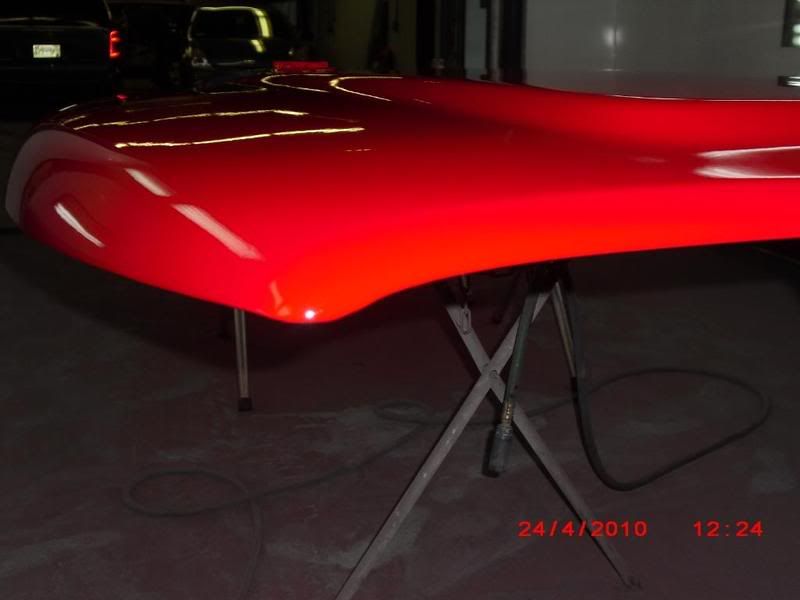

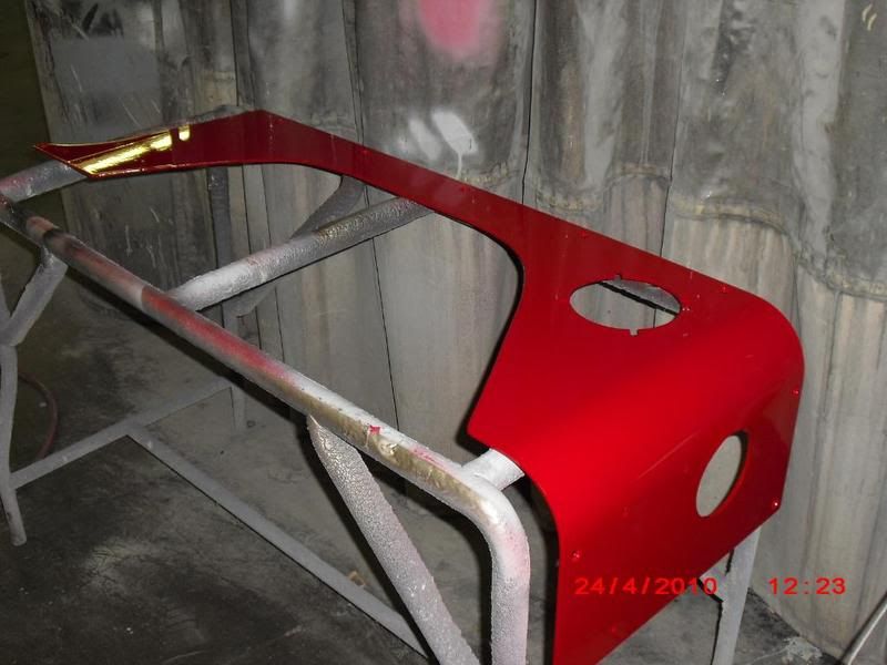

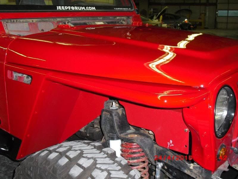

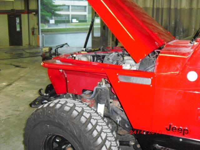

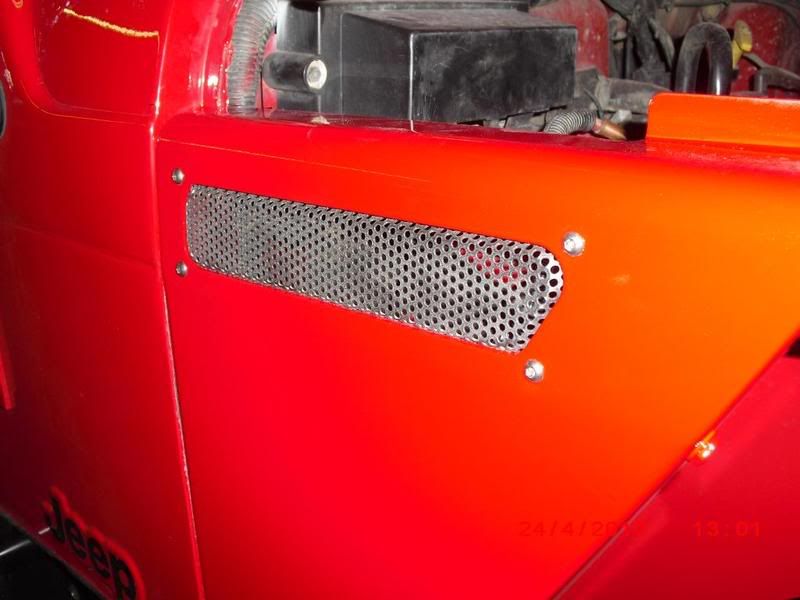

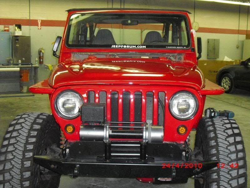

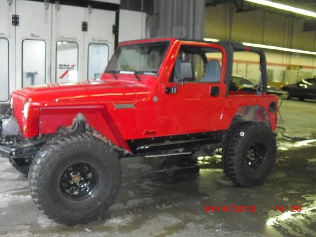

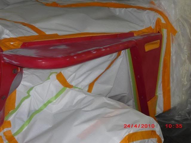

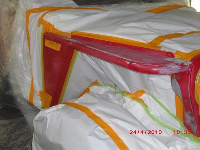

I finally got a Saturday where I could use the Paint booth. I sprayed the Hood, Fenders, and Corners.
I did have time to install the corners today. I have to take some better pictures after I black out the inner fender.
This is not the best picture.

I would either paint the insides of the fenders black, or put some form of barrier there. Personally, I think the barrier is the best bet since it will protect the paint from chips.
