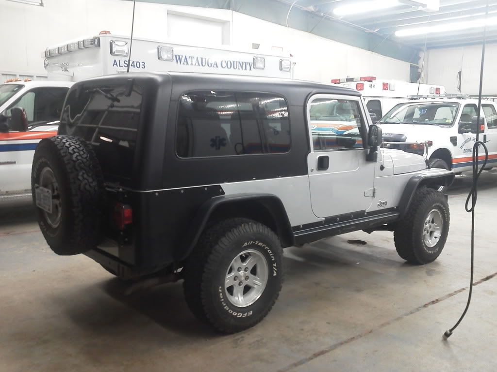

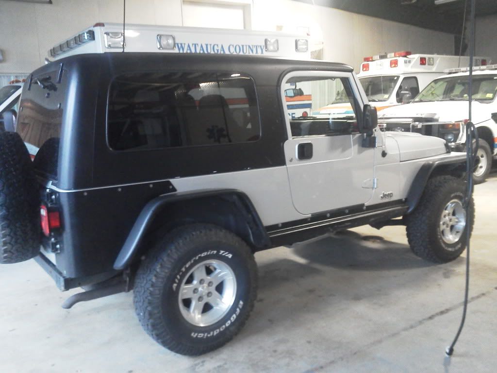

Hardtop crappy cell phone madness:
I used to be that hardcore driving the Jeep with the top off until the first snow kind of guy. But I admit, I enjoyed the nice quiet ride home yesterday with the hardtop.

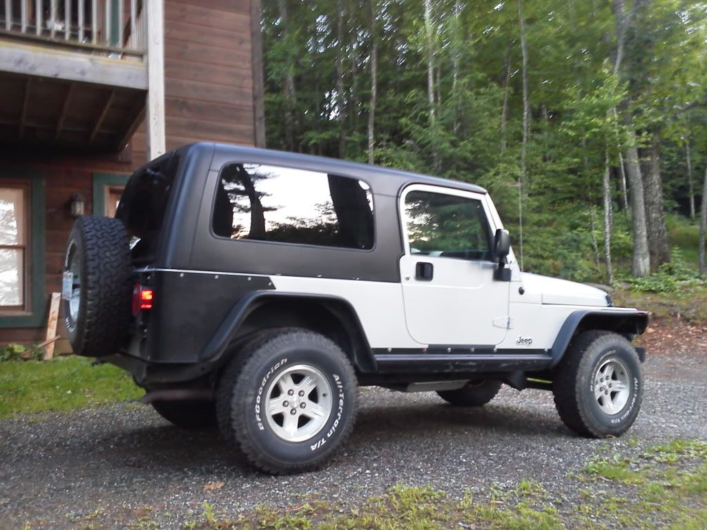

This past weekend I took the Jeep on a drive to Charlotte and noticed that I have developed some driveline vibes. They are present from 45-55mph and then go away. Also if I get on the gas hard to pass a vehicle I experience driveline vibes. I am only running a 2" RE spacer lift and the UCF belly up skid. This should put me at about 3.5" of driveline lift. But as you can see in the above picture I have a huge rear rake, even with a full tank of gas and hard top on. My front tire to fender flare clearance is 5.5" and the rear is 7.75". I wanted to remove the rake for looks but more importantly to fix the driveline vibrations. So I took the rear 1.75" spacer out and that left me with a 6.5" rear tire to fender clearance. I know it seeems like it should be 6.25" but I swear I'm left with 6.5" in the rear. I took it for a test spin and the vibrations were gone.
Before:
After:
And my K-9 partner Moses supervising everything:

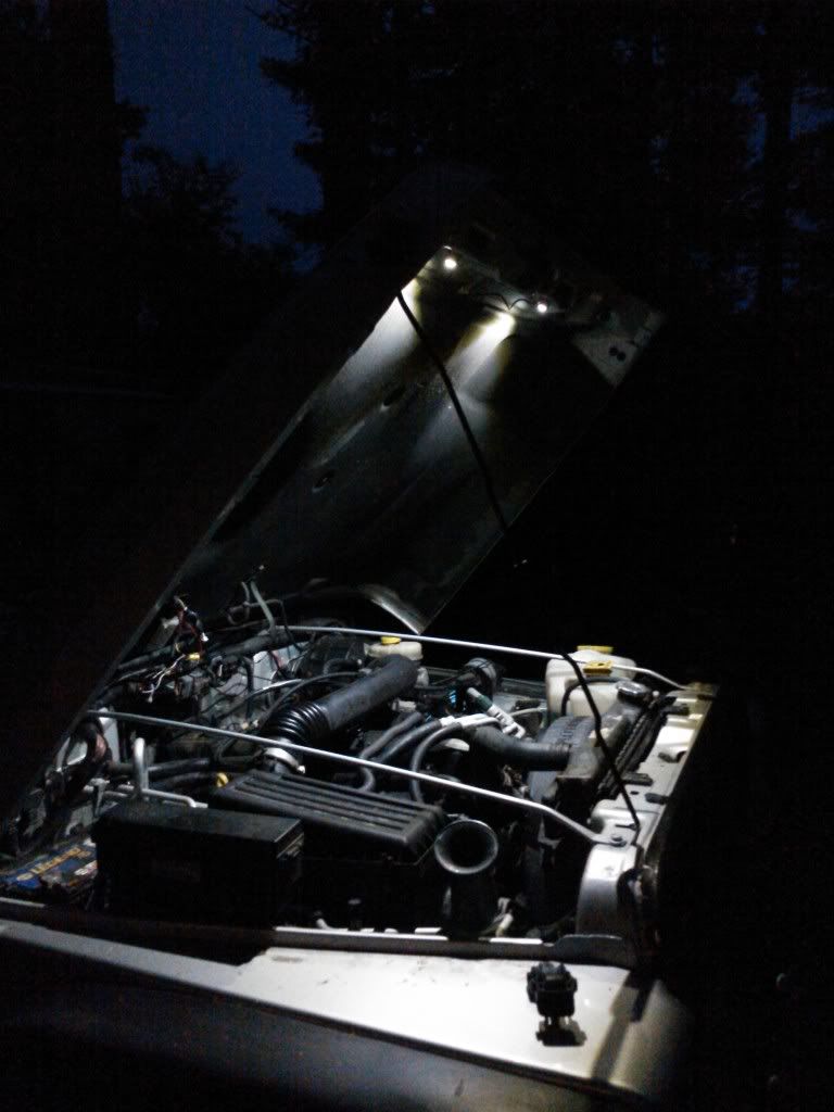

I hate the under hood light. I also hate having to hold a flashlight to check out something at night. So I took some Genright led lights and put them under the hood.

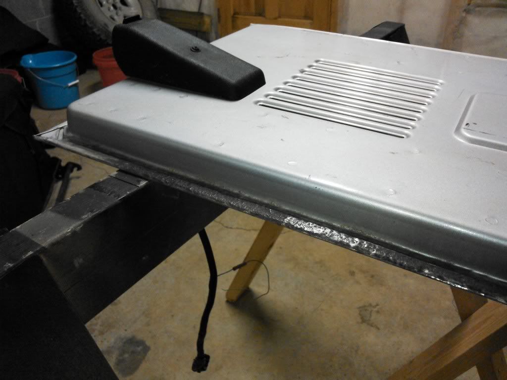

And then I embarked on the chore of replacing the under coating I sprayed on last year with some Rustoleum hammered paint to take care of the rust. I get to deal with salt here four months out of the year so keeping the rust in check is important. I pulled off my corner armor to check behind it and also repaint the corners and exogate. In the process I noticed the bottom of my tailgate was pretty rusted under the seal. I pulled off the seal and took care of the rust. I decided to change the paint color to hammered paint also, time will tell if I like it.

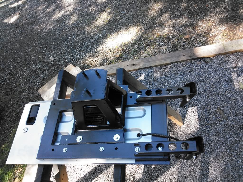

The powder coat on the exogate that I've had for about a year wasn't the best. So I hammered it when I did the corners.
Back on:
In this picture I had the tire carrier mounted more towards the passenger side but the hard top rear glass wouldn't close so I moved back to the center and the gate closes now.

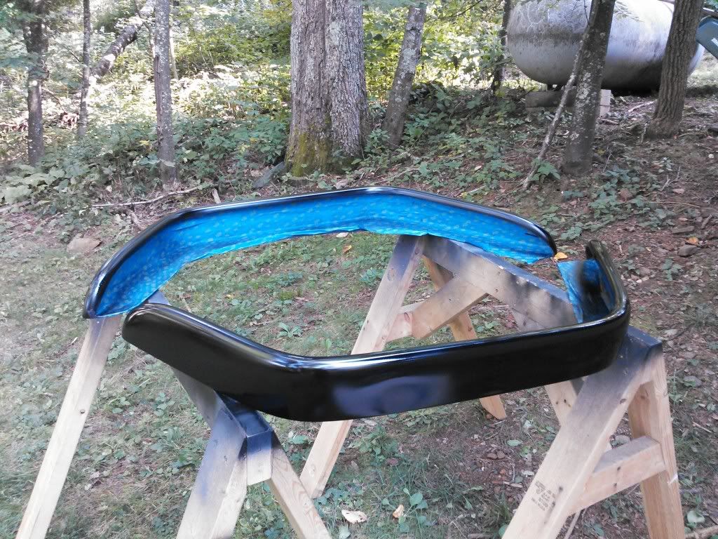

I also painted the Xenon flat flares, after about 3 years they have faded pretty good.
