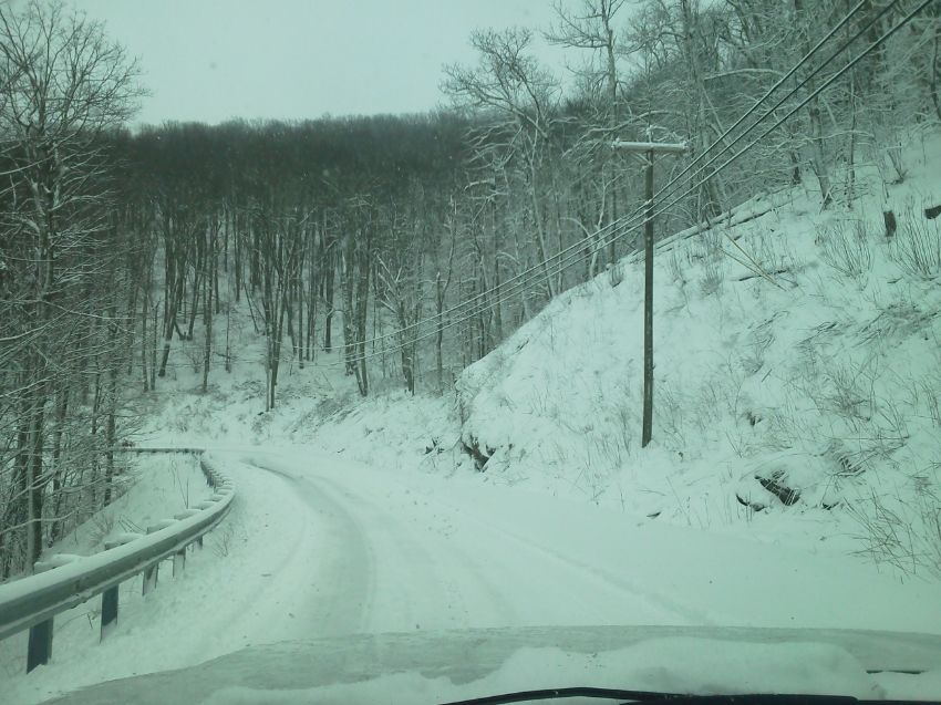

Update proving I haven't fallen off the face of the earth. I haven't done much recently to the Jeep, hopefully that will change this spring. This winter pretty much sucked and it has been snowy here from October until April. I don't have a garage at my house so wrenching was difficult. I did manage to get a few things below which I will highlight below.
Jeep this winter:
Rex in our snow cave:

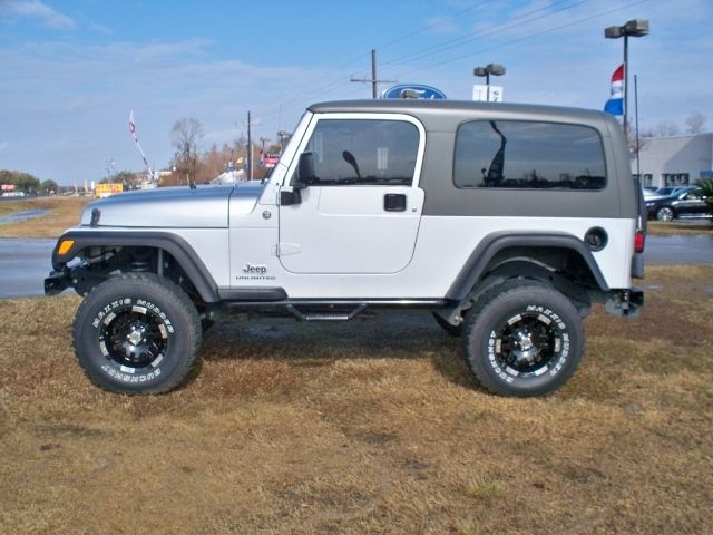

Next on my list is a hardtop. With the winters here I really need one. At first I was looking for a black top to go with the silver jeep. I was at my local 4wd shop and they had a grey one. I found some pictures online and wanted to get some opinions.
Example of silver with grey top.
What do u guys think?

post #59 of 110 Old 07-12-2013, 11:30 PM
G Beasley
Join Date: Nov 2001
Location: Eden
Posts: 5,707
You could always paint it black later if its a good deal . There was a black one on NC 4x4 for sale last week .

post #60 of 110 Old 07-13-2013, 03:49 AM Thread Starter
JeepinAaron
2003 WJ
Location: NC
Posts: 328
This grey one is actually more expensive than the NC4x4 top. I couldn't decide if I liked the grey or black better.
