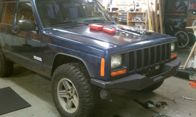

At some point, I decided to pull off the air dam and trim up the bumper pieces a bit, I knew I'd hit those parts on rocks anyway, and I wanted the bumper to NOT be the same color as the rest of the Jeep. It may be just me, but I didn't really like everything being the same color on this, and I think the black/dark blue is a pretty rad combo.
Bedlined bumper, anyone?

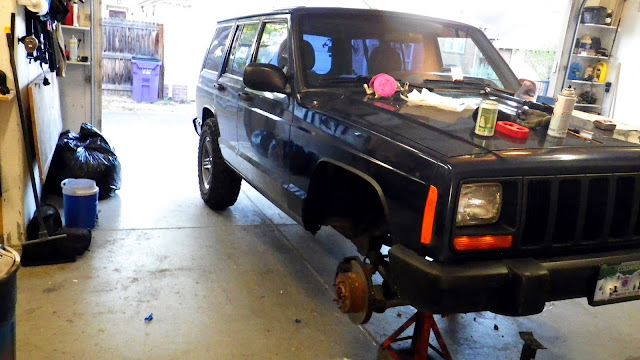

With these wicked, and fairly larger tires (and saggin' leaf springs) I had some significant fender rubbing pretty much any time I'd compress the suspension, as well as some rubbing on the LCA's. Put some fat washers behind the steering stops for the LCA issue for the time being, and started contemplating trimming my fenders, I've liked the looks of XJ's with trimmed fenders but hadn't really put much thought into it. So I actually did put some thought into it, looked at tons of pictures and decided to go for it. At first I just trimmed the back end to get the rubbing issue solved, and I wanted to figure out a better looking way to fill the gap in the front fenders other than the popular method of using a pool noodle.
I decided to use some 2" thick closed cell insulating foam from Home Depot, some spray foam, and a can of undercoating spray. Trimmed up the front end, and cut the pink foam (painted the back side so I don't see pink) to size, stuffed it into the wells and secured it with spray foam. Followed by a few coats of undercoating spray, one or two with some truck bed liner (which is also what I sprayed the front fenders with) and some satin black enamel. Probably more coats of more stuff than needed, but who cares, it looks clean, keeps the hinges dry, and more importantly to me: it's not a big pocket for air to catch in.

  • custom front bumper, file is being converted to a CNC readable CAD file now, getting steel soon, and hope to have it tacked together if not completed by the end of the weekend. Powdercoating shortly after.

BUMPER!
Here's a quick rundown on my process with this:
1) researched and designed...for hours. Designed, deleted, redesigned, deleted, repeat.
2) Build foam-core mockup, discovered what I needed to change, took changes into account, got better measurements and...
3) REdesign. Again. But with more accurate everything, it's ready to go.
4) File prep for CNC Plasma cutting (in progress)
5) Cut. Weld. Grind. Make purty.
6) Drop off at my favorite local powdercoater to be made real purty.
7) Install, and smile like a fat kid in a candy store.
I also took a bit of time to think about a quick way to add some rocker protection until I get to do the boat sides. I really like the look of Hanson's sliders, but can't find sh*tworth of info on them, so I just guessed how they'd go on, and figured hey... I'll bolt on some 3/16" steel welded into a dandy shape and that will help protect a bit, and look unique.
