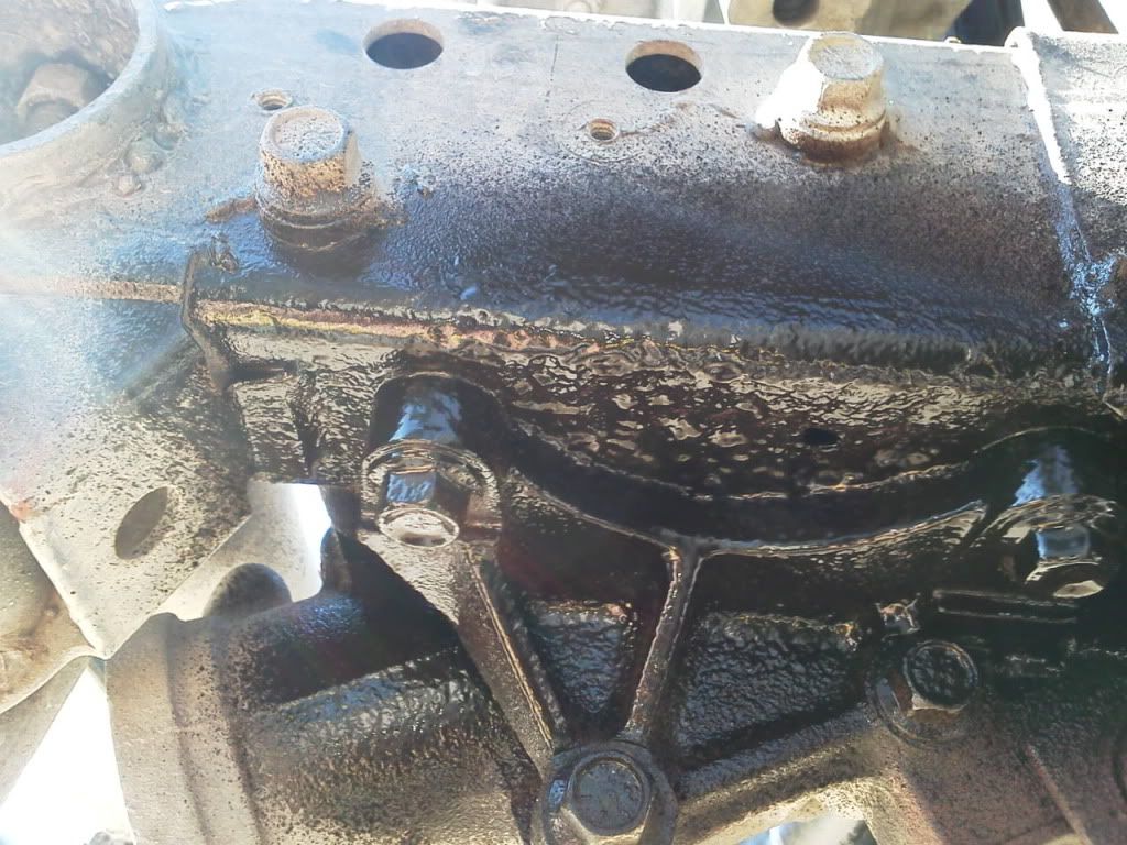

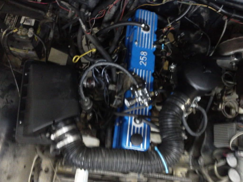

my plastic valve cover cracked so i updated and bought an aluminum one and intalled it, had to tap the holes where it would usually have placement nug on the plastic one
so the typical fix one part and another one brakes happened, after finally getting to drive around without having to call the epa for an oil spill, the frickin radiator blew a core and spewed all my anitfreeze out about a mile from home so i took it slow and got home and one of my friends who is doing a frame off sold me his used radiator that is in very good condition on the cheap
heres a pic of the old ratty leaky one that came out
and the inside of it
picked up a used one from a friend and dropped it in

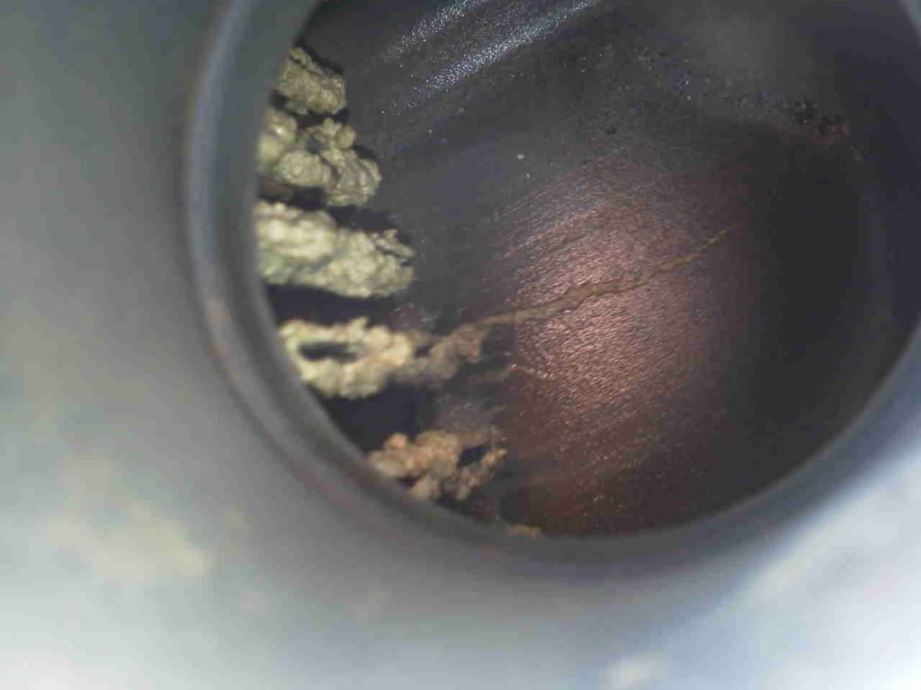

after several months of messing with the engine and most of the other components on the engine i have been noticing an excessive amount of blow by coming from the valve cover breather, last winter i did a seafoam and it seemed to help the smoke a little but recently it has come back with a vengeance, today was REALLY BAD!!.
After reading about what causes this online and doing every other fix it could be i have come to the conclusion that its either my piston rings or a need a valve job she is blowing by real bad towards third gear i had a guy roll the window down and tell me how bad it was today,ive checked and replaced my pcv, ive done several oil changes including one today im pretty sure this is what it is and thats NO FUN!!!
i have been noticing the smoke gradually getting worse and ive noticed my oil pressure running super high lately like 70-75 psi range
tomorrow im gonna do a compression check on each cylinder and then drop a teaspoon of oil in each and do it again to see if it is indeed the rings, i hope its only the valves really dont want to have to fully replace the engine after all the time and money ive put in it,i know i can have it bored but that about as expensive as a whole nother 4.2 so ill see whats what tomorrow and hopefully not find too much more bad news
ok ran the compression check and it confirmed my thinking of bad valves so im gonna start my tear down now and catch it early before i need to rebuild the whole motor, heres the readings

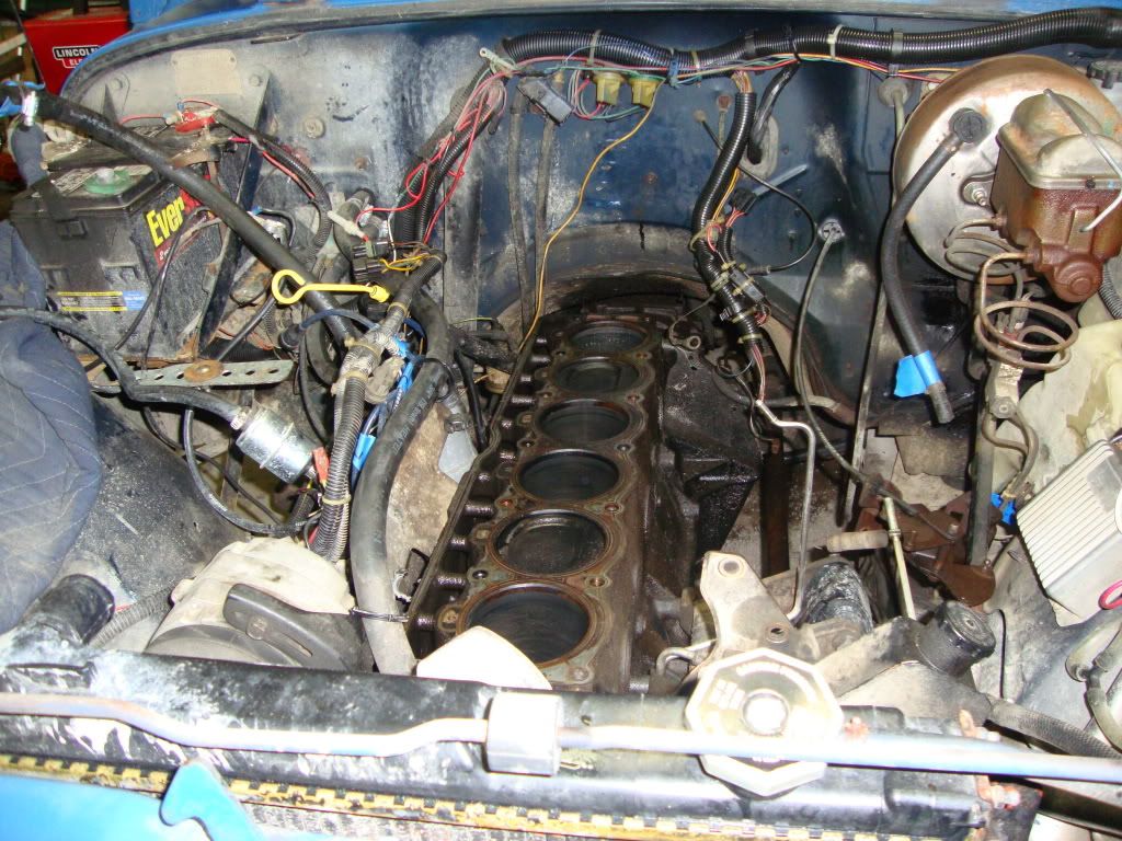

demolition is going along smoothly should have it ready to yank the head tonight really sucks having to take the valve cover and gasket off AGAIN this will be the 4th time so ive got it down like a pit crew, next will be loosen rocker arms and pull out the push rods then hopefully ill be able to pull everything and get to the machine shop for rebuilding... i guess the positive is i will have a new top end when completed... gotta think positive
ok got the motor ready for head removal tomorrow, here is what ive stripped
intake
intake manifold
exhaust manifold
exhaust
antifreeze drained
valve cover
all hoses marked and removed
all wires detached and named
not bad for one afternoon if ya ask me, tomorrow im gonna loosen the rocker arms and pull the push rods and hopefully pull the head and get it ready to go to the machine shop for rebuilding, while im at it im gonna check my bottom end and make sure the cylinder walls aren't scored or anything else scary, wish me luck

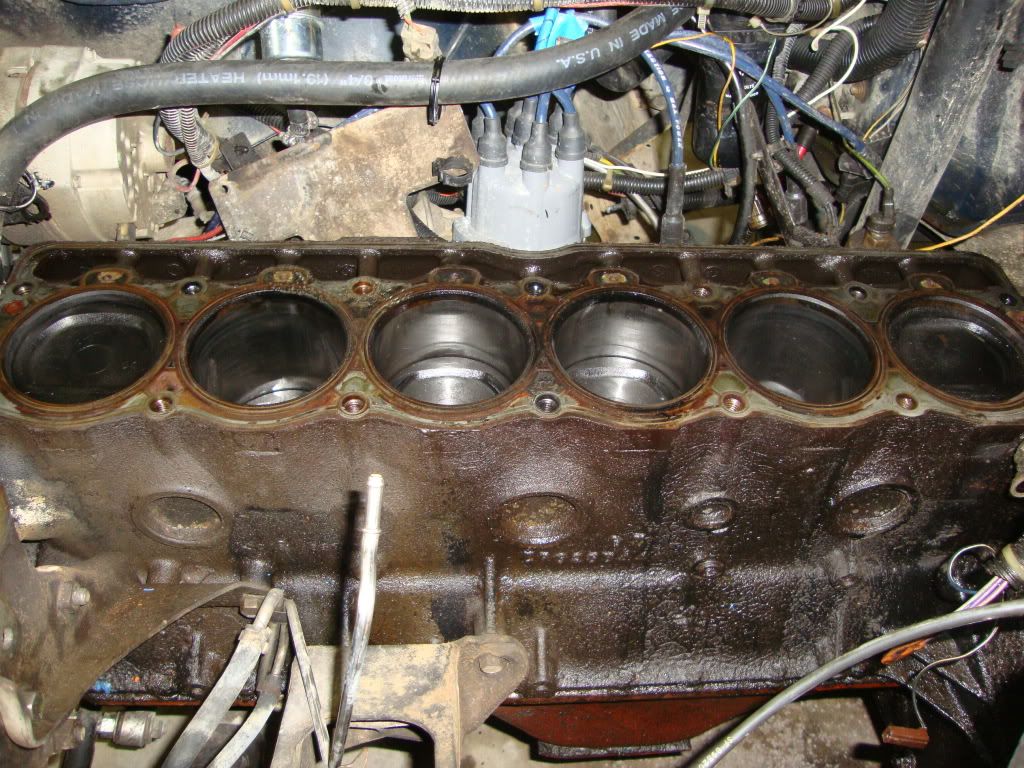

here are some pics of the demolition, here is where i started
heres where i started
empty engine bay
cylinder wall looked great didnt feel any scoring so im taking the head to the machine shop for a head job

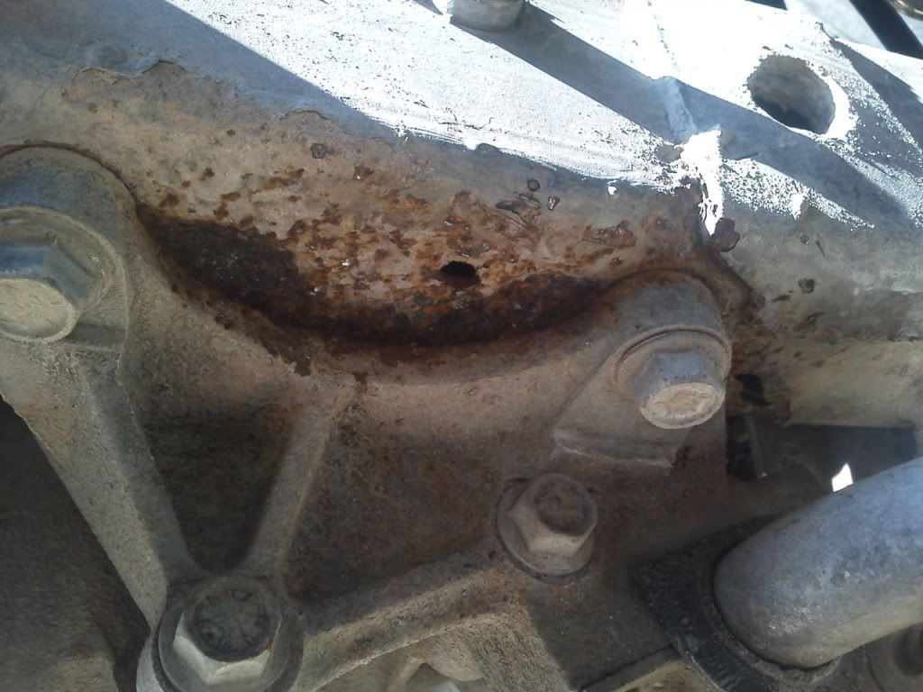

while im waiting for the machine shop i figure ill do some repairs on any and all rust on the heep
first bothersome rust was in the pocket between the tc skid an the frame so i dropped the skid and fixed both sides with a new wire tool i found at lowes and then went over with undercoating, this attachment is a beast and i recommend it to everyone
heres the part under the skid before
and after wire wheeling and undercoating
and when i took my battery out i found some rust under there too so i hit it with the wire thingy and undercoated that too
before
