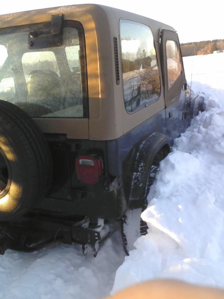

heres how it looked when i got it stuck the first time now it burns when i pee

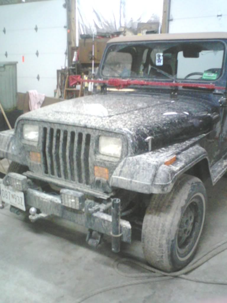

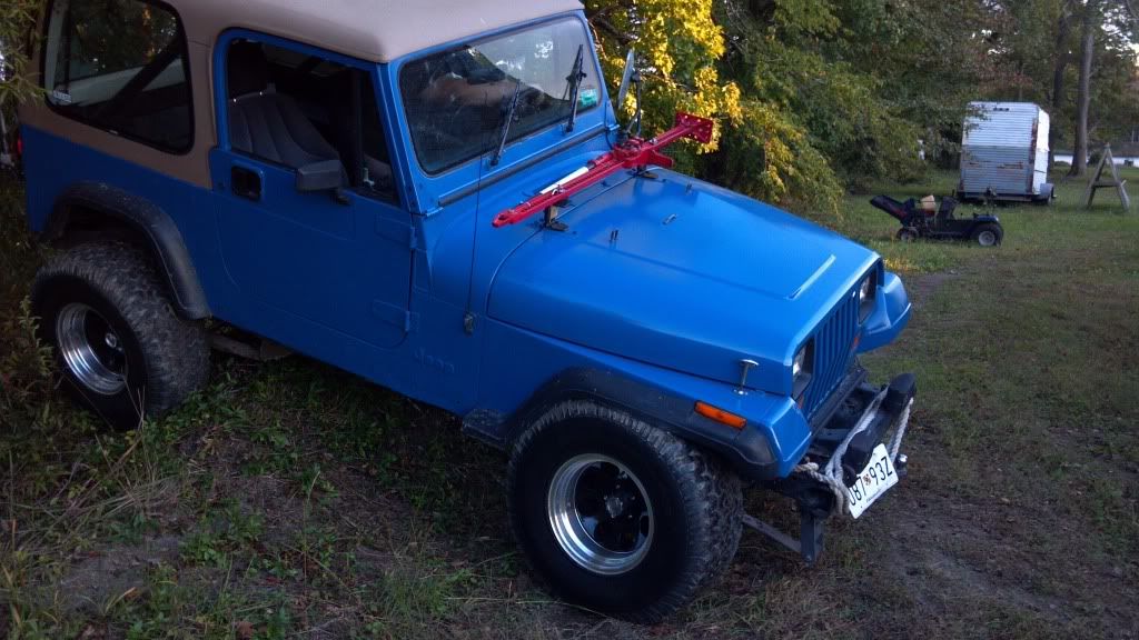

i drove it around like that for a while until christmas came and i got a hi-lift jack and fabbed up some brackets for the hood

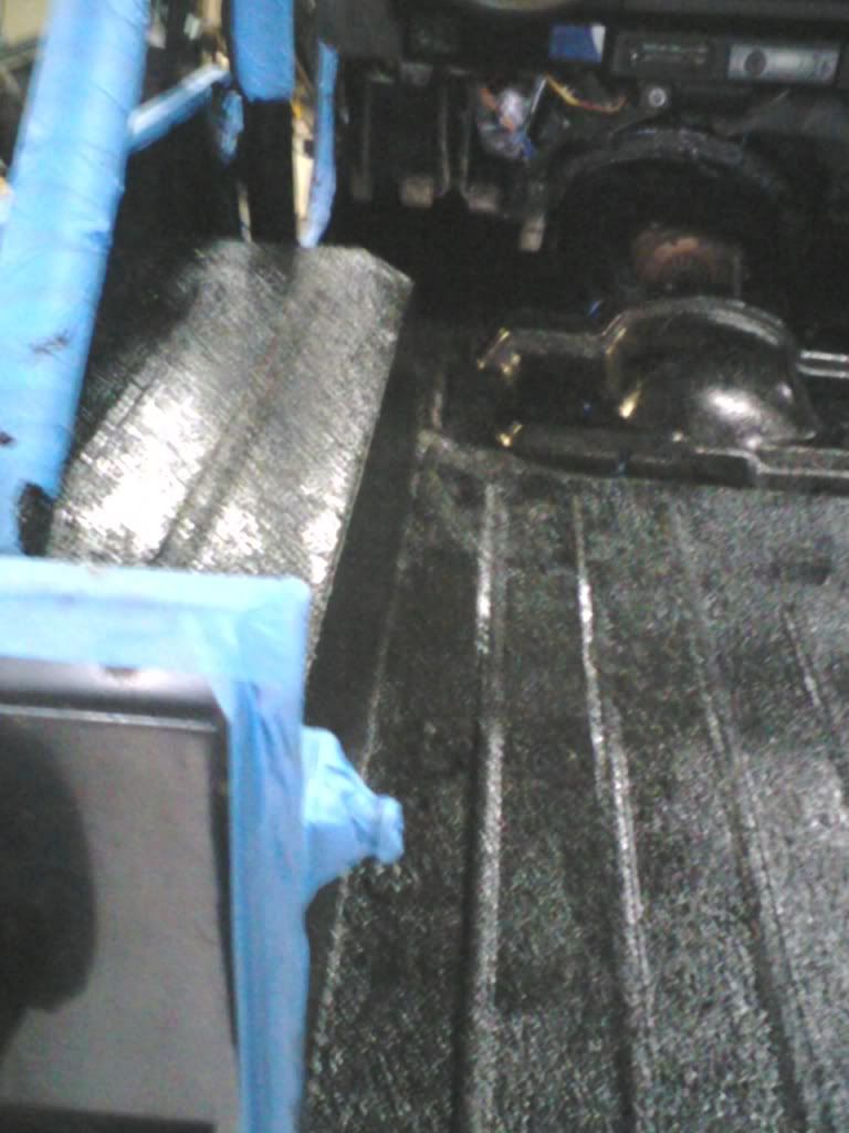

then i bedlined the interior with herculiner to keep rust away

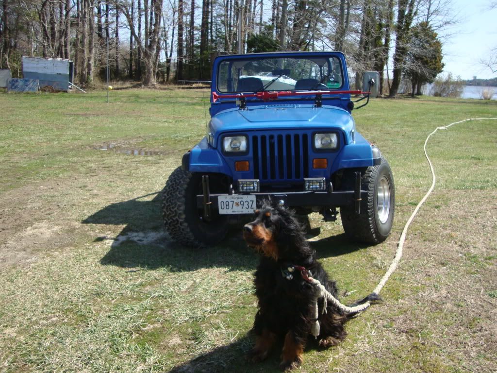

heres a pic with the 33's on a 2" body lift

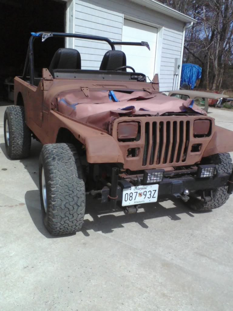

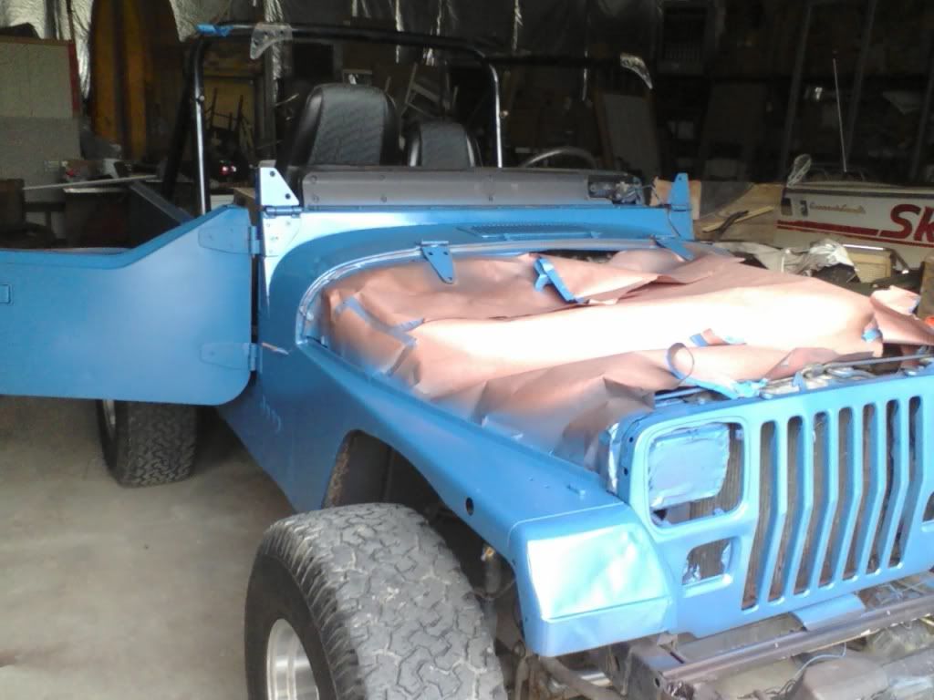

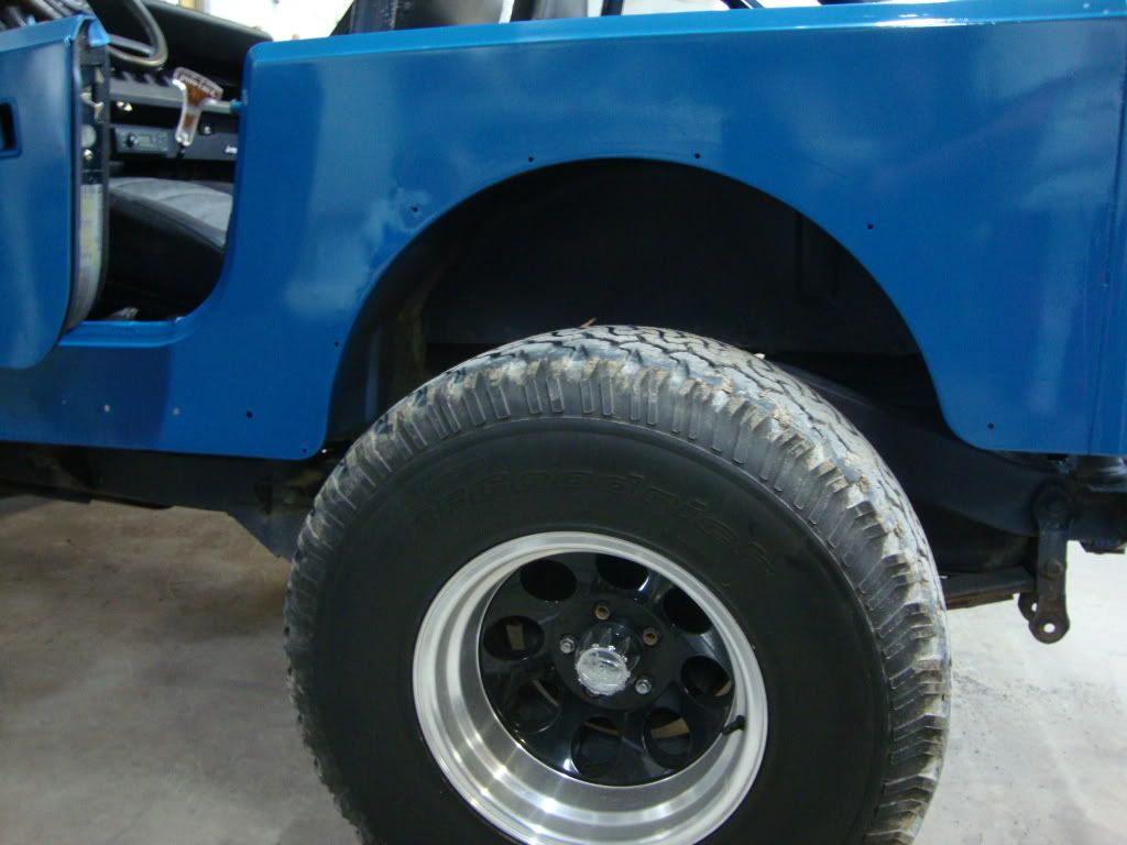

and i drove it like that until spring break of senior year i tore it apart and did a paint job, i chose rustoleum gloss royal blue because if i scratch it i can just scuff it up and cover it ,
heres some pre, during, and post paintjob pics
stripped
sanded
primed and sanded
first coat
dont have any pics from the second coat but here's the third and final coat
and all back together

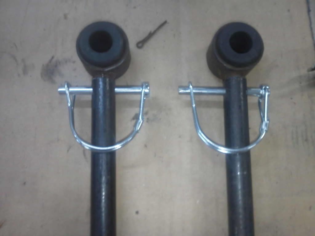

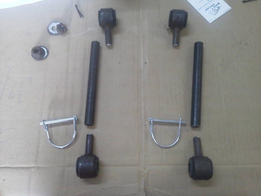

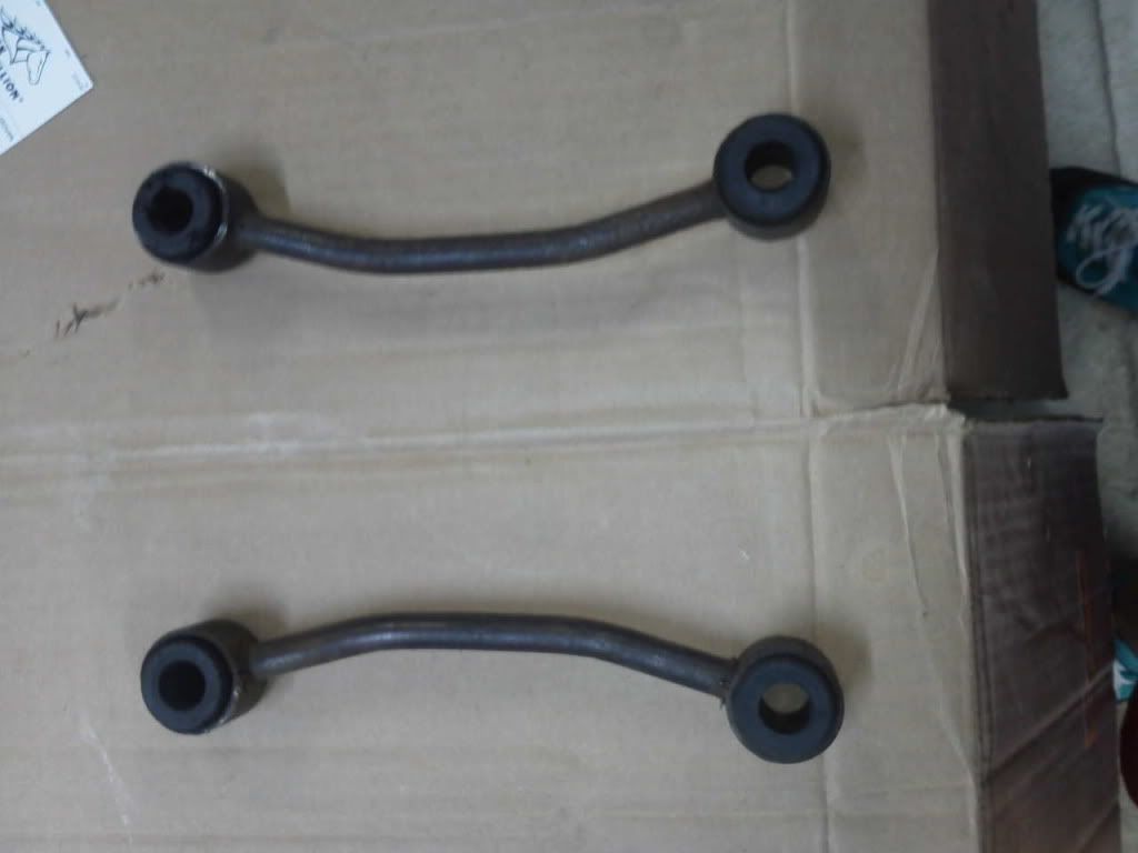

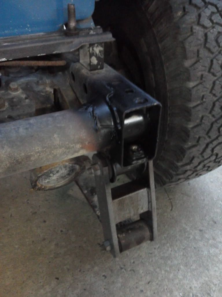

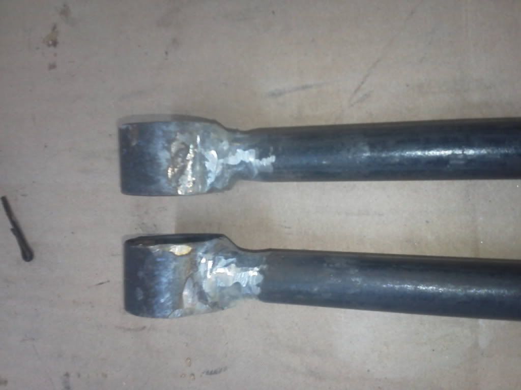

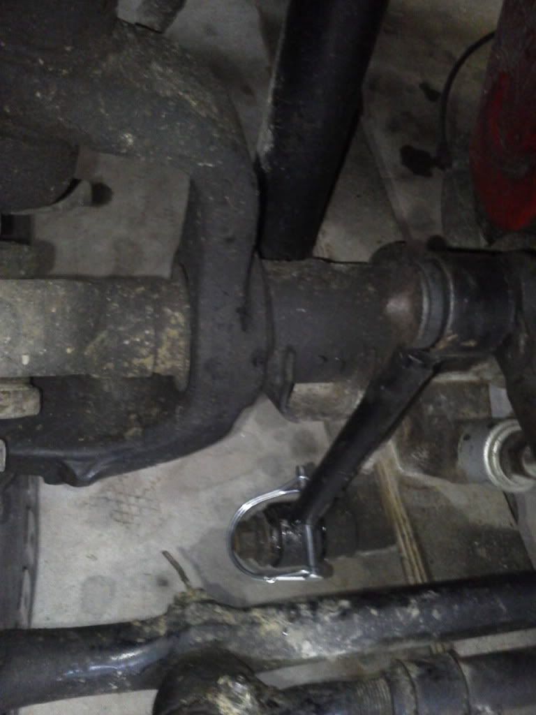

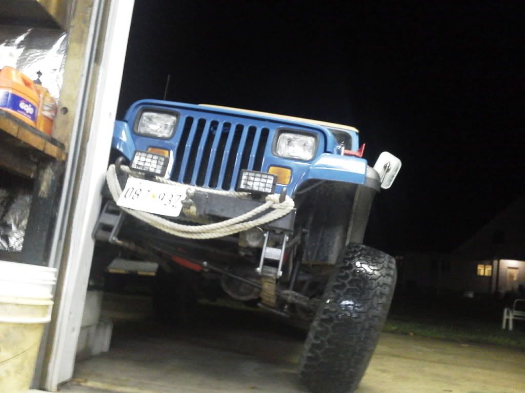

after the paint job i was getting tired of having no articulation at all so i bought some 1 " shackels and put em on
now she had a little bit of travel so i was contempt with that and the search for a welder was on, and just last month sept. 2011 i scored a welder off of cl and got to work on the fab, the first thing i made was some homebrew quick discos

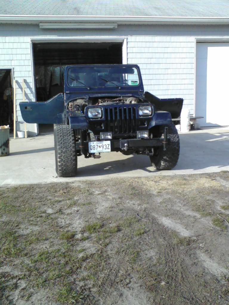

got some poser shots with em disco'd

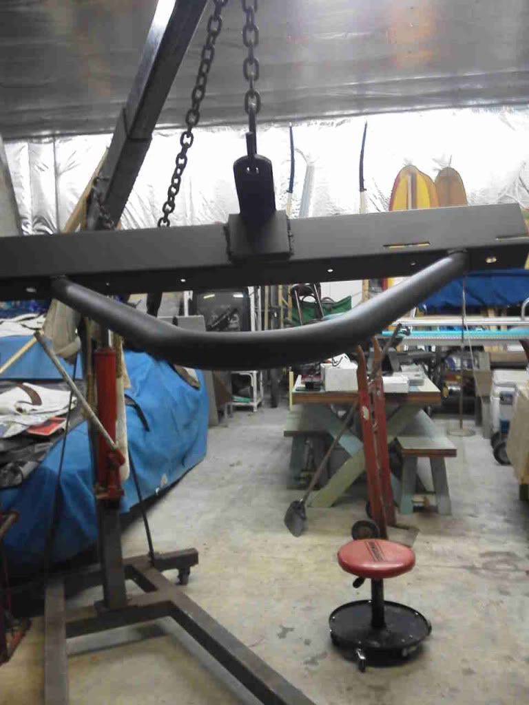

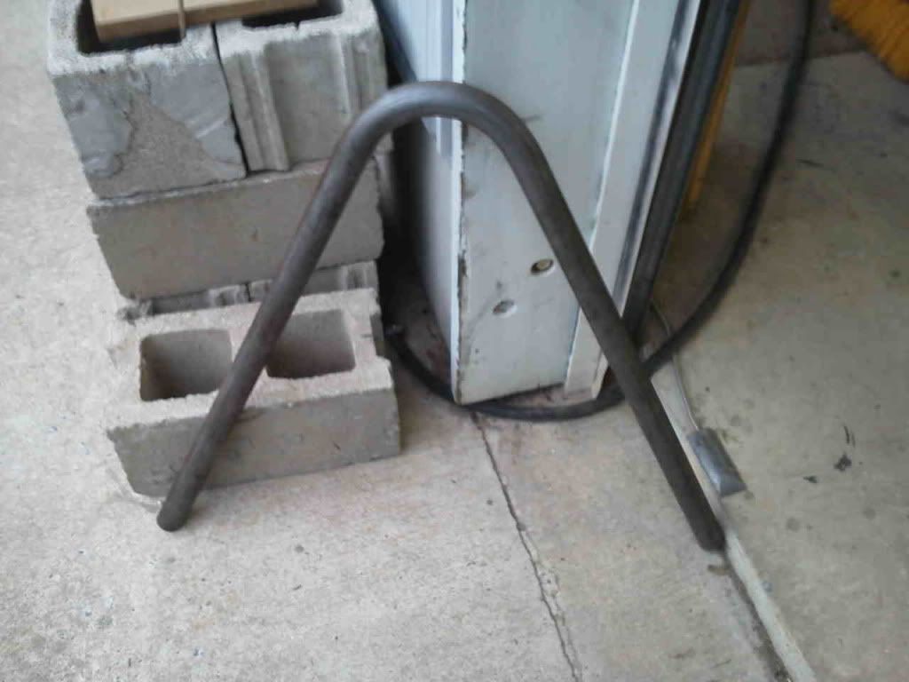

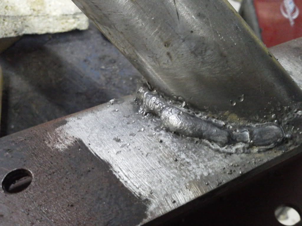

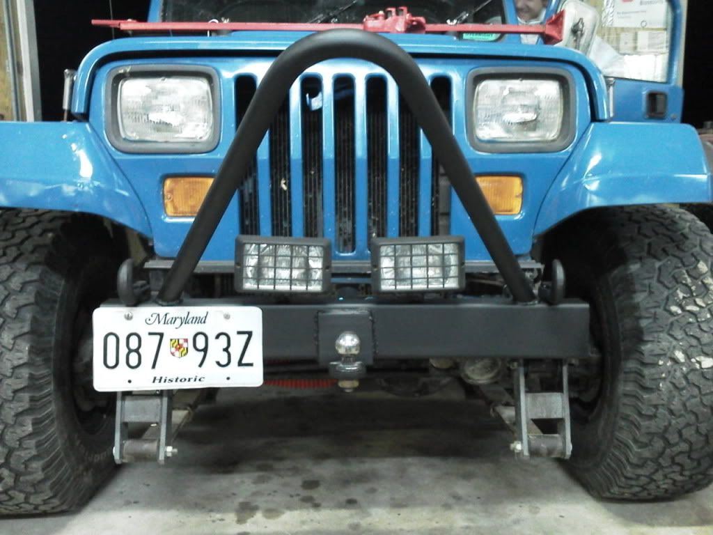

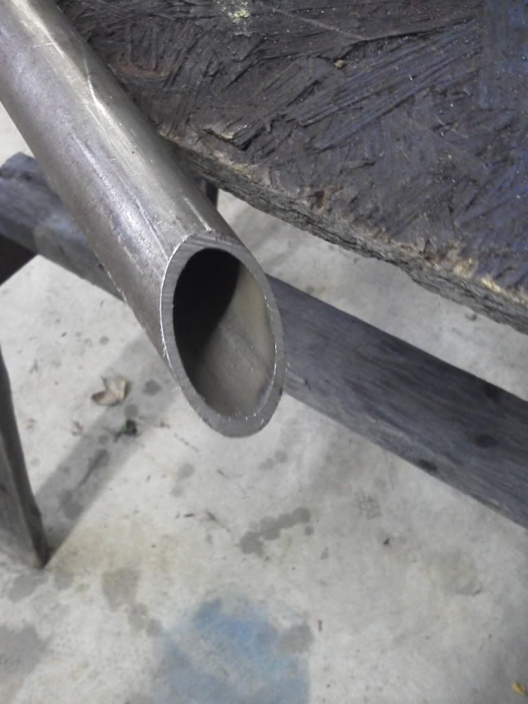

then the stinger fab started, i got the tube from a local machine shop

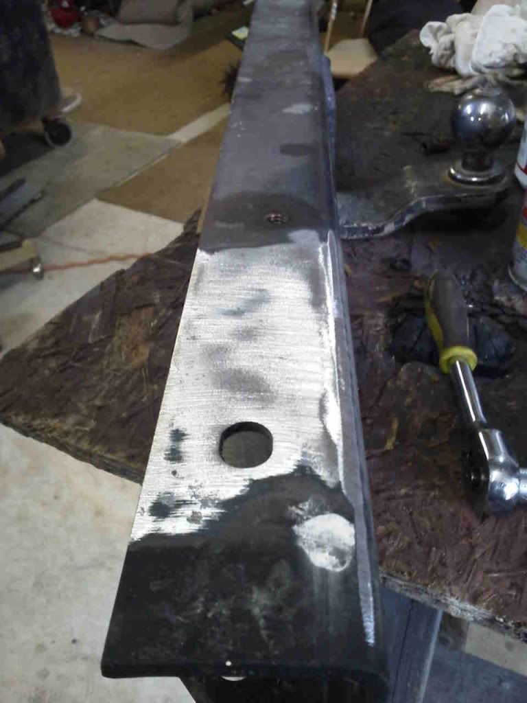

took off and prepared my bumper
cut tube to 50 degrees
and welded it on
then sanded, primed, and painted the whole setup flat black to match my bezels
all installed

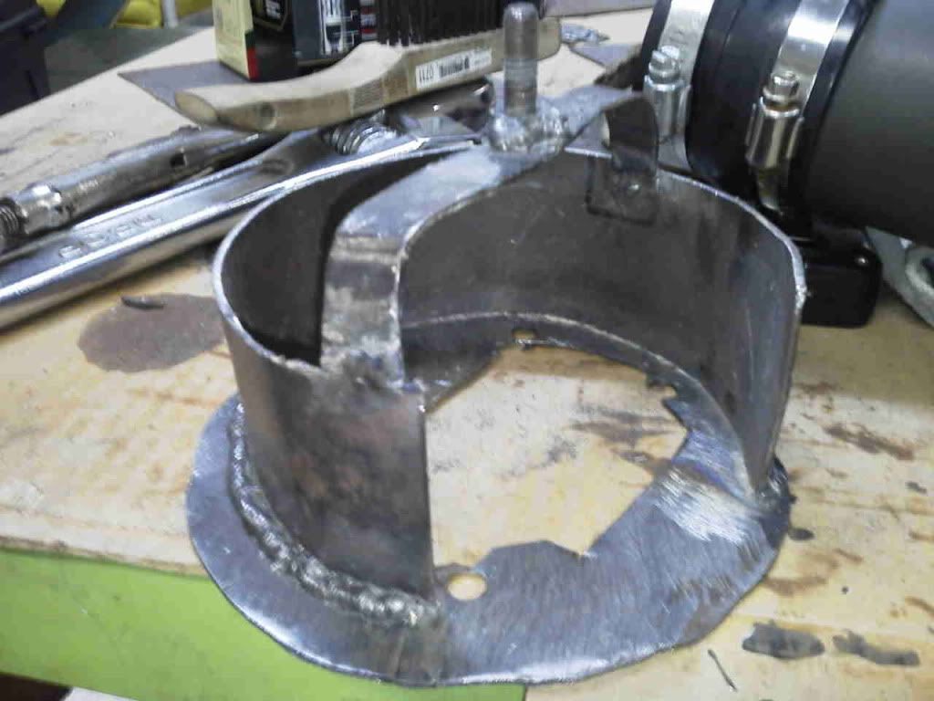

one of my friends from my jeep club gave me a snorkel to fab a bracket for the carb and that was my next project
homebrew braket
all installed

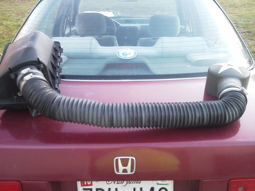

the basics on the intake is that its a 98 crown vic air intake box connected to some intake hose from advance auto from there its mated to a modified 6" pipe cap

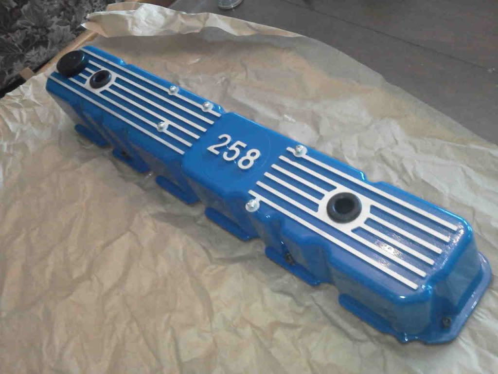

my plastic valve cover cracked so i updated and bought an aluminum one and intalled it, had to tap the holes where it would usually have placement nug on the plastic one

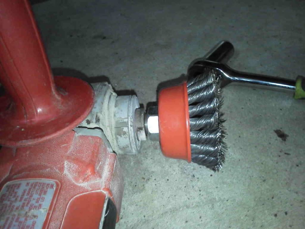

also tackled some rust today i hit everything with the slag hammer and then went over with a wire wheel
before
after some major grinding and undercoating

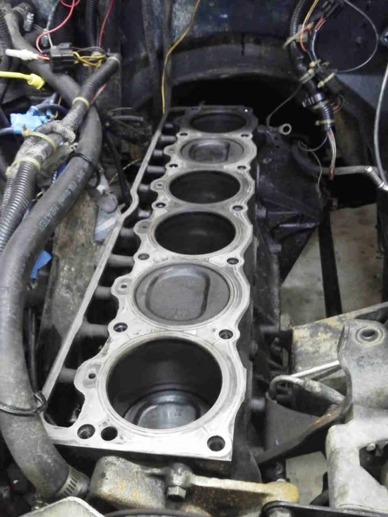

after several months of messing with the engine and most of the other components on the engine i have been noticing an excessive amount of blow by coming from the valve cover breather, last winter i did a seafoam and it seemed to help the smoke a little but recently it has come back with a vengeance, today was REALLY BAD!!.
After reading about what causes this online and doing every other fix it could be i have come to the conclusion that its either my piston rings or a need a valve job she is blowing by real bad towards third gear i had a guy roll the window down and tell me how bad it was today,ive checked and replaced my pcv, ive done several oil changes including one today im pretty sure this is what it is and thats NO FUN!!!
i have been noticing the smoke gradually getting worse and ive noticed my oil pressure running super high lately like 70-75 psi range
tomorrow im gonna do a compression check on each cylinder and then drop a teaspoon of oil in each and do it again to see if it is indeed the rings, i hope its only the valves really dont want to have to fully replace the engine after all the time and money ive put in it,i know i can have it bored but that about as expensive as a whole nother 4.2 so ill see whats what tomorrow and hopefully not find too much more bad news
ok ran the compression check and it confirmed my thinking of bad valves so im gonna start my tear down now and catch it early before i need to rebuild the whole motor, heres the readings

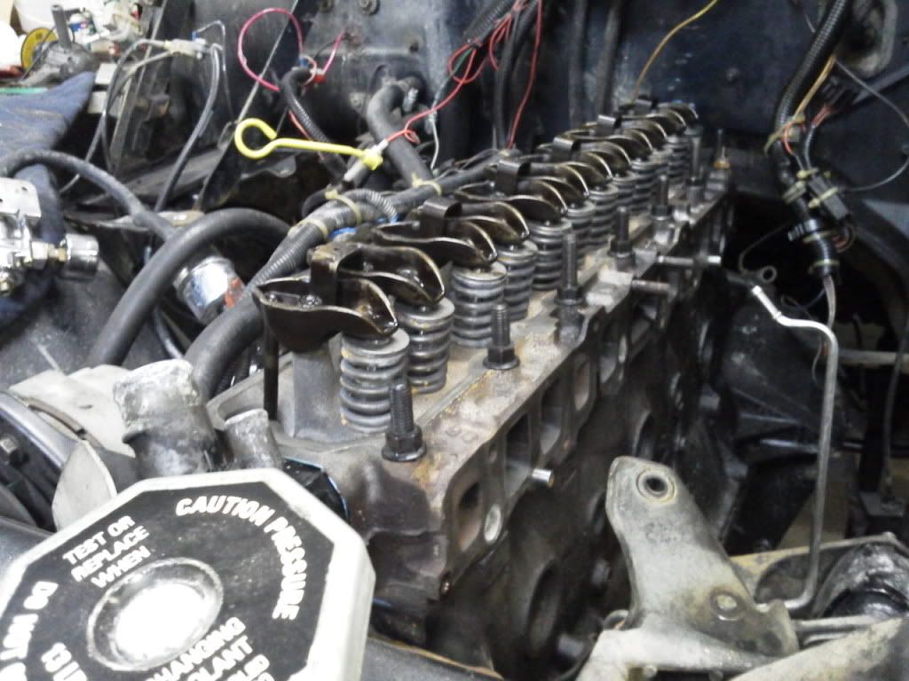

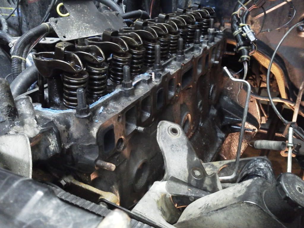

demolition is going along smoothly should have it ready to yank the head tonight really sucks having to take the valve cover and gasket off AGAIN this will be the 4th time so ive got it down like a pit crew, next will be loosen rocker arms and pull out the push rods then hopefully ill be able to pull everything and get to the machine shop for rebuilding... i guess the positive is i will have a new top end when completed... gotta think positive

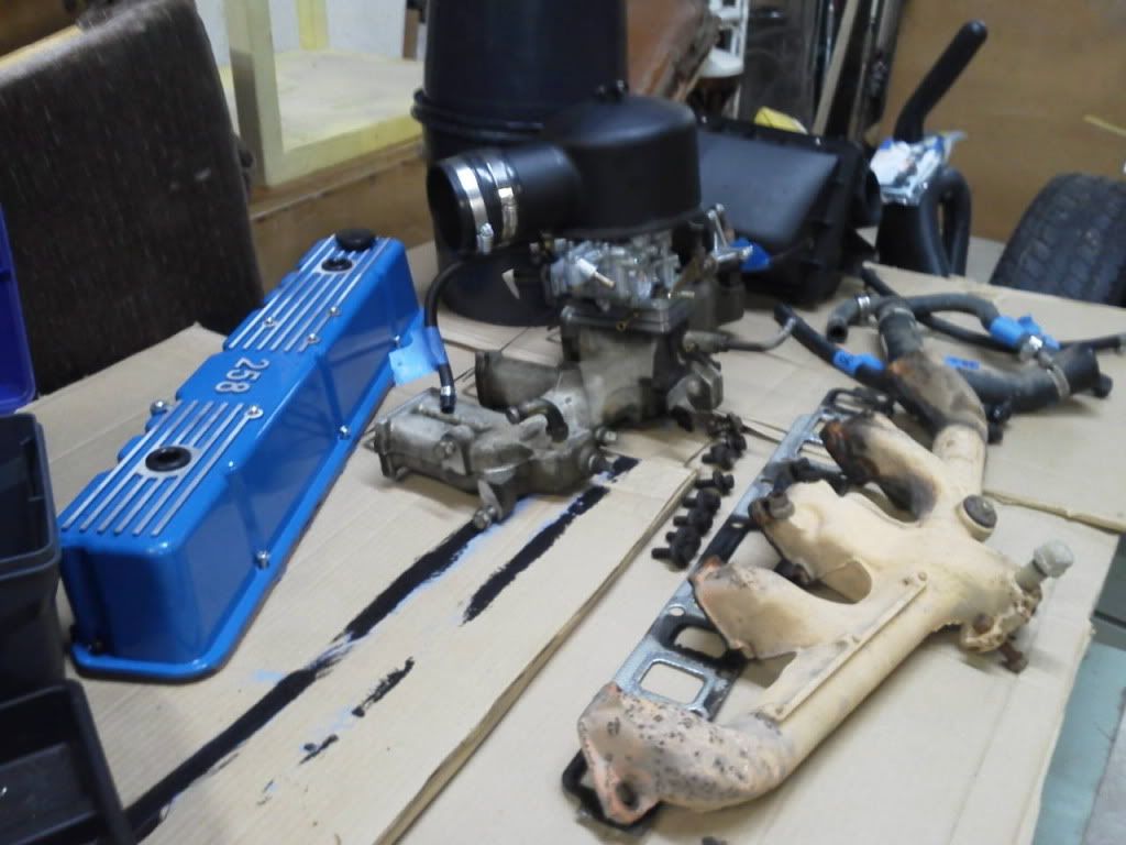

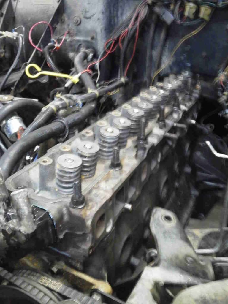

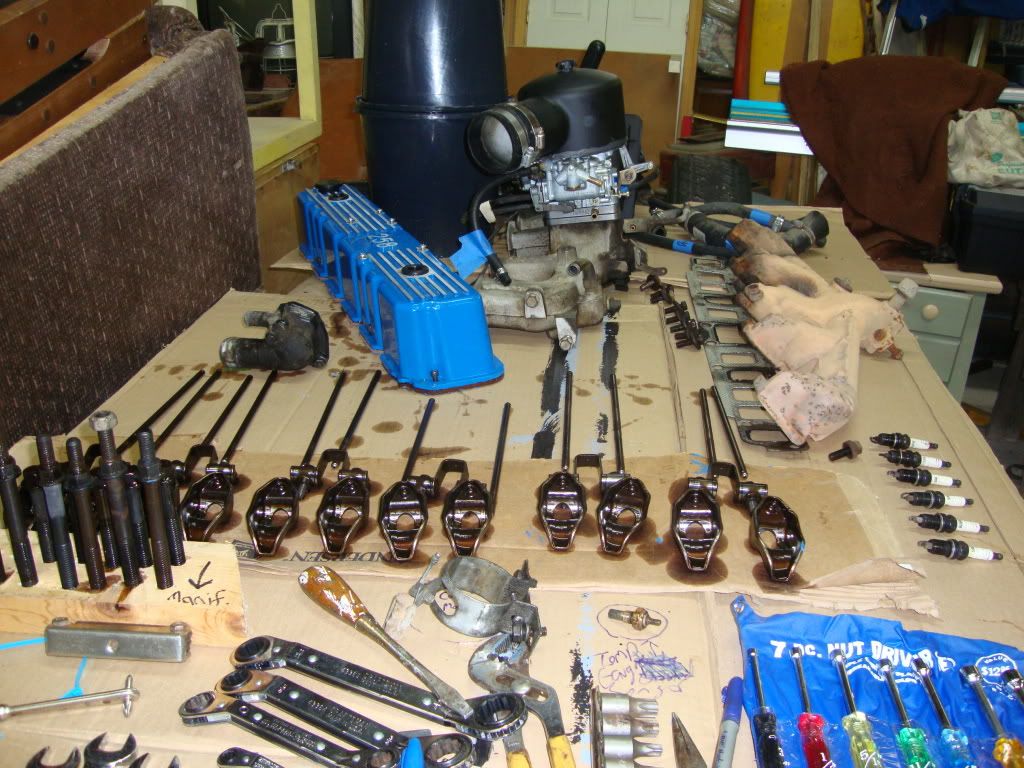

ok got the motor ready for head removal tomorrow, here is what ive stripped
intake
intake manifold
exhaust manifold
exhaust
antifreeze drained
valve cover
all hoses marked and removed
all wires detached and named
not bad for one afternoon if ya ask me, tomorrow im gonna loosen the rocker arms and pull the push rods and hopefully pull the head and get it ready to go to the machine shop for rebuilding, while im at it im gonna check my bottom end and make sure the cylinder walls aren't scored or anything else scary, wish me luck
here are some pics of the demolition, here is where i started
heres where i started
empty engine bay

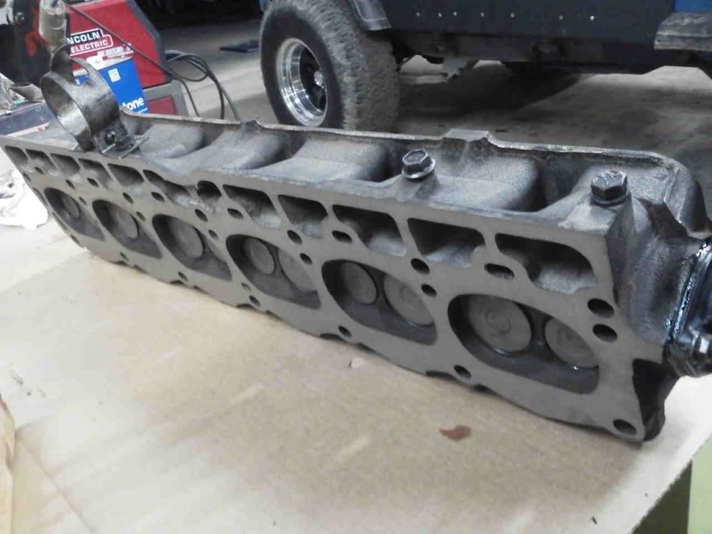

cylinder wall looked great didnt feel any scoring so im taking the head to the machine shop for a head job
the parts table is growing
so ive talked it over with my dad deciding on a game plan for the motor. weve established that it is going to cost about 200 or so to have the head redone, i was considering pulling everything and doing a complete rebuild while im in here, but i dont have the time or the funds right now, cylinder 2 scares me a little there is an extremely marginal score and when i say extremely marginal i mean we over looked it several times so my game plan is that im going go get the head redone and reassemble everything and see how it runs, if it runs great then good for me, and if it still has blow by then i still have a redone head and im only out like 30 for gaskets, if it does turn out to be rings im gonna drive the freight train till summer when i can get money together to do a complete rebuild, cuz when i rebuild im gonna do it right bored 30 or 60 over, new balanced crank, mild cam and that takes a lot of money

first bothersome rust was in the pocket between the tc skid an the frame so i dropped the skid and fixed both sides with a new wire tool i found at lowes and then went over with undercoating, this attachment is a beast and i recommend it to everyone
heres the part under the skid before
and after wire wheeling and undercoating

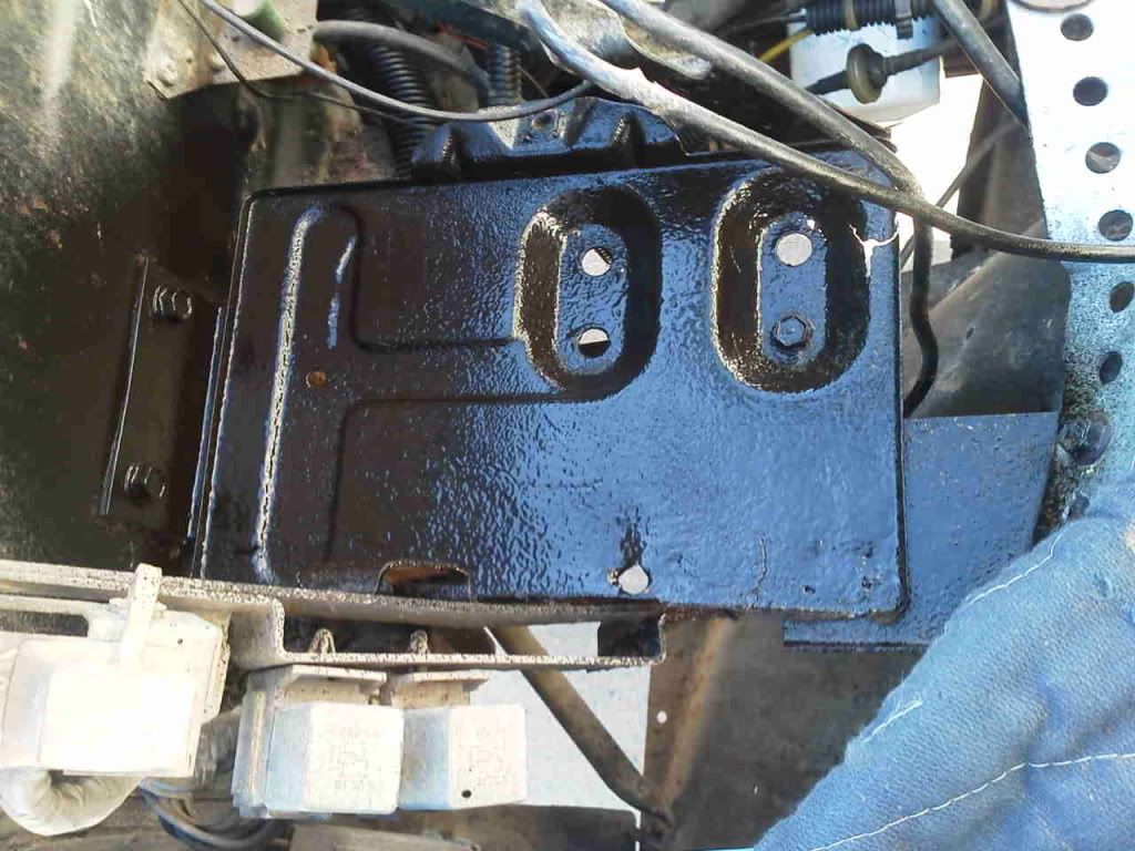

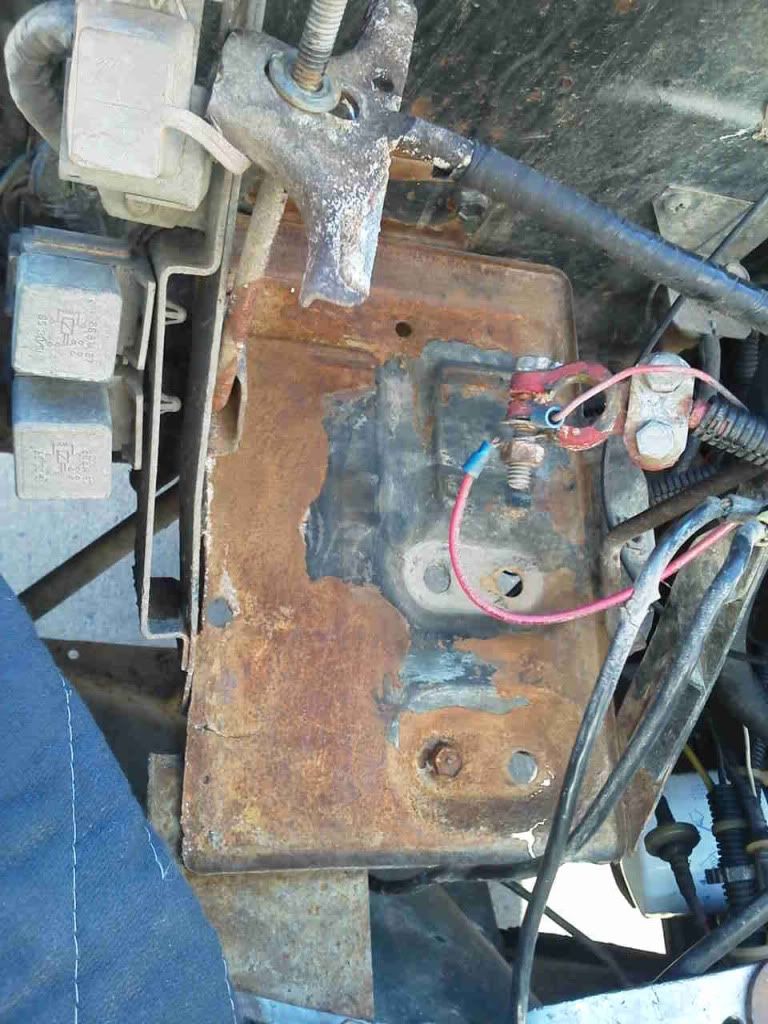

and when i took my battery out i found some rust under there too so i hit it with the wire thingy and undercoated that too
before
ok i got the head back yesterday around 4 pm and i worked in the garage until 2 am today lol, i managed to completely reassemble it and fired it up with open headers , bad news is i still have a little bit of blowby so the head job didnt fix as much as i wanted it to fix but im not smoking like a freight train anymore either. so im gonna drive it like this till i can do a whole rebuild cuz when i do im going deep, .60over, mild cam, headers, roller rockers the whole shabang
prepped block
head sat in place
valves and rocker arms installed
still got some major blowby so it confirmed my suspicion of bad rings, so im gonnna drive it like a smokin locomotive till i can get the funds together for a full rebuild and a little hi-performance work
