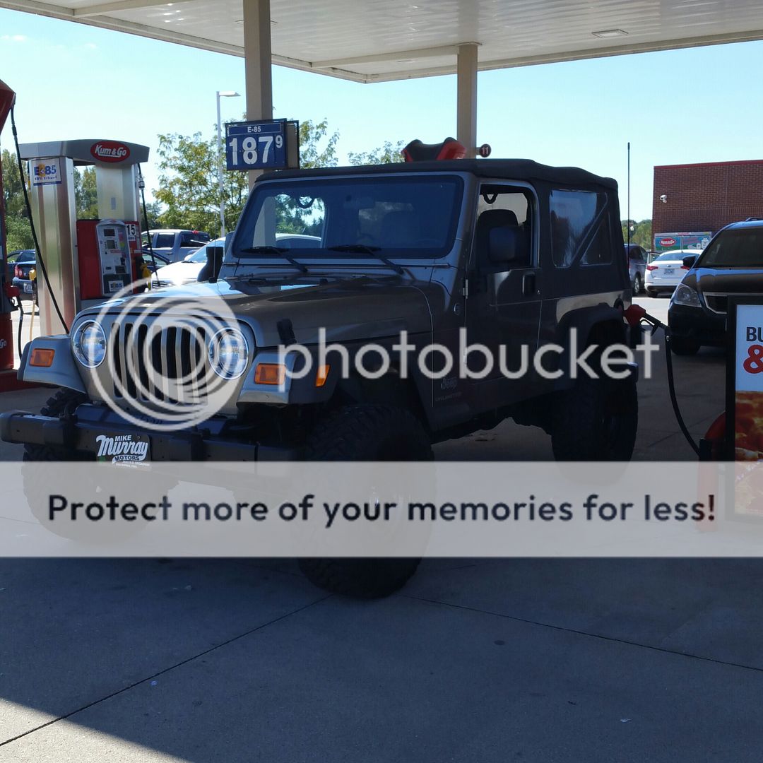

After I got out of school I decided I definitely needed a decent rig to tinker with and hopefully take me to new and adventurous locations. With a little luck I won’t finish the build only to turn around and sell it on a whim. I was thinking about getting another JK to start with. I knew I didn’t want a 4 door so I checked out a few 2 doors. The JKs don’t feel right to me. While they may be arguably better built and more capable out of the box, they are too cushy and refined for me…. maybe I just have a soft spot for CJs and TJs? Anyways, I decided I wanted a LJ the same color as my TJ (below)….. and I wanted a low mileage, rust free, and unmodified one also. After about 3 or 4 months I found one that had been slightly modified, but was 100% rust fee and stupid clean. It came from Arizona and I’m thinking a retired guy just tooled around in it, because there are no signs what so ever of off road use.
The old…..
The new….
It came with 33s and a Teraflex lift. The lift looks to be 4” with a 1” body lift. It also came with a hi-lift and a CB radio.

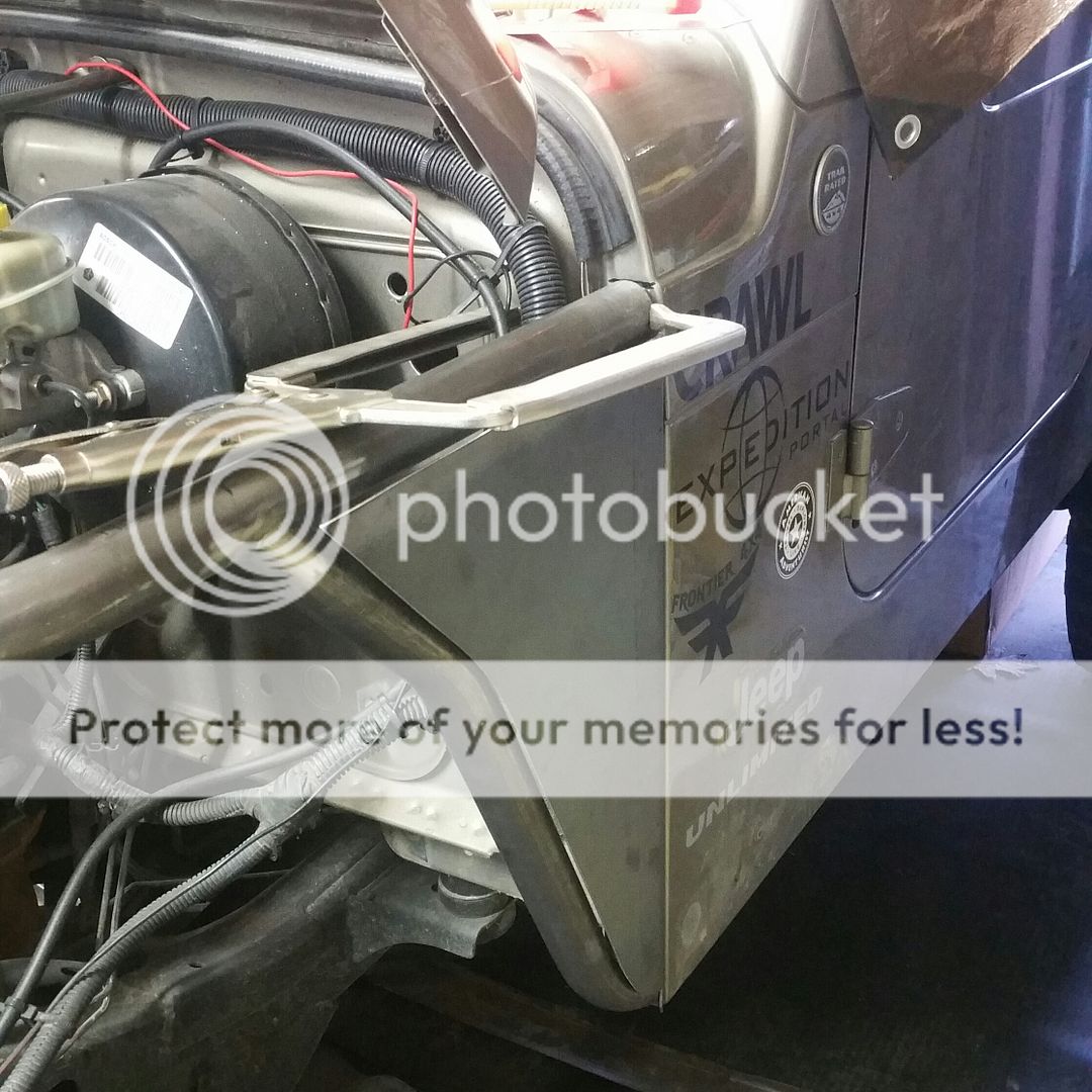

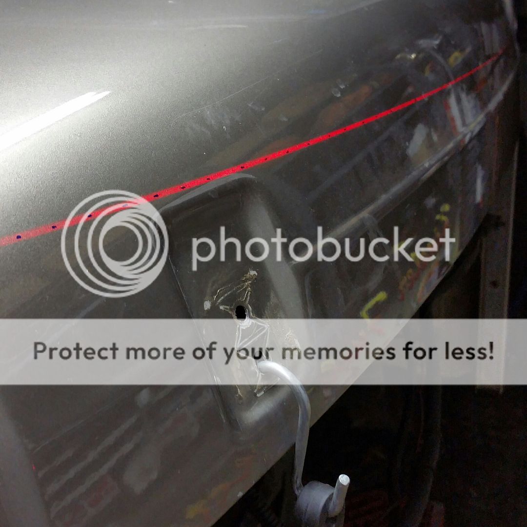

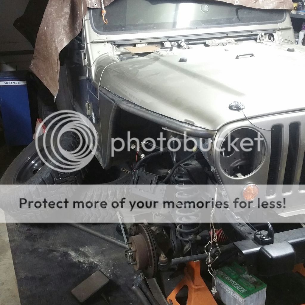

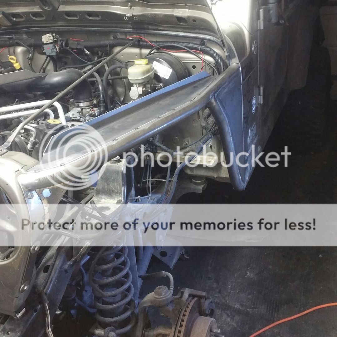

The first thing is was planning on crossing off the list was the trimmed bumper… which I got done, but I decided while I had the sawzall out I may as well trim my fender flares a bit. Two hours later I decided to highline the front. This was not on the list…. And so it starts

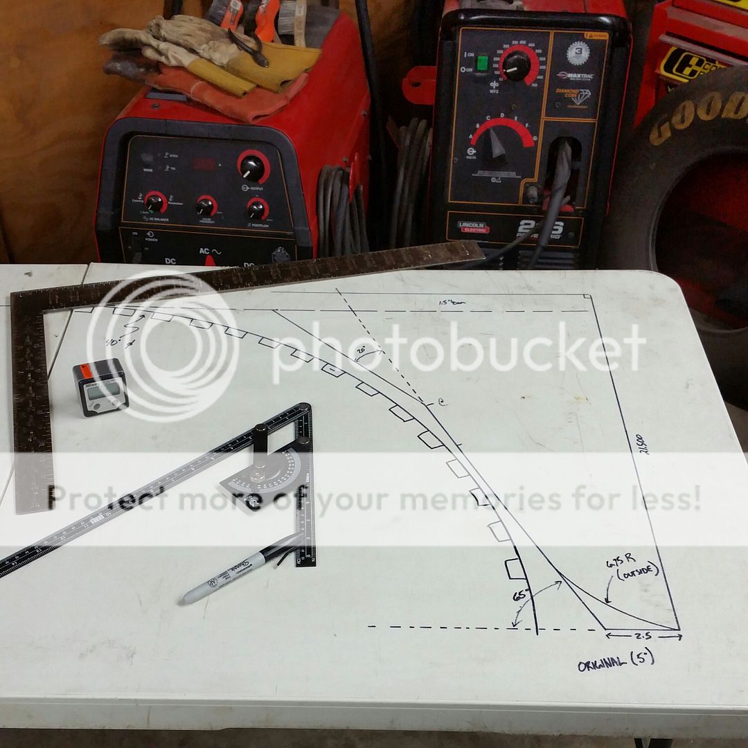

I wasn’t happy with my initial measurements. This is the first time I’ve done bodywork with a laser level!
Brainstorming…

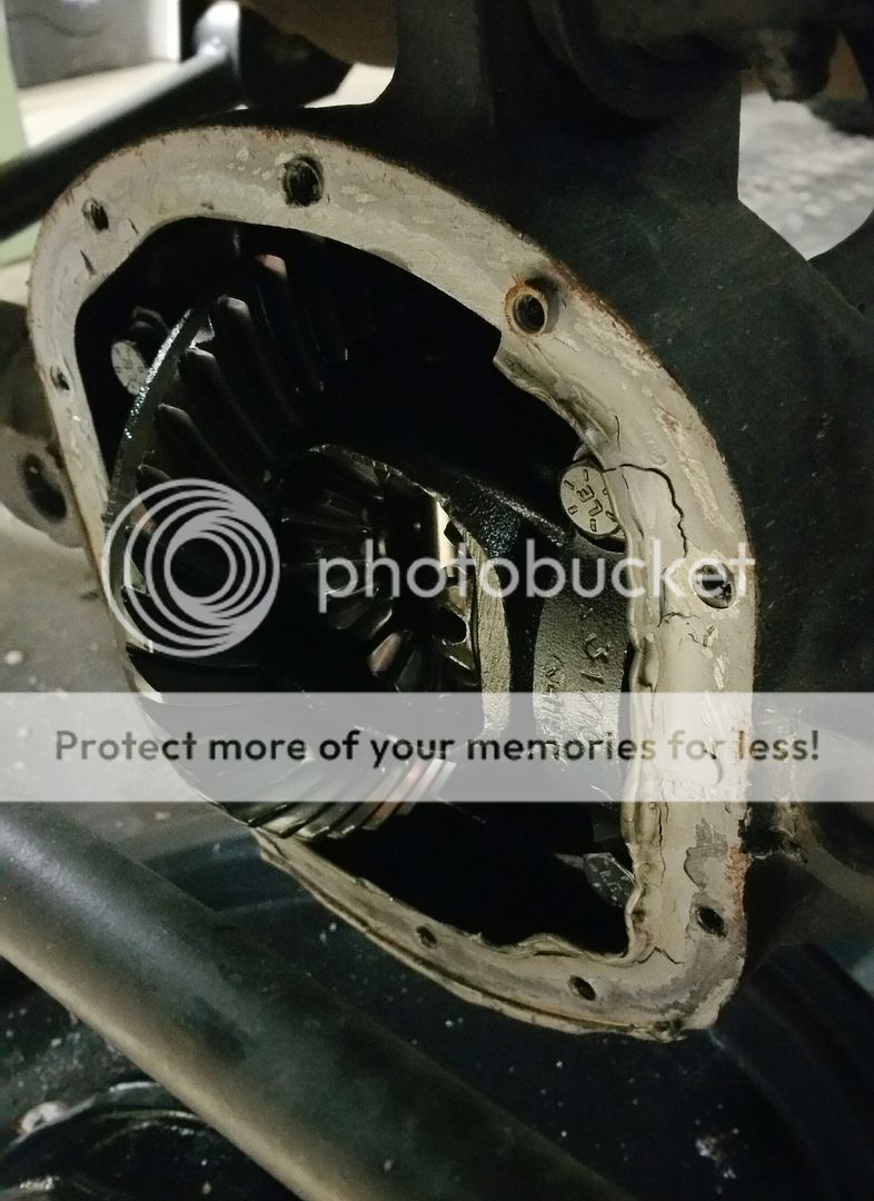

I saw that someone had removed the front diff cover. With how well this thing wheeled the few times I’ve been out I wondered if it may have a lunchbox locker. I didn’t find a locker but I did spy about a half a tube of silicone.

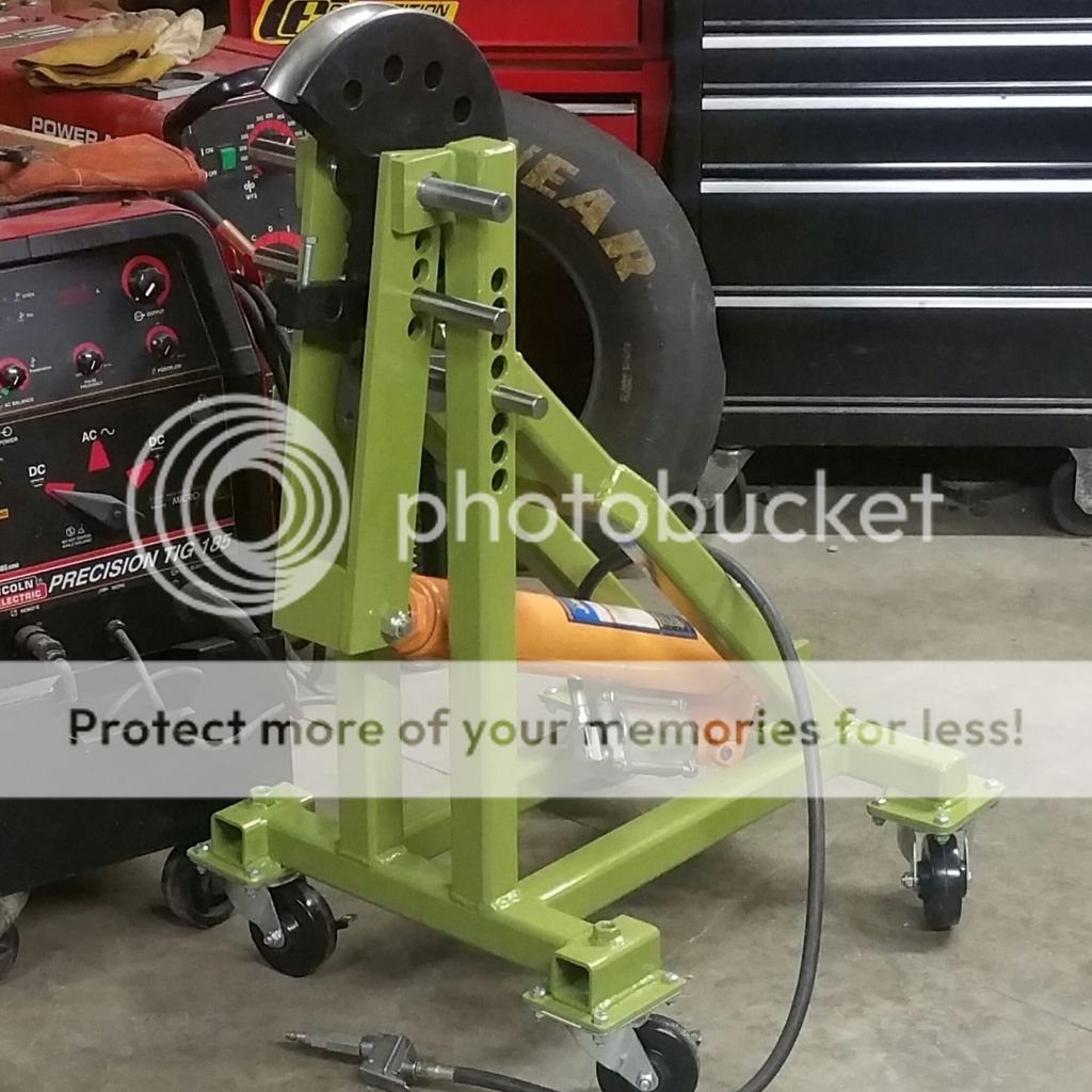

A couple family health issues + the winter holidays = no progress to date. I did, however, get my bender back from a friend. She needed some TLC, so I did some polishing, fixed the cylinder, added some casters and the nastiest paint I could find. Put a steel order in today also. I better get going!!

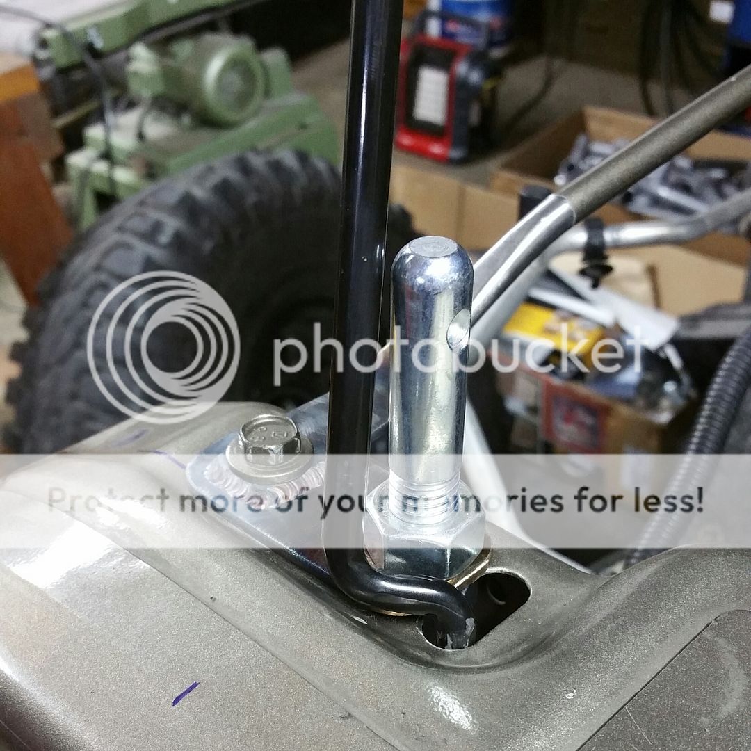

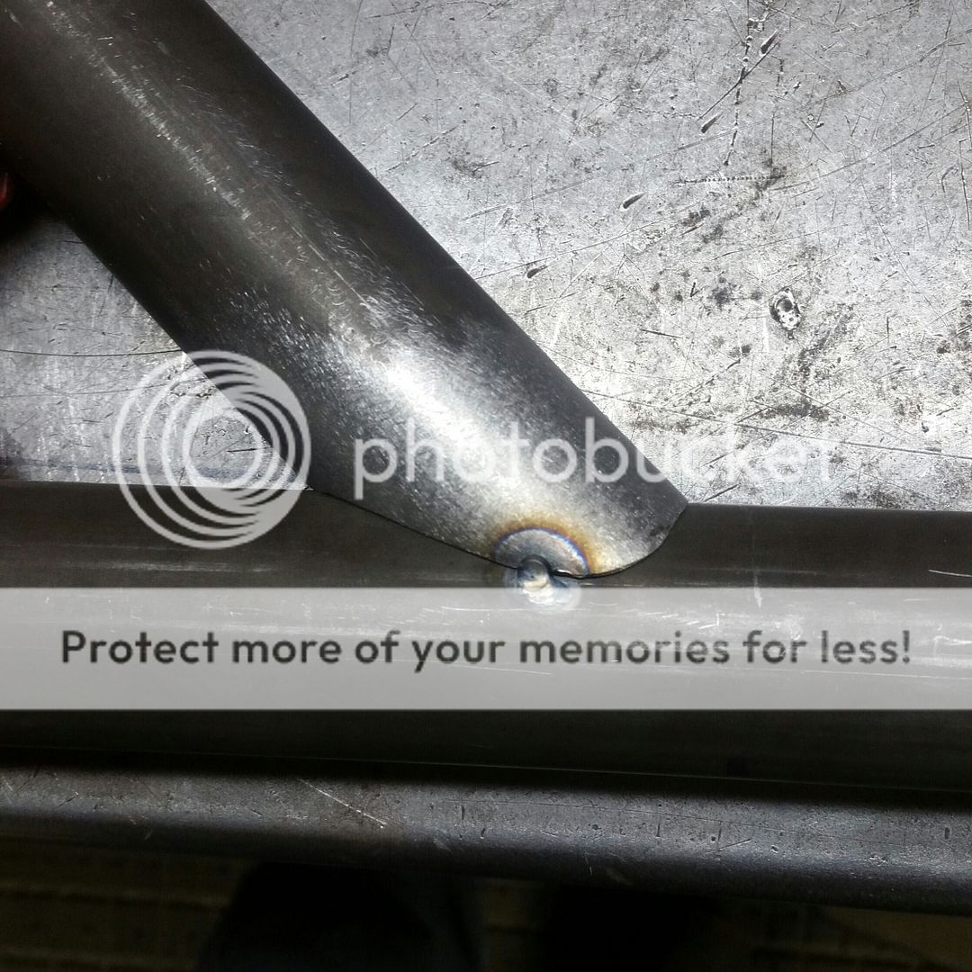

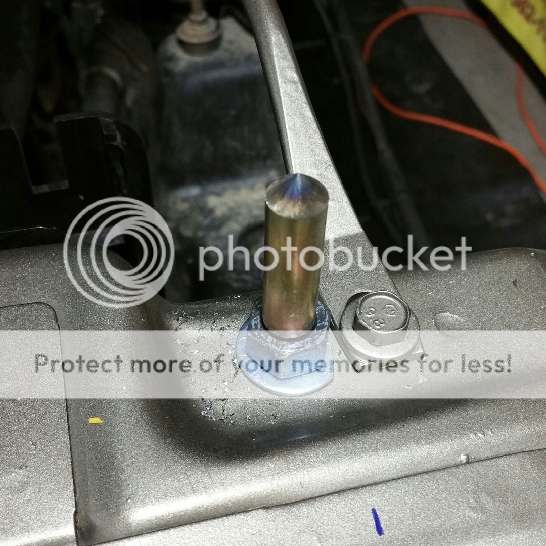

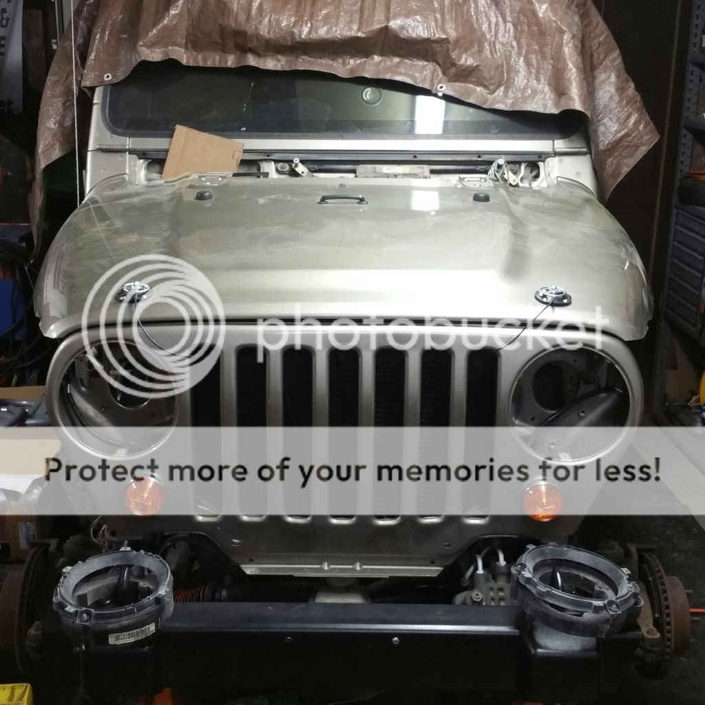

I started on the hood pins the other day. First I made these little deals to use as a center punch to transfer the location.

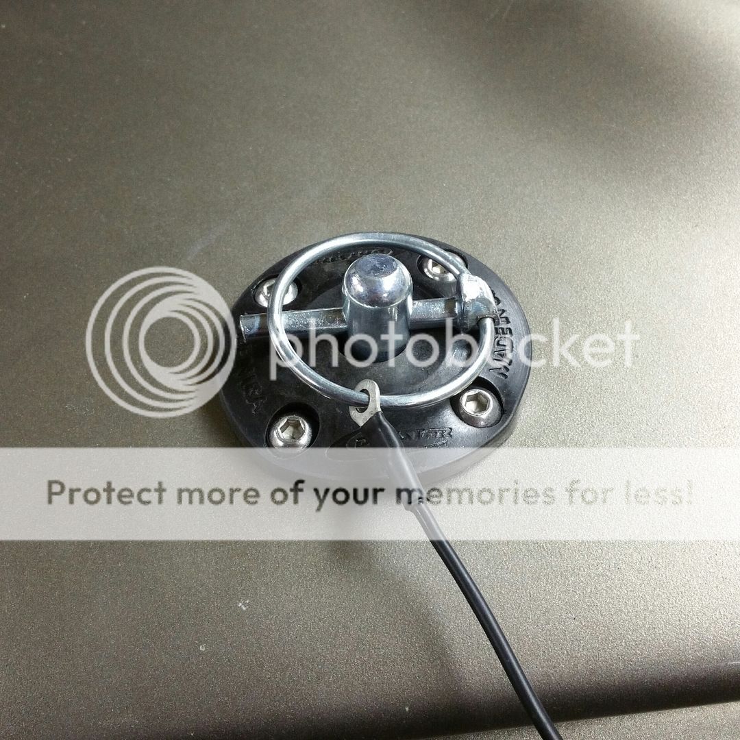

Next I welded these little pads to the bottom of the grill support rods just like the last time. I figured it gave the pins a little more meat to bolt to.
I added these little cables to the lynch pins so I don’t lose one on the trail. I’m not sure if they will stay or not. I don’t want a tree branch catching on the cable and pulling the pin out.
Hood pins and CJ-3B turn signals in but not wired yet….

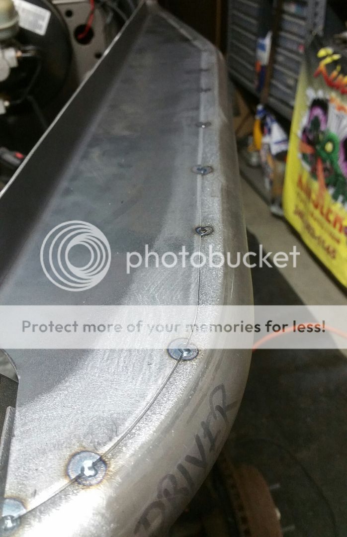

I guess I should update this thing. A few months ago I dumped my kayak on Lake Red Rock and unfortunately was dumb enough to still have my cell phone on me. It died, and so did most of my build pictures.

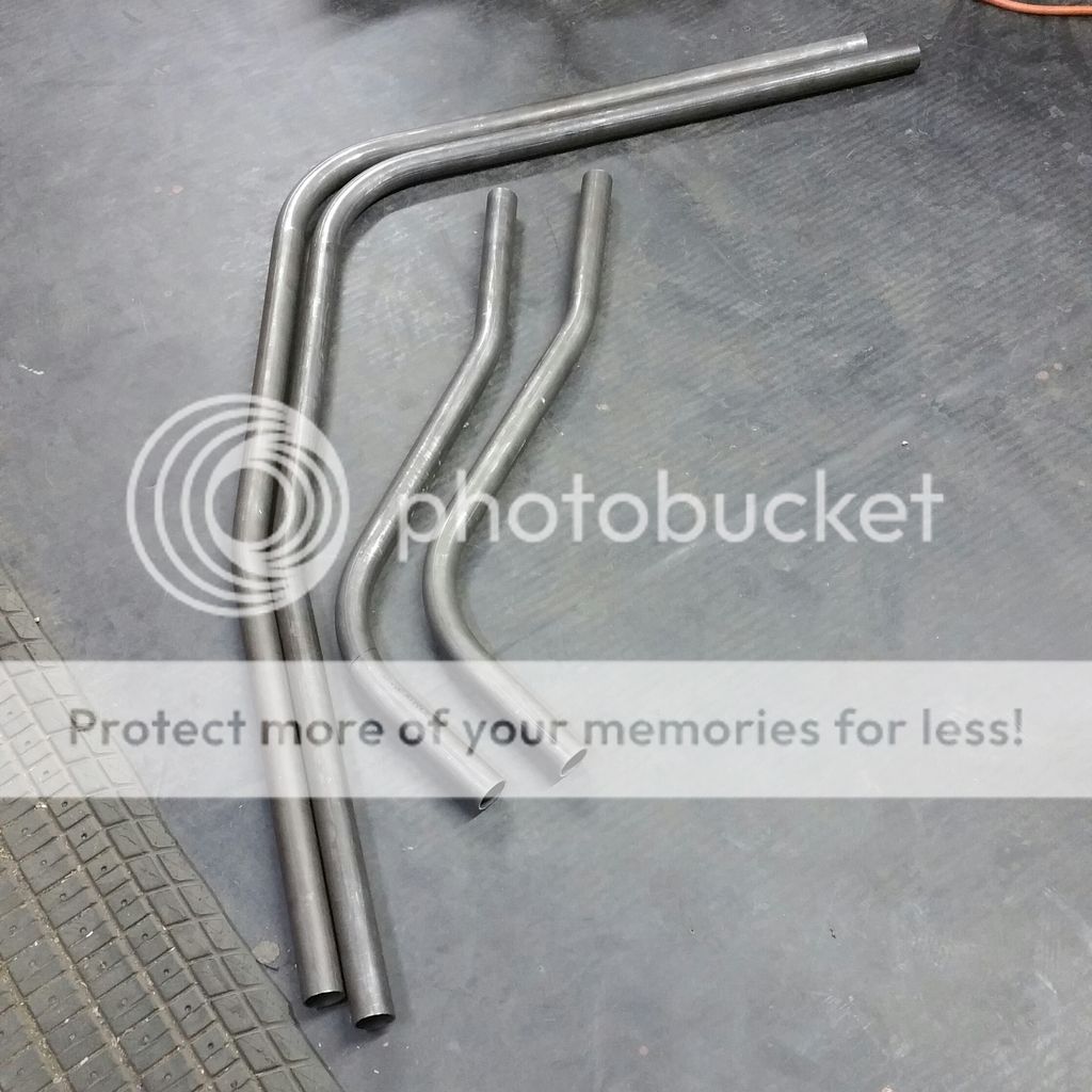

Getting bent.
I need a plasma cutter!

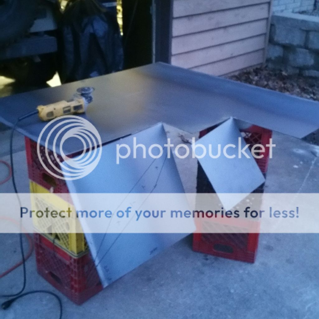

Sexy template.
I decided to TIG weld the fenders so all of my joints had to be perfect. I don’t think I would do that again. It took forever!

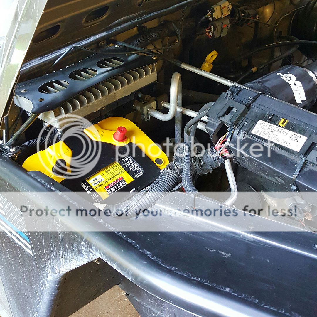

I relocated my battery using a mount from Artec. I also ended up having to relocate the computer so I could squeeze my battery in as tight as possible. I ordered a K&N air filter element and pre-filter from Summit Racing and just hacked the end off my stock air tube. This will just be temporary until I can get my inner fenders built.
