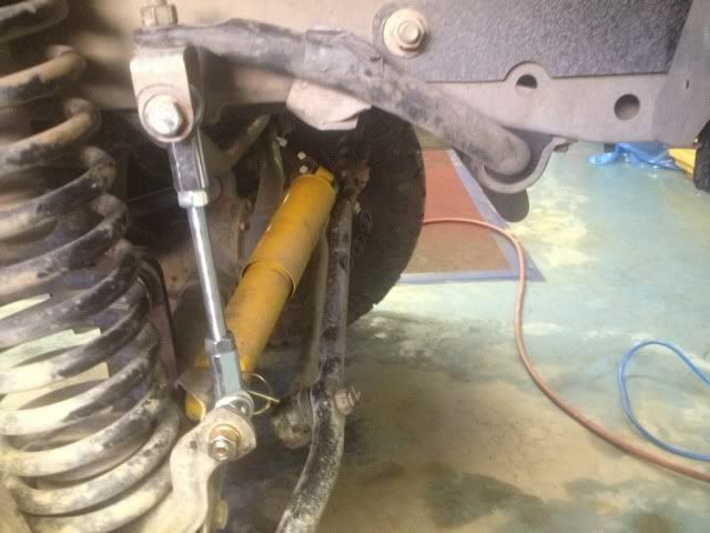

New homemade quick disconnects
New vs old:

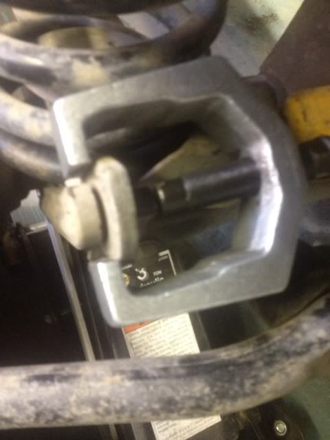

Pulling the old stud:

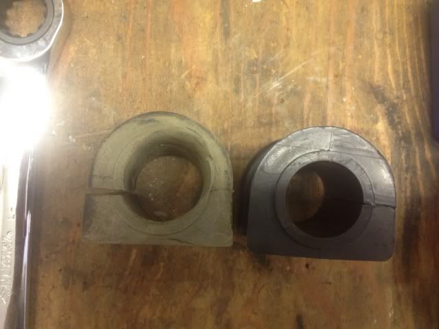

Replaced the old stud with a grade 8 bolt I rounded off, drilled and put a lynch pin in. Also replaced the sway bar bushing (k3171 moog)
Old vs new:
Poly spacers:

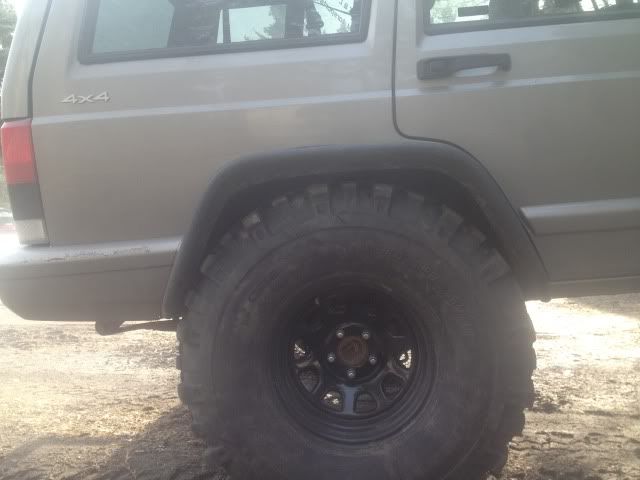

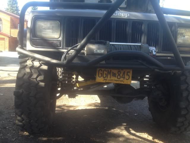

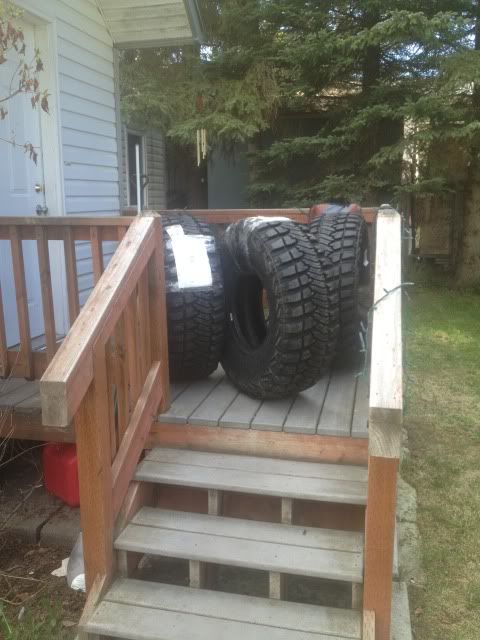

More stuff...
RE5.5" springs, RC shackle relocation brackets ,OME shocks all around and new tires
Ill be adding the RE5.5" rear leafs Monday or Tuesday
Old vs new tires

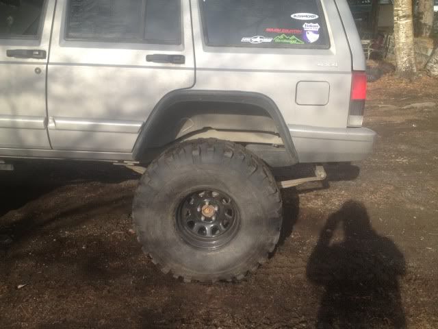

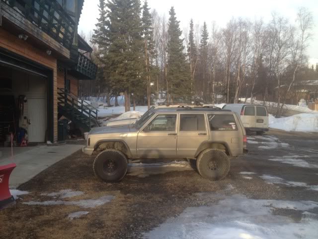

Tucked up real nice.
Stretched out nicely
I see a rear cut and fold in my future

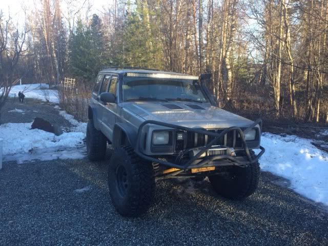

Some more pictures
The TSLs were horrible for all the driving I do so I swapped them out in favor of some 35" mtr/k

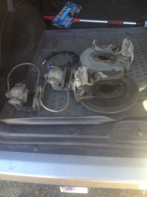

Also put together everything for a disc conversion in the rear
It's a never ending battle

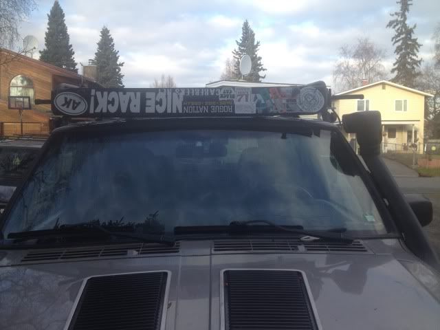

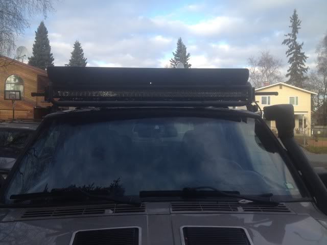

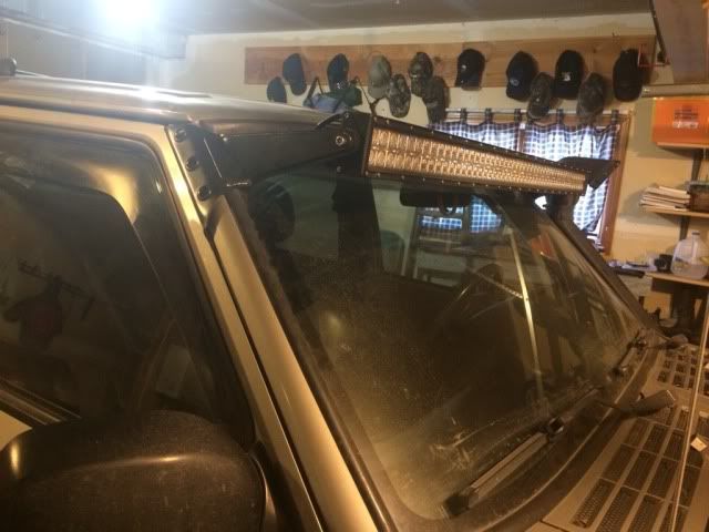

Added some lights
50" bar on the roof. So sneaky and offers a little protection when the light isn't in use
And flipped up
Duallys in the grill

Finally got the rear discs on.
It was not fun :-/
