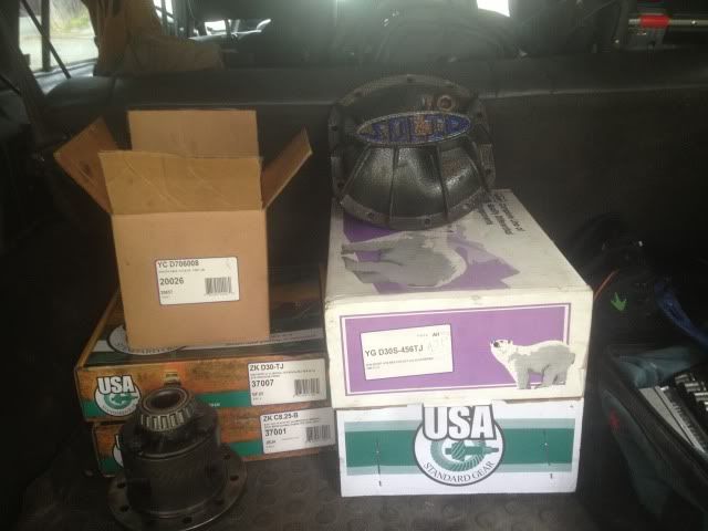

I have a Detroit for a d30 for3.73+, soild dif cover and a stock LSD for the 8.25. That should do just fine

Got myself a bday present
The stock traclok LSD I had for the rear was for a 27 spline c-8.25

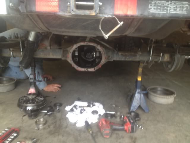

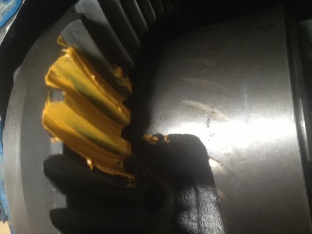

4.56s, lockers and did cover installed. A HUGE thanks the AKIQPiolet for helping with the install. Couldn't have done it without him or his expertise! Thanks again Tom
Rear
Had to grind a tooth down
Perfect
Rear Pattern
Front pattern
April 2014 & 2015 COTM

Good times Sam. What a great install we had. All new gears and bearings, all the races and seals replaced plus lockers installed. Everything shimmed, pressed, locktighted and torqued to spec. 4:56 gears and lockers in the front and rear. Pour in a little synthetic gear lube and off for a test ride. Took us 8 hours, start to finish. A little longer than I was hoping but we did everything by the book. Lash and preload are perfect. I am very happy with how it came out.
And by the way. One of the nicest XJ's I have ever been around. A very capable off roader with Leather Interior, Factory Infinity System, Outside Air Temp and a Compass. Add to that the Warn Winch, RE Long Arm, Bilstein Shocks, Super nice 35" Tires, Carpet Delete, all locked up and this makes for one super nice wheeling rig. My wheeling buddies were in awe at how nice this rig is. I can't wait to wheel together someday soon.

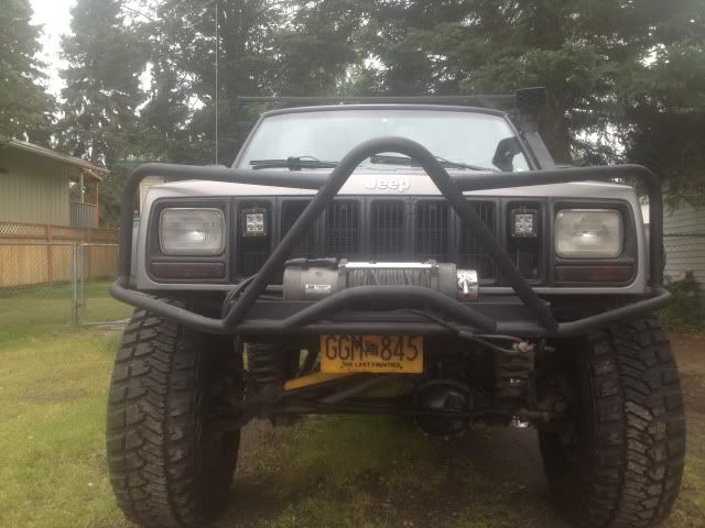

Boredom
Added a little light. I used Kevin108s thread to help me with the wiring. I used my stock fog light plugs and switch
