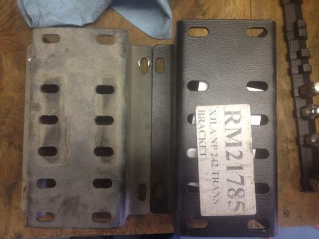

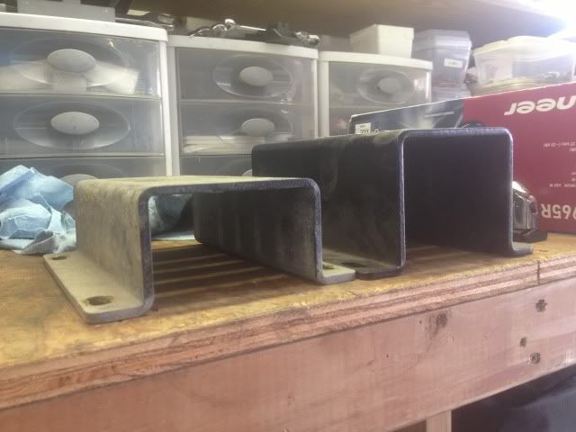

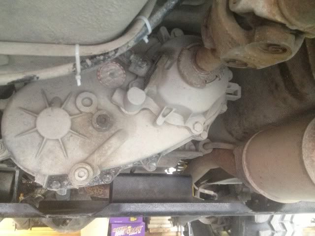

The parts jeep I got my RE lift kit from came with a NP231. After trouble shooting for the last 5 months I figured out the issue. The transmission mount from belly skid.
Old on the left new on the right
Sitting in place
I can shift into 4wd on the fly again! The damage to the tcase is done tho. I'm picking up another NP242 for $100 hopefully tomorrow.
