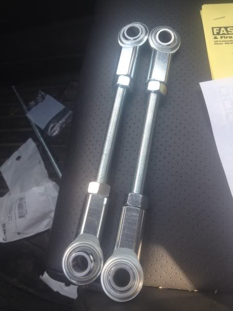

Making some quick discos. Just need to bolt them up
I cut up, rounded off and drilled some grade 8 bolts and stuck some lynch pins in em for the disconnecting part
Also bought a Warn M8000i today. Guess that means ill need a winch bumper

New vs old:
Pulling the old stud:
Replaced the old stud with a grade 8 bolt I rounded off, drilled and put a lynch pin in. Also replaced the sway bar bushing (k3171 moog)
Old vs new:
Poly spacers:
And done...

Really like then disco's. I could or a set of em soon! Should throw together I parts list. Help a brother out!!

(4) female 1/2" rod ends/Heim joints
1/2" Threaded rod. I cut mine at 7" each side. I bought 3'
(8) 1/2" nuts. 2 on each disco and 2 on each stud
(2) 1/2 grade 8 bolts
(8) 3/8" poly spacers. These will depend on your mounting points. I didn't want mine rattling around
I also had the top mounts from the old IRO endlinks so I didn't have to make or build those. I spent right at $55 dollars making them and they took about an hour. I used a tie rod end puller to remove the factory studs. They came right out with no issues.

boom thanks man!
