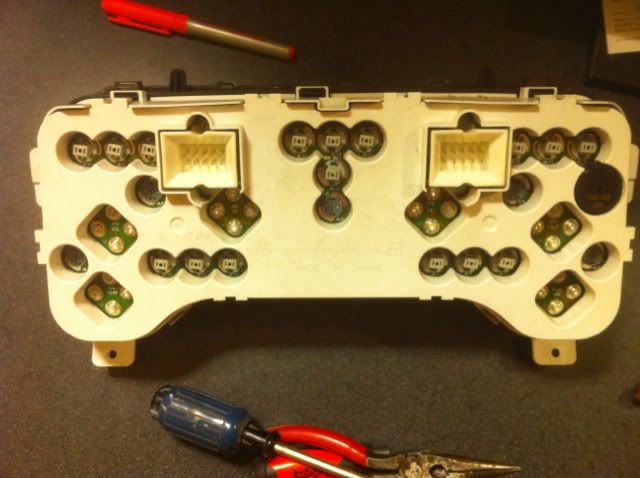

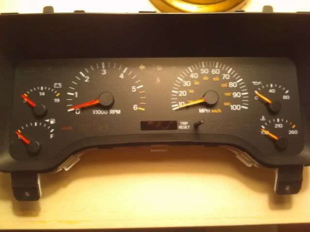

I upgraded all of my interior lights to LEDs, as well as my tail lights and rear plate light. I also used an orange sharpie on the gauge needles while I had the cluster out.
Here is a pic of the difference:
The ones I colored with the sharpie are on the left.
The LED swap is pretty easy. I did all of the interior including the HVAC controls and the switches for the defrost and rear wiper. The gauges were easy and the bulbs screw right into the back. The benefit of LEDs is that they draw much less power, operate at a cooler temperature, and have a more direct light which is good for gauges. They are also much brighter. LEDs also light up quicker than halogens. The difference is only a fraction of a second, but when on the highway LED brakelights can give those behind you more reaction time.

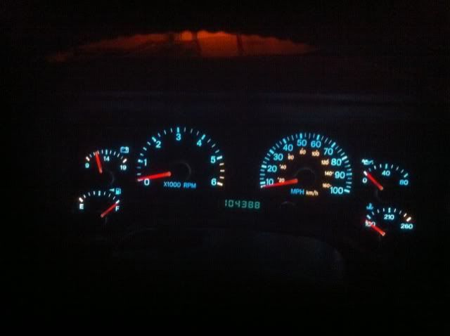

Here is a pic of the gauges at night with the sharpied gauge needles and LEDs. The LEDs are "cool white" in color, but the backing on the gauge panel gives them a blue tint.

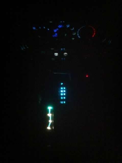

I also did the HVAC controls, T-case and tranny shifter, as well as the switches for defrost and rear wiper.

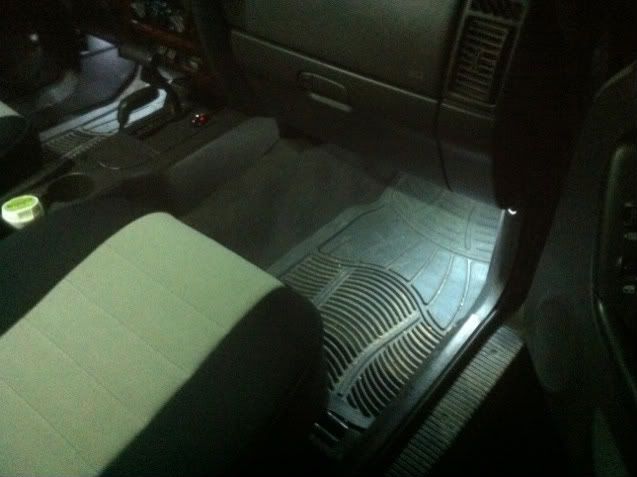

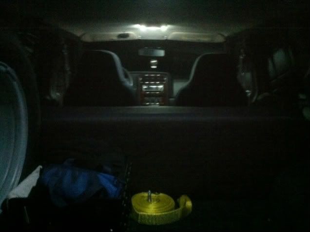

Here are some pics of the inside. Sorry about the quality my iPhone has horrible picture quality at night. The light is a lot whiter and much brighter. There wasn't even a bulb in the socket on my passenger side footwell.

looks great man! The lights for the tc lever and shifter look a bit bright though (or is that just due to the camera?).

They really aren't that bright, its just my POS camera. I notice that everything is a lot easier to read at night, since the LED light is more direct. I'll post the list as soon as I find it. I seemed to have lost the notepad I wrote everything on.
