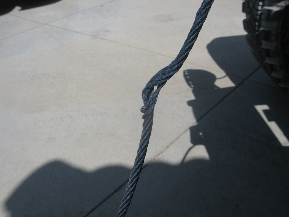

Well looks like my winchline is toast from that. This thing only has 7 or so pulls on it and I always took care of it. Now I just need to decide, Steel or synthetic.
Warn pulled like a champ. Steel winch cable and Optima battery didn't handle it so well
Cable is fine, you didn't spool it correctly. One hard pull should take care of it. Or buy another steel cable from somebody, that just has to have a synthetic winch line. I haven't seen a good reason to replace either steel cable on my winches yet. Both been used hard quite a few times.
Don't get me wrong a quality synthetic winch line is nice, but they have a terribly bad habit of getting bound up on the winch drum, makes it hard to spool out. Steel has worked well for me to date. Synthetic is nice when it breaks, just falls to the ground and yes I have seen them break when they shouldn't have. winch line was rated higher than the 9000 lbs winch yet it snapped without pulling real hard. Was a quality brand winch line too

Originally Posted by IEcrawlerTJ01 View Post
Synthetic
Hands down
Want to head back to bear next weekend anyone? I have been wanting to start the day coming up deep creek. Do Holcomb. Then head to John bull and run it the harder way
And the great debate starts. I'm a little torn which way to go still.
I'm thinking of going back and hitting Dishpan/Holcomb and maybe another trail if there is time. I was planning to hit Holcomb yesterday but that second obstacle really held us up.
I dunno, I spool it in properly every time. I make sure right before I winch that it is in there correctly as well. Yesterday at the end of the winching session i didn't spool it in correctly but I just left it loose.
Being able to drag it over rocks and stuff is nice, but steel can just be a pain in the butt sometimes.
Hmm.

Synthetic all the way for safety reasons alone
If you have ever seen a cable snap under tension you won't hesitate to go with synthetic
The weight savings and non hand cutting wire is just a bonus
I would have probably ordered the Viking line already if I had an extra $400 sitting around right now. You know how that goes.
For the time being I had an extra cable sitting in the corner of the garage so I just threw that on there.

You can look into someplace like this
http://www.reddenmarine.com/samson-r...blue-foot.html
You can buy it by the foot. Just need to splice it yourself but its worth learning
Thats a lot more reasonably priced and learning to splice it would be a must anyway IMO. I will save that link for when the time comes.
I'd also like to add a safety thimble to this as well. I like it a lot better then hooks.
That is my plan as well. I was watching a few youtube videos and it seems pretty straightforward
Thanks for all the info, I just watched a couple Youtube videos and splicing is pretty simple. I added up the cost and it looks like I'd save around $80 buying the Sampson Amsteel with a safety thimble and 8' rock guard vs just buying the Viking setup.
I'd like to learn to splice so when I do get a rope I'll probably put it together myself. I'm really liking this synthetic stuff .
