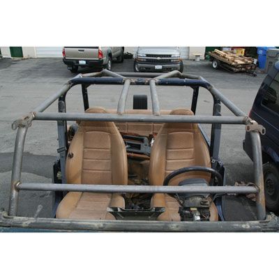

So.. cages. I've been looking at a couple options here. Seems like this is what I got.
Option A: Buy the Poly Cage, though it seems to me it has some compromises.
Option B: Fab shop build a custom cage... Expensive?
Option C: Build my own! Seems like this is an expensive route as well. I've been looking at the JD2 model 3 bender. Is that sufficient enough for 1.75" .120 wall tubing? Or will I be wishing I had hydraulic? The dies are pretty pricey too. From what I've been reading, it's pretty difficult to do right without bending software as well. I haven't even started looking at notchers.
I'd really like to build my own, but I fear it would be quite a project. I've never dealt with a cages or tubing before . On the other hand, building it how it should be done, the knowledge gained, the extra tools that I would have, and the satisfaction knowing I did it would be awesome. But, I know building a full blown cage tied into the frame and all is NOT cheap.
Sooo, any thoughts? In over my head? This isn't something I'm doing anytime soon, just brainstorming a bit. I'll be picking up some Corner armor here in a bit first.

I've been thinking along these lines lately also.... but I keep coming back to realizing that YES the aftermarket cages available do compromise.... but they also will provide MUCH better protection than the factory cage for a ONE time incident. If you are looking to build a cage that you can roll or even flop HARD and not have to throw away and start over you are probably over your head because you'd have to do something like Mike or Art has done. And at that point you are compromising other things. The Poly cage is about as good as it gets, and should allow you to wheel with confidence knowing that you've done a reasonable amount of reinforcing if you have an incident..... and you just have to not get cocky and realize that you shouldn't be hauling ***, or putting yourself in a situation where speed is a factor off road, along with the possibility for multiple rolls or wheeling any harder just because you think you'll be fine if you roll..... that will expose those compromises immediately. That's my line of thought on it right now.
I just want something that will keep me safe in the unfortunate/unexpected event of a rollover, Whether it be on the trail or getting there. It definitely won't change my wheeling style and I'm not going to try something I wouldn't normally just because I have a cage. After a roll any Jeep is going to be trashed anyways, so I'm not looking to roll it 5 times then push it over on its wheels and keep going
From the little understanding of cages I have, it seems like the Poly cage is pretty good that's why it's my option A at the moment. Maybe add a windshield V, tie it to the frame and add a little more triangulation in the back?
I'm not sure an "X" across the B pillar behind the seats or running doors bars would be very practical.

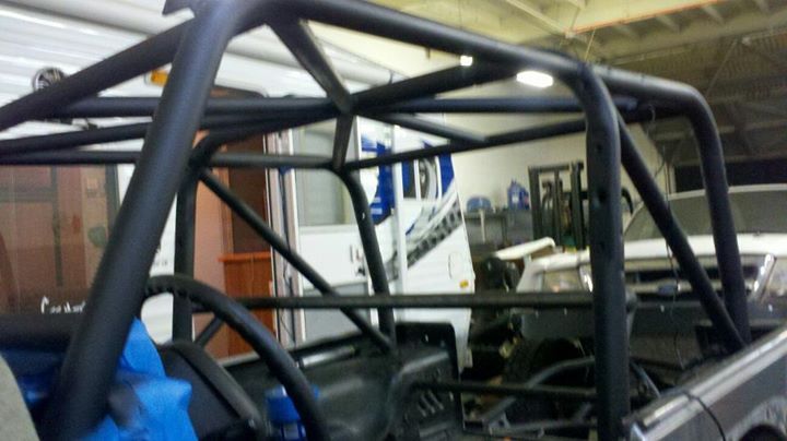

I think Lu has a good setup, his is even a little more than I'm looking for. I personally don't like the diagonal bars or a harness bar if there will be passengers, you don't want any tube that you can easily smack your head on in an incident. That's my personal opinion, I know people do it and have other thoughts on it. I get that belief from being into road and drag racing before Jeeps.... its a big no no in that world.
You want the tubes over your head as far away from them as you can if you look at the stock top you can actually raise them up quite a bit higher than the tube that holds the door surrounds. Some kinda triangulation on the top is good otherwise the cage will kitty corner in a flop or roll and tweek the whole tub. If you do not carry passengers in the rear some kinda cross or triangulation of the B pillar is good. Cage tie ins for the A and C pillar is a good thing also.
No passengers here, so that's not a real concern of mine. I just need it to be somewhat practical and work with the soft top.

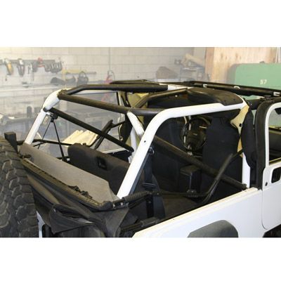

If I'm understanding right, it looks like the Poly lacks triangulation overhead. If you land hard on the side, the door surround bar area (for lack of a better term) is going to cave in a lot easier.
Triangulated overhead bars.
Another thing I notice with the Poly kit is it seems like it has a lot of unnecessary bends?
Doing a cross/triangulated B pillar seems like it's pretty much impossible in the stock location.
Here's my thoughts as of right now... Driving like you have no cage is the best cage. You can put in a compromised version of a cage, but don't rely on it to keep you safe. Honestly after reading the TJ cage thread, I'm not sure what I want

Well at the very least... get some kind of A pillar bar in there. Every flop or roll I see with out one, the windshield is instantly demolished and usually caving in towards the passenger compartment.
