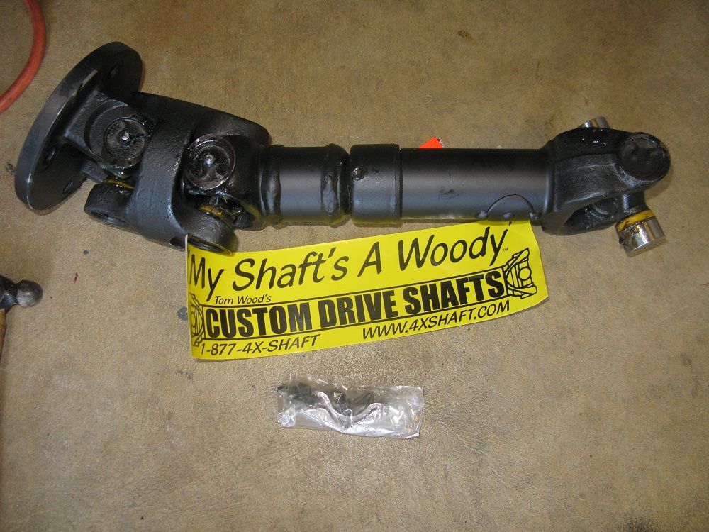

I recieved my Tom Woods 1310 Rubicon driveshaft today. Mine doesn't look very nice, The paint is flaking already. Oh well, it's a tool not a jewel right?
I finally go to put it on and fine tune my pinion angle when the U-Joint wont seat into the pinion yoke. So now I have to call TW and see what to do. It sucks because I had a wheeling trip planned this weekend. Guess that's not going to happen. I guess project "Longest build on short arms ever" lives up to it's name . This has taken me wayy too long!

Originally Posted by Moabrubi View Post
The black cloud keeps following me .
The U joint cups are to big or the U joint is a hair to wide?
The latter is normal a good tap with a hammer on the cup that does not want to seat will settle in place or try to squeeze the cups together with a C clamp
I can get one cap fully seated, but the other one is roughly 1/4" away from seating. It doesn't look too wide. The caps look like they will clear the centering lugs but maybe I will try the C clamp and see what happens.

If you squeezed some grease in there then that's what happend. What did you spec it with? a 1310 or a 1330 U joint? Rubicons normally use a 1330 U joint
I didn't squeeze any grease, it came all greased up... With ALOT of grease. I just tried the C clamp and no dice. Couldn't get enough power with the little handle. I guess I will try the hammer method tomorrow and see what happens. I'm still not sure if it's the width of the joint though.
TW reccomended a 1310 U-Joint so I wouldn't get any binding with the steep driveline angle. I believe it still uses 1330's at the double cardan on the T-Case end.

Well a 1310 U joint should fit , those are not as wide as a 1330 U joint. If all else carefully pull the cups off and take some grease out or try taking the grease fitting out so you can squeeze the grease out
I'll probably try that too. But I'm just not 100% sure if the width is the issue. Looks like it will clear just fine .
Tomorrow I'll take a closer look at it. Width of the joint, size of the caps etc. compared to the stock driveshaft. The stock driveshaft slips in with no problems at all.

New U joints tend to do that, good wack with a hammer on top of the cup that sticking out generally seats it in the yoke no problem The diam of the cups the same as the stock U joint?
Never mind.. got it! I took it off and got my biggest C clamp. Cranked down on it real good and it went in like butter. Looks like when they greased it the caps popped out a little.
