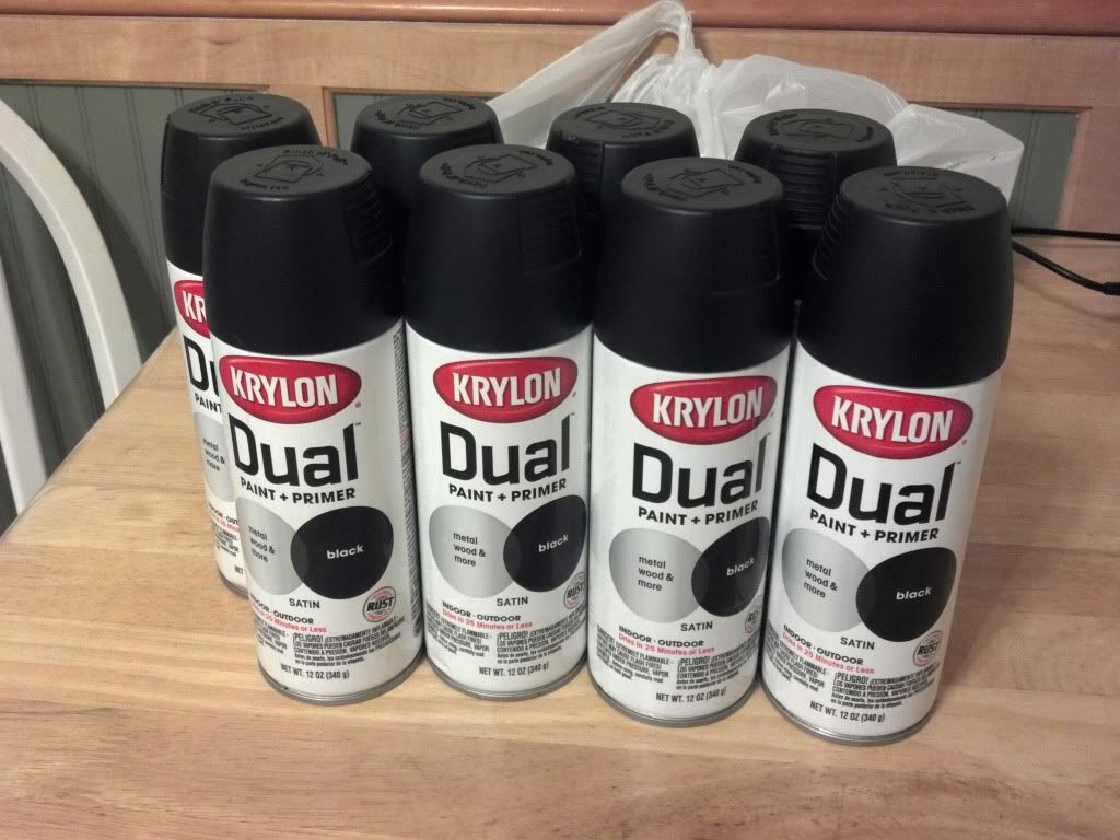

Picked up $40 of paint
Hell yeah. That's exactly how many cans it took to paint my whole rig. That paint just plain kicks ***.
I might need more haha. I'm painting corners, rockers, the back half (probably the rest of the frame while I'm at it), axle, control arms belly skid and center crossmember, CO hoops and mounts, and the wheel wells. I'll also have a front bumper and front fenders to be painted in a couple weeks as well so I'm pretty sure I might need a couple more cans. The biggest waste of paint is trying to paint tubing, about 3/4 of the can ends up as overspray on the ground and not on the part lol.
