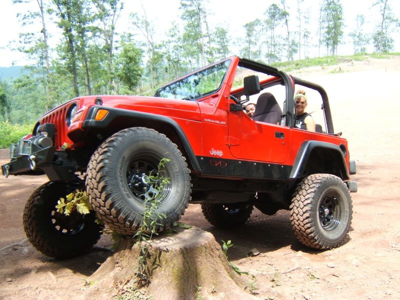

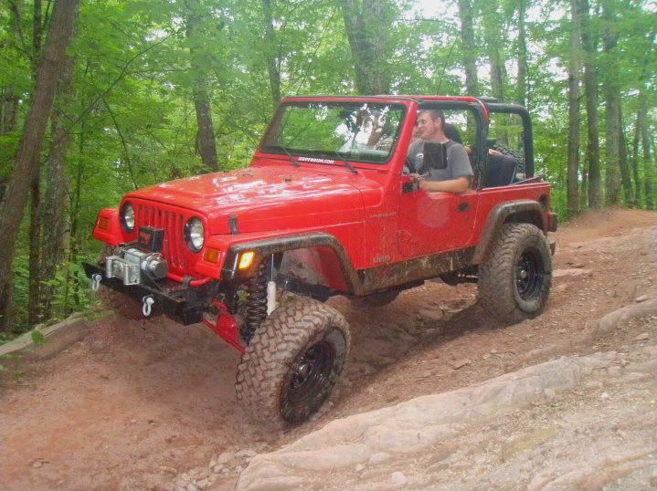

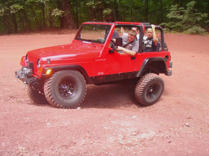

Here's a couple of pics from Greenridge today. Had a few friends that kept bugging me for a jeepin' trip and today was the day. I have a lot better pics that i need to get off my friends camera.

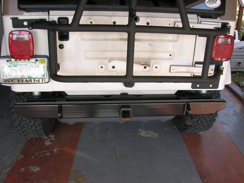

Okay, so here is what i'v been debating over and over again for quite some time now. Probably since i built the front bumper in december
My question is, do i build a traditional swingout tire carrier/bumper for the rear like every other jeep out there, Or.......
try and build something very similar to the T&T customs replacement rear crossmember and fab a custom tub mounted tire carrier.
Pros: Better departure angle, less added weight possibly, and it doesn't look like every other rear bumper on every jeep going down the road.
Cons: Will definitely be a little harder to fabricate, Have to figure out how to mount the gas tank skid as well as the body mounts since the stock rear crossmember serves both those purposes.
T&T replacement crossmember
