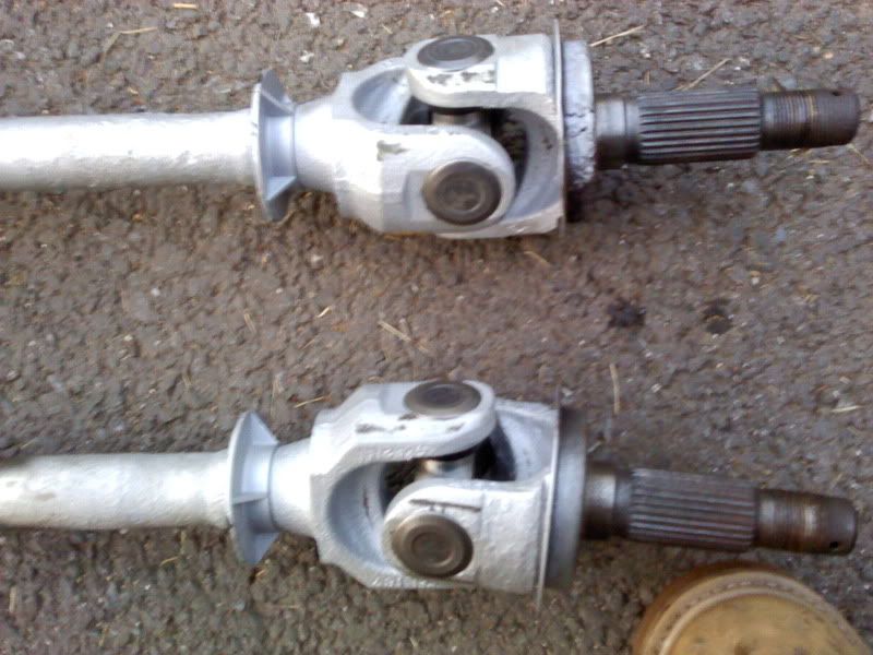

Freshened up the D30 a little today. Repainted the axle housing and the diff cover. Also straightened up my passenger UCA mount and reinforced it a little as it looked like it was starting to get tweaked slightly.
New U-joints came and I installed those.
