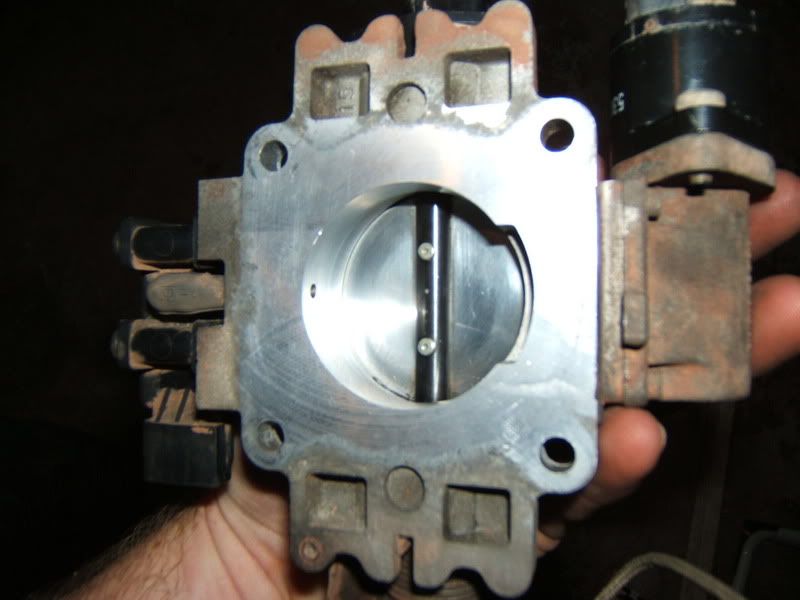

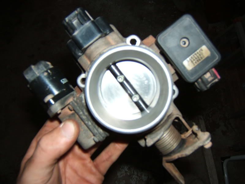

So i started by removing the air box and intake to get some room to get at the throttle body. My throttle body was pretty dirty so I pulled it and cleaned the entire thing. Also cleaned all the associated sensors
