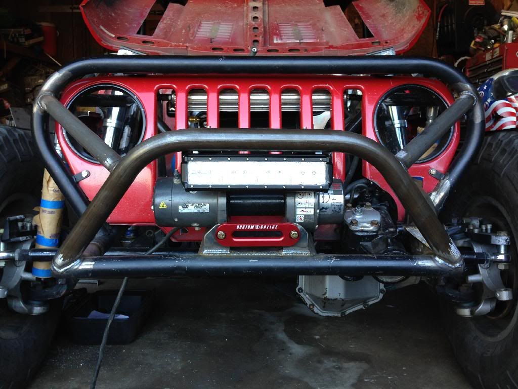

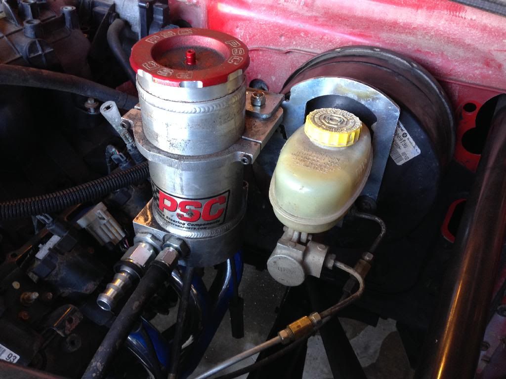

Just working on those small things that seem like they take forever and don't really look like much in pictures like figuring out wiring and plumbing routing and finish welding.
Modified the power steering reservoir mount and ordered a few new fitting for that. Working on a heat shield to bolt to the reservoir to deflect some heat from the engine and headers.
LED bar mounted. Steering cooler is mounted too, you can see it behind the grill.

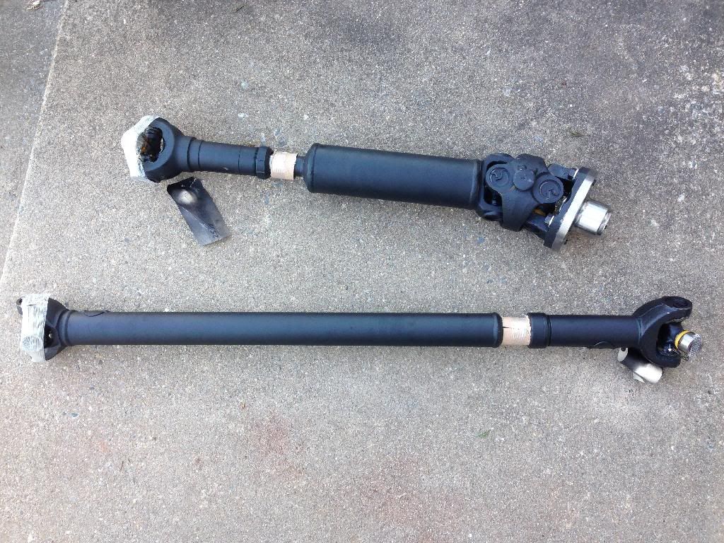

Got my 1350 driveshafts.

Who did the driveshafts? Do you know how much angle that CV is capable of?
1 ton yj is offline
post #5100 of 6493 Old 04-01-2014, 09:25 PM Thread Starter
MO2500
Location: Denver
Posts: 7,191
Tom Wood shafts. The CV binds at 30*, I also am swapping my 1350 CV yoke out for the 1350 flange because they advised me that the flange style is capable of about 5* more than the CV yoke (only about 25*) I was going to use and have on the Atlas now. The flange is bolted to the shaft in the picture.
My working angle of the CV is right around 23-24* at full droop so should be well within the operating range of this shaft.
