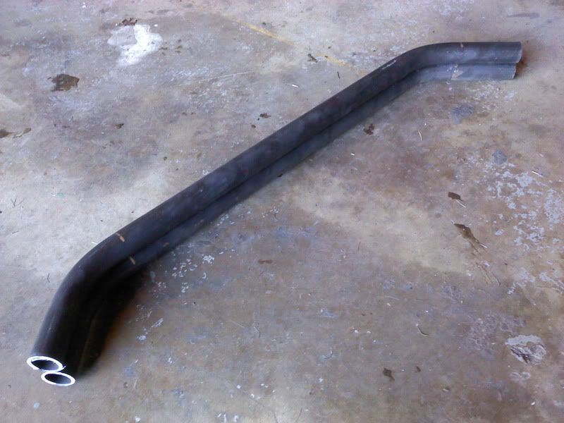

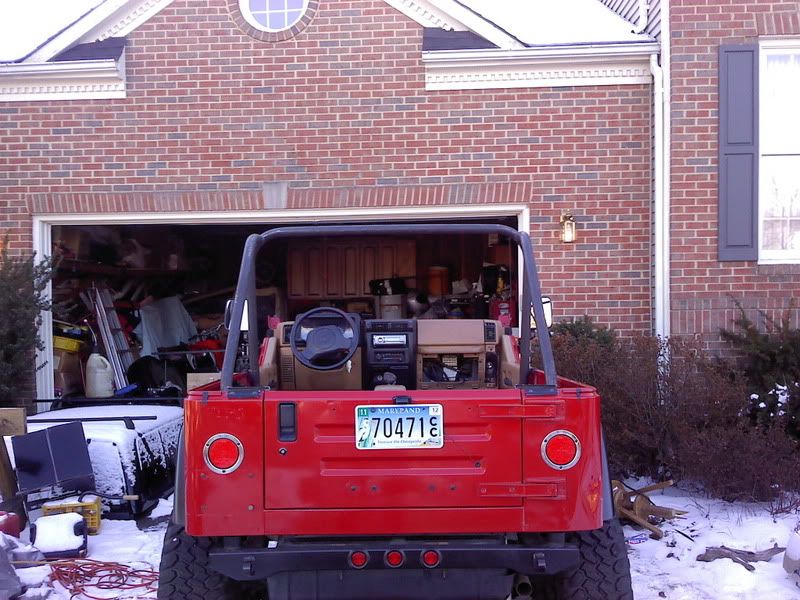

Rolled the jeep outside. Looking pretty cool with the chop top and single hoop haha
Was able to duplicate the bends on both c-pillars almost perfectly. Loving this Pro-tools bender and Bend-tech software makes it easy.

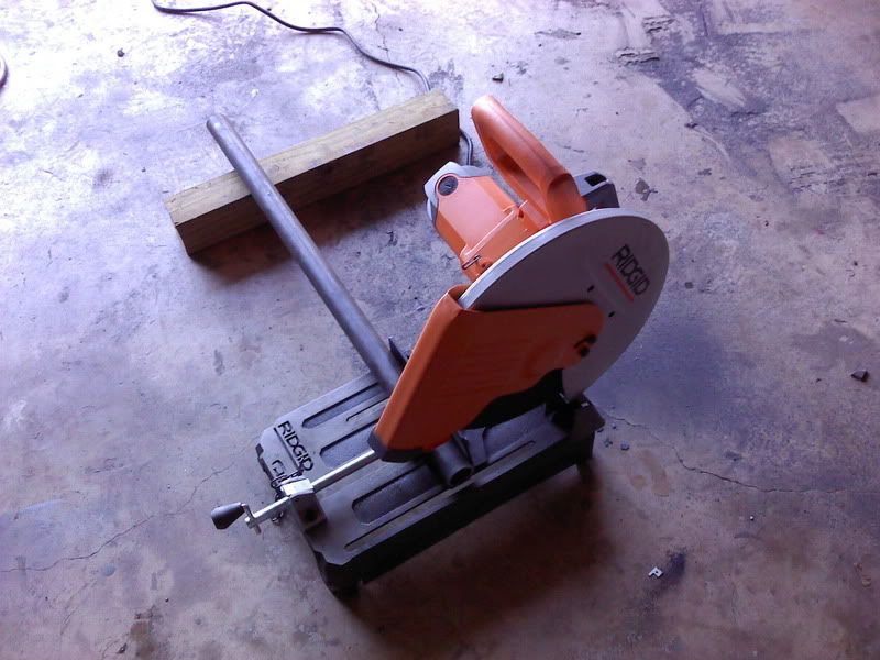

New saw cutting tube like butter

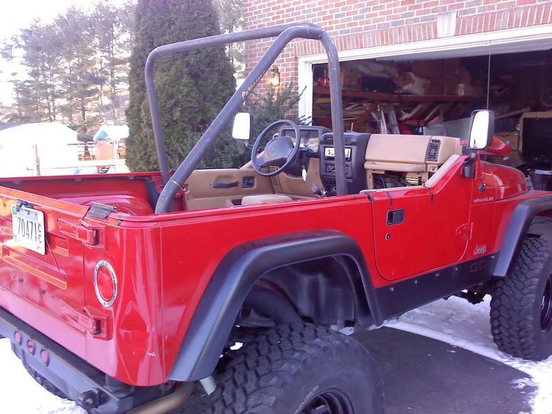

Started working on fitting one side
Both sides fitted and just sitting in place. still want to work on the fit a little before I tack them in.
