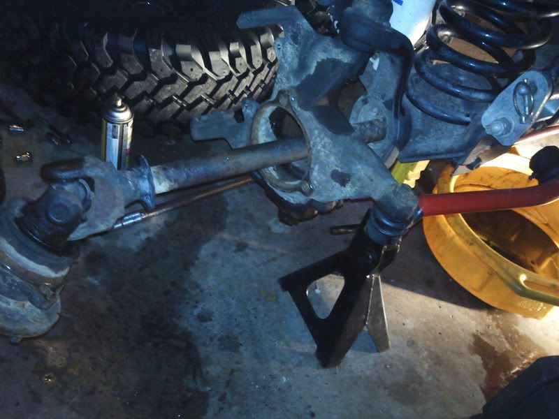

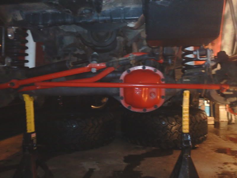

Well saturday i finally got around to installing my Aussie locker in the D30. Install went pretty smoothly and i didn't encounter any significant problems other than it being frickin' cold in my garage The little electric heater i have barely helps so i'm really hoping spring is right around the corner
Here is my step-by-step of the Aussie install. I took a lot of pics while i was doing it and figured i'd just put them all together into a little write-up. I apologize if some of the pics came out a little blury. My camera was acting a little funny and lighting wasn't all that good
First step is to raise and support the front of the Jeep and pull the tires off.

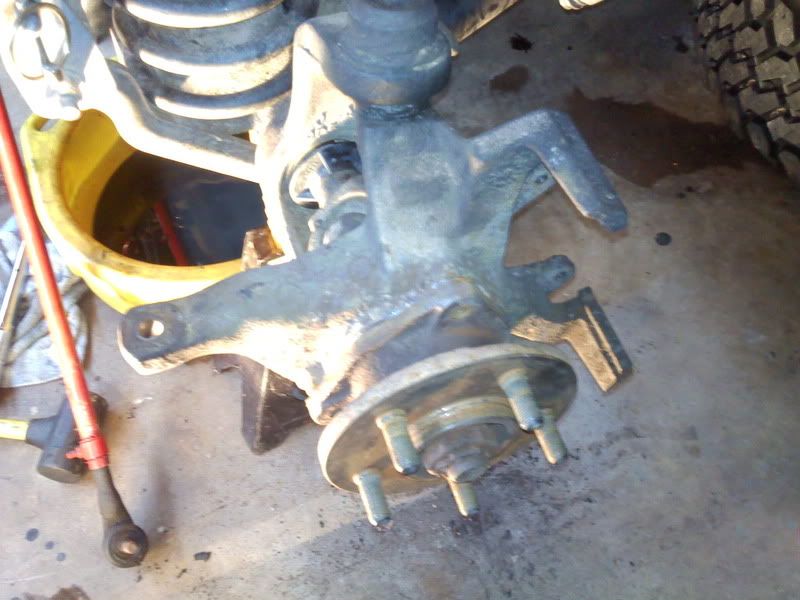

Next I pulled the drivers side TRE loose from the steering knuckle to allow better access to the D30 housing when pulling the carrier. Since i have 4.88 gears, the cross shaft will not clear the ring gear. So, i must pull the carrier and remove the ring gear to remove the spider gears and install the aussie locker. To do this, remove the cotter pin and castle nut from the TRE ball stud. I like to tread an old nut on almost flush with the stud and then tap on that carefully with a hammer to knock the joint loose and avoid damaging the threads. A tie rod end/ball joint separator would work better.
Time to drain the fluid and remove the cover. Remove all the cover bolts leaving the very top one loosely in place. Now, with a drain pan placed underneath, pry the cover open at the bottom and let the fluid drain into the pan

Once thats mostly drained you can go ahead and remove the cover completely and set it aside. Now onto pulling the axle shafts. First order of business is to remove the 2 bolts retaining the brake calipers and then zip tie the calipers to the frame, up out of your way. Then there are 3 bolts on each knuckle holding the unit bearing and axle shaft in place. They are 1/2" 12 point bolts and you can't miss them. Once you remove them your axle shafts and unit bearings should be free to come out but may take a little persuasion with a mallet if they have been stuck in there for awhile (mine were pretty stuck but i eventually freed them up with a few carefully placed blows). You can then pull the short shaft on the driver side
and the long shaft on the passenger side

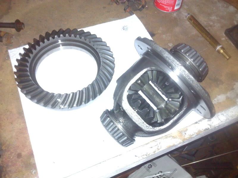

Now you can remove the carrier. One way you can do this is to place a rag between the pinion and the ring gear and turn the yoke with a wrench forcing the carrier out. You can also carefully pry the carrier out making sure to use a rag or something so you don't mar up the housing gasket surface. It's important to keep a hand on the carrier when doing either because you absolutely do not want to have the carrier and ring gear fall out onto the hard concrete or whatever surface your working on, possibly damaging the carrier bearings, ring gear or carrier. Also very important is to not allow the carrier bearing races fall out onto the floor becoming damaged or mixed up (keep track of which side is which so you can install them with the same bearing they came off of).
Now is a good time to go ahead and clean up the housing of old gasket, gunk and grease. I like to try and keep everything i'm working on clean as possible and i can also go over everything visually to check for any damage.

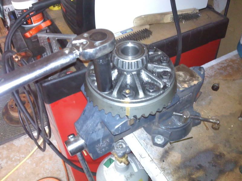

Next step is to remove the ring gear from the carrier. Use your paint pen or sharpie and mark the orientation of the ring gear to the carrier so that they can be reinstalled in the exact same position. Then you can secure the carrier to your bench top and remove the ring gear bolts

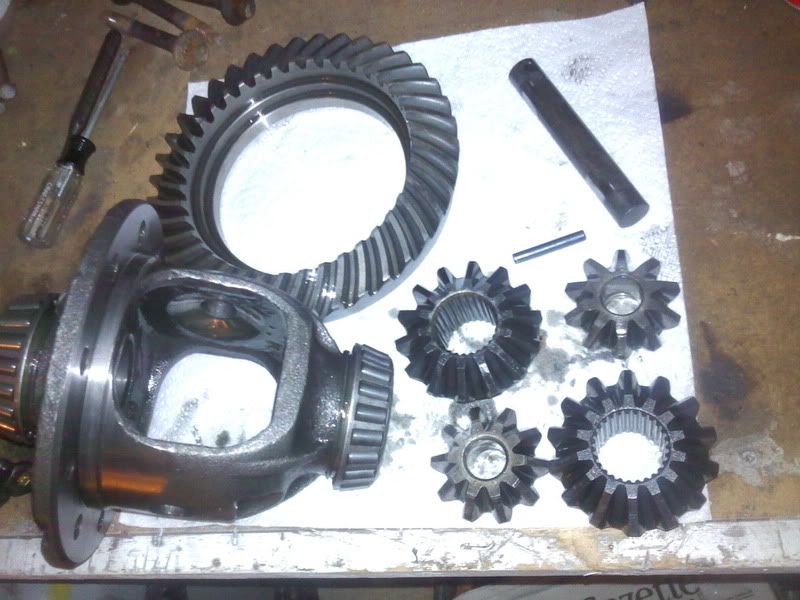

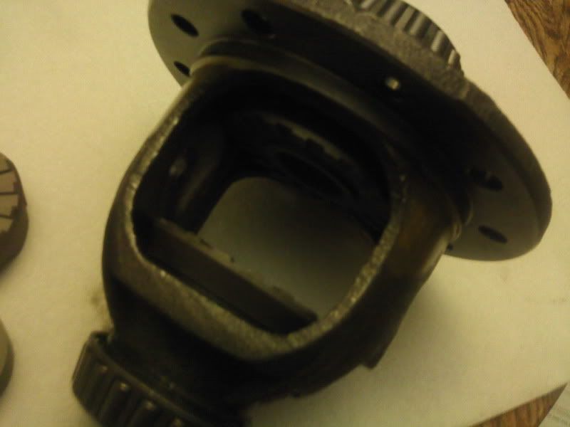

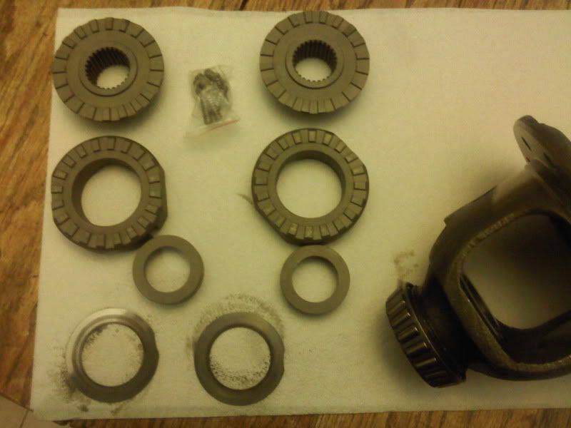

Now that the ring gear is finally out of the way you can remove the cross shaft and pull out the stock spider gears. On the D30 there is a small roll pin holding the cross shaft in place. Tap it out through the hole with an appropriate sized punch. Then tap out the cross shaft and remove the spider gears. There is thrust washers on the backs of each of the spider gears and side gears. The thrust washers on the side gears will be re-used with the aussie locker, so pull those off and set them aside.
Now, with a clean work space and the carrier cleaned up, lay out the parts for the aussie locker. Including the 2 thrust washers from the stock side gears (provided they are in good condition).
Exploded view of the Aussie locker (minus the springs)
Now, begin by placing a thrust washer on each of the side gears for the aussie and put them into the carrier
Following the directions that come with your locker, continue installing the parts of your locker into your carrier. They recommend using some heavy axle grease to hold the small pins in place as you insert the pieces into the carrier.

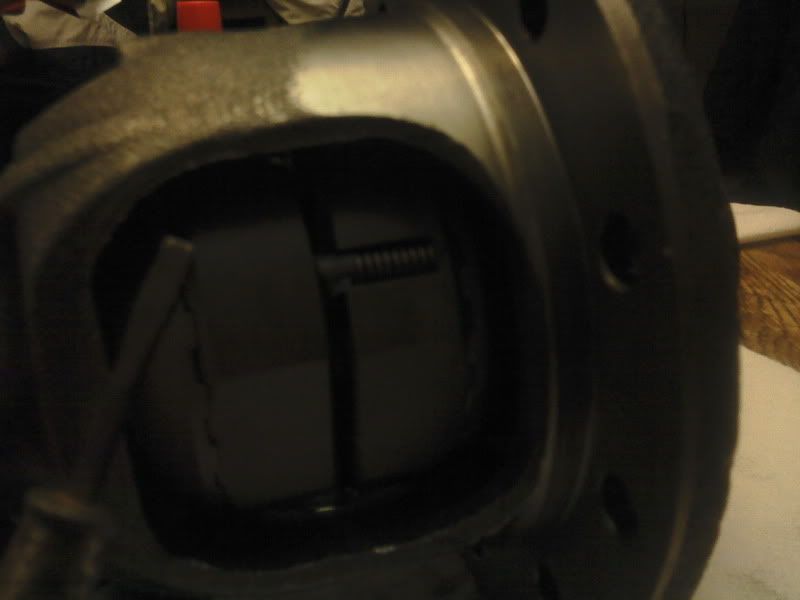

last parts of the Aussie locker to go in are the springs. I found that a small flat head screw driver worked best for finessing the springs into place (be careful not to loose them).
You can now rotate the aussie so that you can reinstall the cross shaft. Then drive the roll pin in to hold the cross shaft in place
Installation of the Aussie locker into the carrier is now complete
Now you can reinstall the ring gear. Hopefully you marked the orientation of the ring gear to the carrier before removing it. Make sure its back in place and seated properly before evenly torquing the ring gear bolts to spec in a star pattern (use some red loctite here).

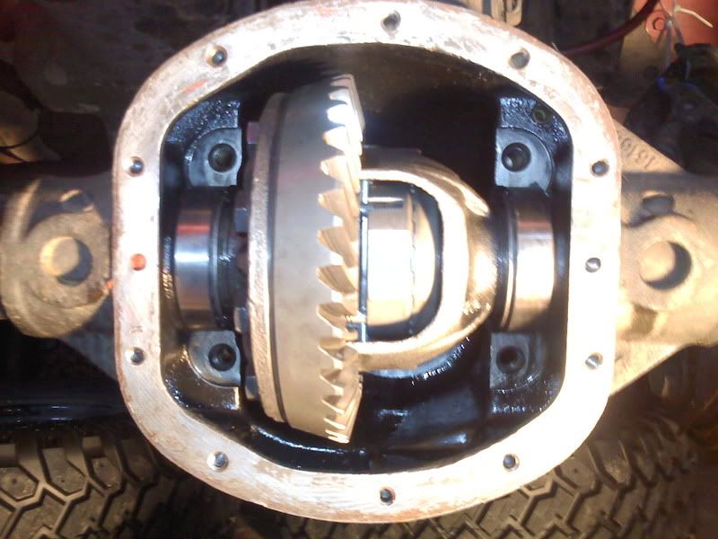

Now, place the carrier bearing races back on the bearing making sure they are on the bearing they came off of (hopefully you didn't mix up the left and right cap). With the carrier squarely in the housing, gently tap the carrier back into place with a rubber mallet. Don't try to beat one side in and then the other. You don't want to damage the bearings or the housing so make sure its lined up correctly and don't just whale on it.
Once you've got the carrier back in the housing reinstall the bearing caps the same way they came out. evenly torque them down to spec. Make sure everything is clean and then clean it all again. You don't want to introduce dirt and/or debris into the bearings or gears. I also just felt the back lash just to make sure nothing screwy happened. Still felt good (very slight movement between the ring and pinion gears). If you were careful there is no reason your gear setup should have changed at all and you should be good to go
Next you can reinstall the axle shafts/ unit bearings. Carefully slide the axle shafts into the housing as to not damage the inner axle seals. You may have to rotate the shaft a hair to get it to slide into the splined portion of the new Aussie locker. Torque your hubs to spec.

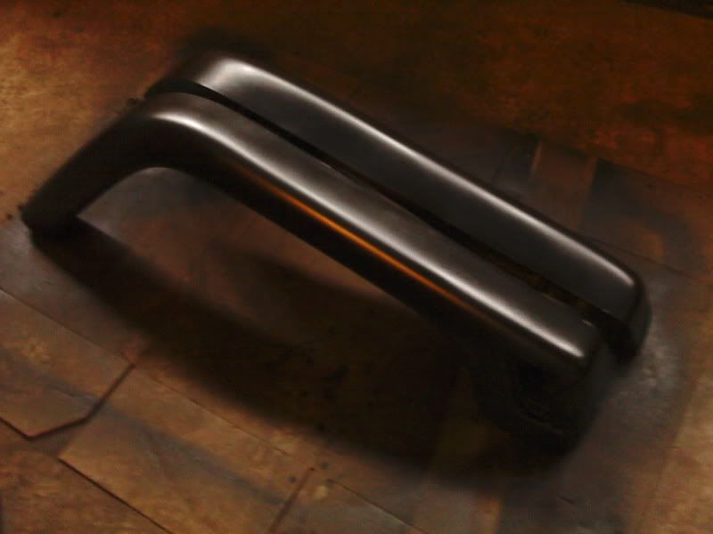

Updates have been slow recently but now that I'm on spring break I am finally getting to do a few things on the jeep

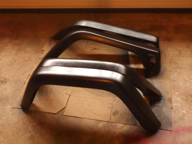

Today I pulled my faded stock fenders off and preped them up for a fresh coat of krylon fusion.
Fender-less?
Got the fenders painted but will have to wait till tomorrow to get them back on. Sorry for the crappy cell phone pics.

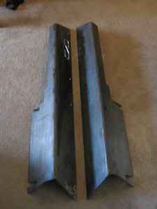

Also, over the weekend I picked up some new rocker guard made by DND products. I found them for a good deal on craigslist in bare metal so i picked them up to replace my large frame mounted sliders/steps. I'll have to try and get them installed soon.
Here they are bare metal
And I also primed and painted them today while doing the fenders. Satin black to match the bumpers and flares

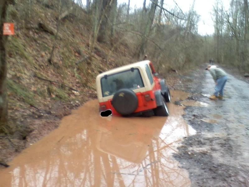

Also pulled out my friend in his YJ. Don't be mistaken by what looks like a little puddle. There was muck above his axles and he was stuck pretty well
