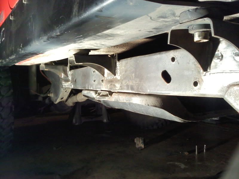

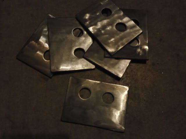

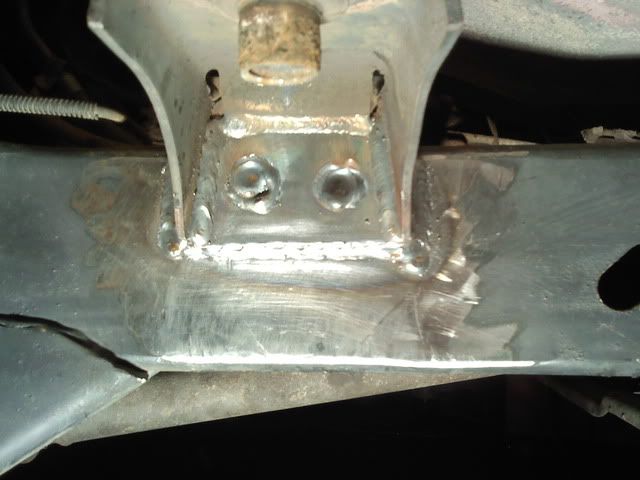

Worked for a couple hours more on the BL today before dinner. I made these plates to weld the body mount to and then weld the whole thing to the frame.
These did a few of things:
- Allow me to raise the mount high enough (1.25") and still be able to weld the top of the body mount to something.
- Maintain the same distance for the body mount in relation to the frame because I lost roughly 3/16" cutting the mounts off the frame and then grinding them so they would sit flush again.
- Doing it this way allowed me to weld all the way around the body mount on the bench and then weld the plate too the frame.
The holes are for plug welds just to add extra strength.
I also welded one body mount to the frame 1.25" up from it's original position. That's all I got done for now.

post #408 of 6493 Old 01-04-2011, 05:41 PM
johnny9
Location: ocala,fla
Posts: 1,986
nice welds i useually do crappy welds for myself,,and everyone else gets my good work

post #409 of 6493 Old 01-04-2011, 05:48 PM Thread Starter
MO2500
Location: Denver
Posts: 7,191
Thanks
I was going for strength over looks this time but they still turned out pretty good. I just wanted to make sure the body mount was STUCK to the frame and I believe I accomplished that. I still don't enjoy vertical and overhead welding haha.

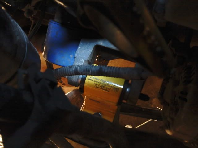

I love late night wrenching I was bored and not too tired, so I decided to swap the motor mounts. Who needs sleep
Very impressed with the Brown Dog stuff I'm glad I went this route instead of the budget MML that I planned to do as these are very high quality and nearly indestructible for hardly that much more $$
Here is my stock driver's side mount next to the 1" taller Brown Dog replacement. Notice the crack in my stock mount.
Driver's side mount in place from the top. The biggest pain to getting these in was wrestling the engine around to get everything to line up. I think my engine shifted to the passenger side when I jacked it up which is why I had a little bit of trouble lining things back up again. I got it eventually though
Driver's side mount in place from the bottom.
Anyone that has replaced there motor mounts knows about the passenger side mount. The factory puts the "through bolt" in from the front when assembling the Jeep but then you can't remove the darn thing without pulling the alternator. The solution is to remove the entire engine bracket from the engine block and then flip the bolt when you reassemble everything. I attacked the engine bracket with some extensions from the passenger side wheel well. Here is the engine side motor mount bracket and passenger side motor mount.
Next I threw the engine bracket back in place and re-torqued all the bolts with red loctite
Finally I installed the Passenger side motor mount. Since I had already lined up the Driver's side this one went in much easier
And that was it. Not too bad and I'm glad to have it done so I can continue on with everything else. I felt like I hadn't spent much time on it the last couple days so I needed to catch up haha

post #412 of 6493 Old 01-05-2011, 08:08 AM
JJeeper09
Location: Richmond
Posts: 2,190
Nice welding. Those wont be going anywhere!

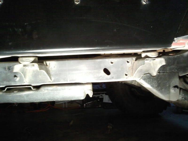

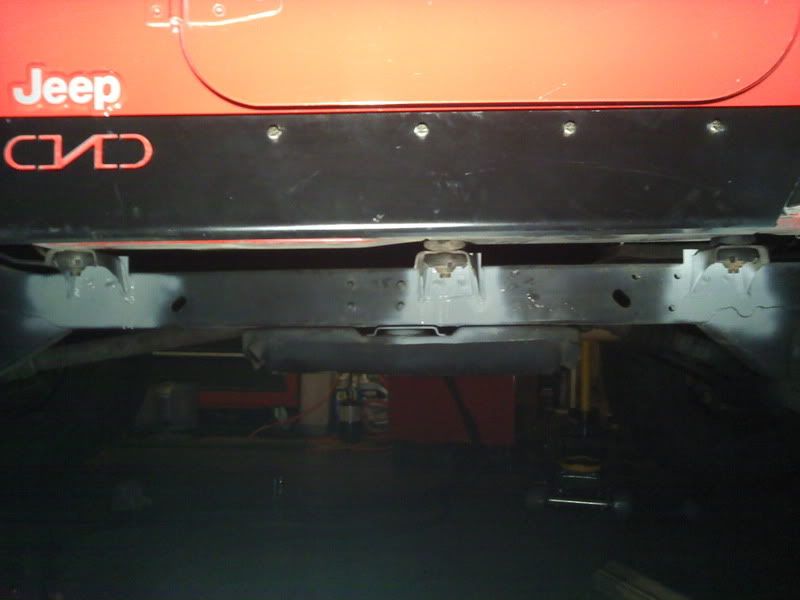

Imped explained the MML very well but I have a feeling you might have been asking about the body lift I'm doing? Most people understand a MML and the reason for it but you don't always see people relocating their body mounts.
- One of the big reasons I'm doing it and the reason I enjoy fabricating vs. buying aftermarket is because it is unique. Most everyone and their mother slaps a aftermarket BL kit in their and calls it good but why stop there
- By relocating the body mounts I gain 1.25" of clearance under the body mounts. Any added clearance I can get is great. I have hit the body mounts on the trails before
- It also made the cost of my BL much cheaper since Savvy let me purchase 5 pucks vs the whole kit.
The reason for the BL in the first place is because I'm dropping down the suspension to roughly 3" and in the future am planning to build a tummy tuck belly skid and need the clearance under the tub for the t-case/transmission. I wanted to complete the BL before the cage so I could build frame tie-ins for the cage and only do them once (the distance would change if I did the BL after)
Hope that's the information you were looking for

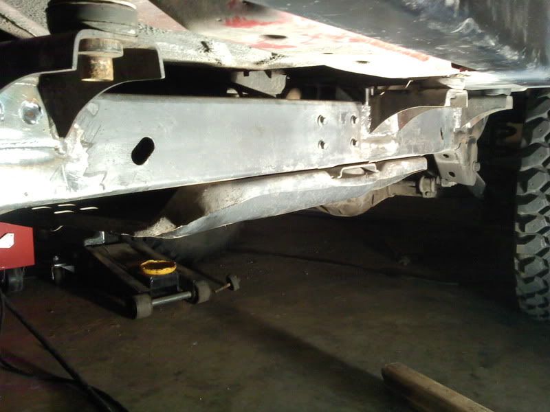

Now, onto what I got done this evening. Pretty much have completed the Driver's side. Hopefully tomorrow I can cut the mounts off the other side and relocate them and finish up the BL. I'm itching to work on the cage now.
Here is a before pic of the mounts before I chopped them off to give you an idea of the clearance gained under the mounts
Finished Driver's side
