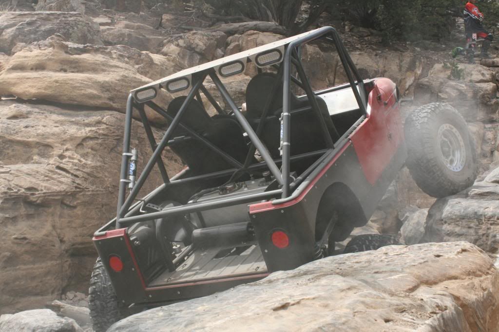

Another angle from the Helldorado waterfall. Man, I wish I could have tried it a few more times

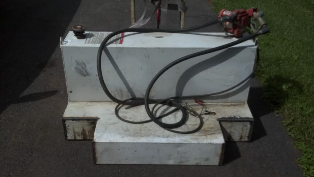

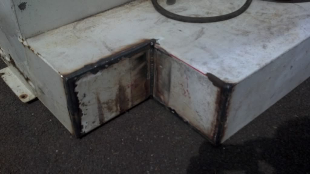

Haha, I wish! I've been getting up early ever morning to work all day. Fist morning back I had to head right out into the garage to do some fab and welding. Had a transfer tank of my buddies that I promised to get done for him before his vacation tomorrow. He needed it modified to fit his short bed truck.
Piece cut
Folded up
All welded up and leak tested

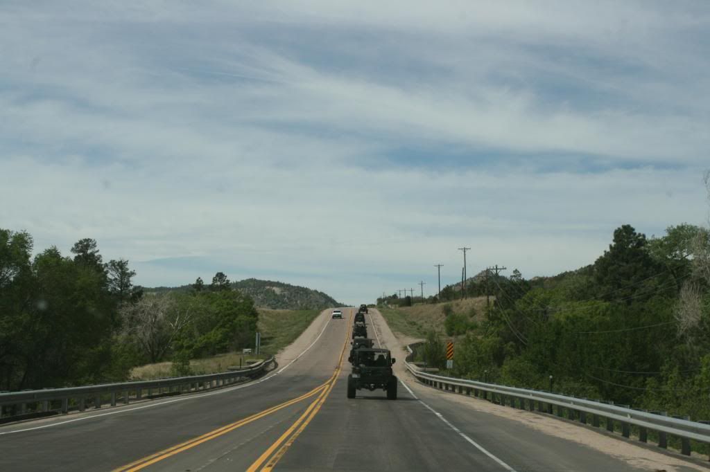

After a late night wrenching on the jeeps, we got up early and met up with quite a few of Mike's buddies from the area to make the drive down to the Independence trail system.
Line of rigs headed down the highway

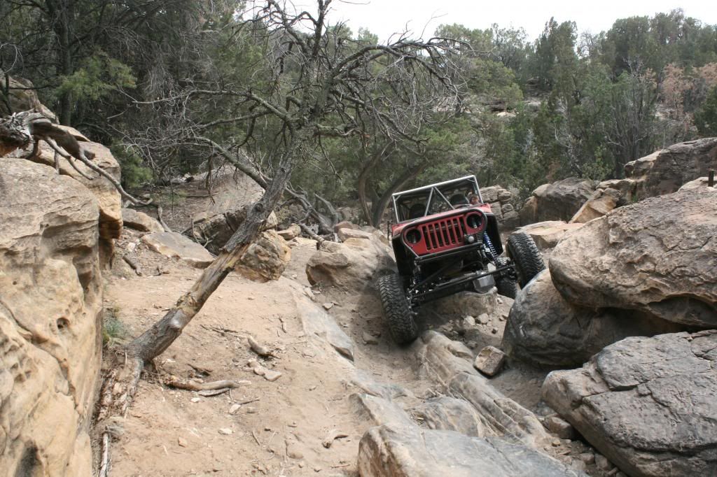

We ran down Liberty trail to test the Jeeps since neither Lu or I had wheeled since the rebuilds. It was fun, technical, but not too difficult. Everything seemed to be working well and functioning correctly. We eventually came to the bottom of Patriot where the rest of the group was making there way up.
I was a little hesitant to run what looked like a fun but very difficult trail being that this was the first run with the Jeep and we still had a week of wheeling ahead of us. I didn't want to tear everything up on the first day not knowing for sure if everything was working correctly. However, I got talked into running it by the rest of the group. In hindsight, it would have been a lot easier if I had turned around and drove back up and out through Liberty with Lu because Patriot turned into an all day effort to get 2 Jeeps with us winched out of the rest of the trail after catastrophic failure.

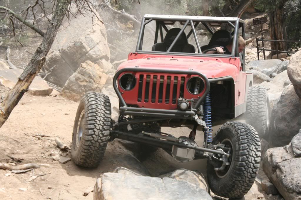

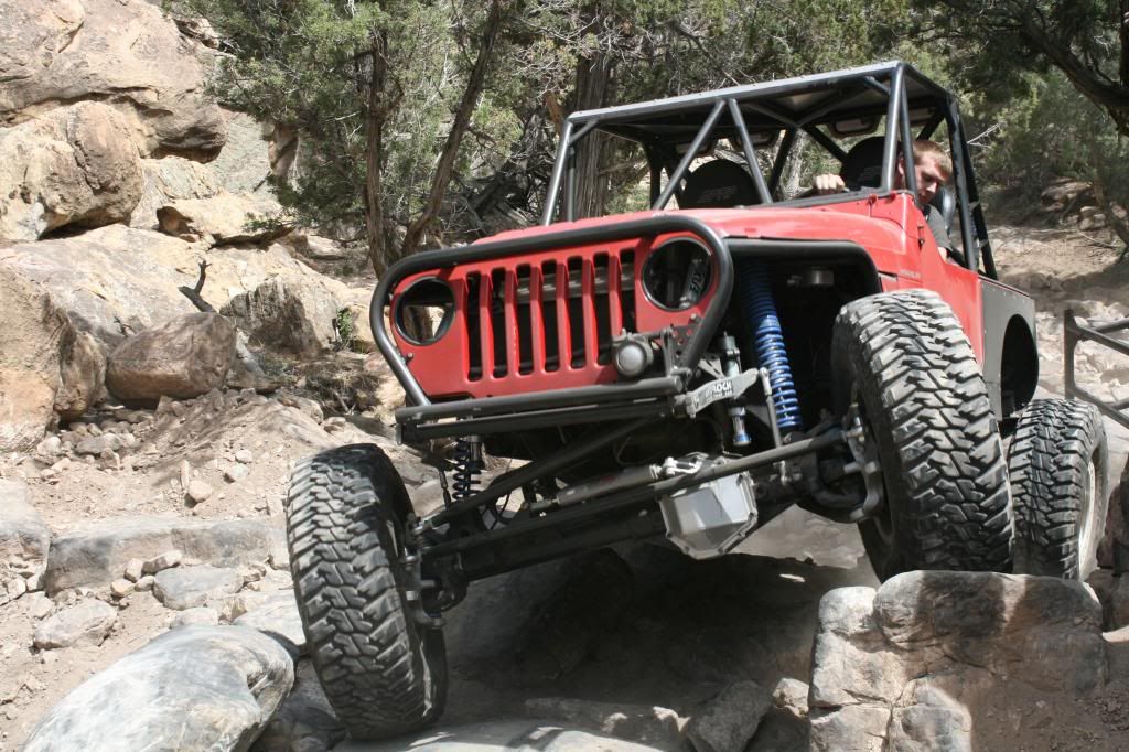

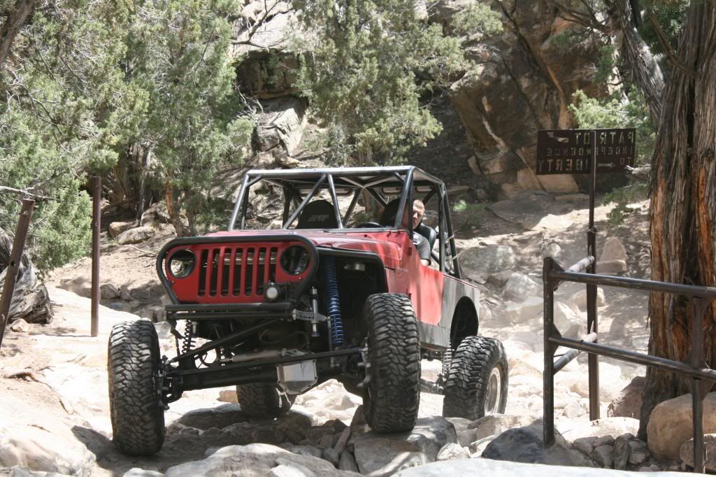

Making my way through the entrance and first part of the trail. By now I was starting to get an idea of what the Jeep was capable of. It was climbing great and the hydro assist was a huge improvement. I could actually turn in the rocks!

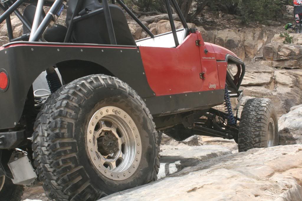

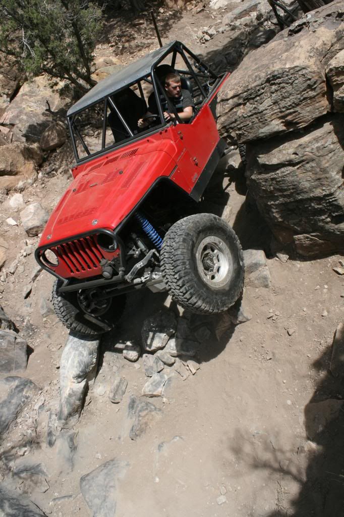

What did become immediately apparent once I hit Patriot though was how severely undergeared I still am. I had struggled on steep and technical trails with my 35s and 4.88 gearing and was hoping the 5.38s and 37s would be a little better. My little 4 banger struggled to find the power in the big rocks on Patriot and you can see quite a bit of clutch smoke in one of the pictures below. I definitely need more gearing in low range but with the plan to buy and Atlas when the V8 goes in, I'm not sure how or if I will address this before that happens.
Also, throwing me off a little was the fact that I had to re-learn driving in the rocks due to the added width. I had become very in-tune with the width before and could easily predict where the passenger tires were riding the rocks on my right but with the newly added width I struggled a bit at first. I got better with it in Moab and will eventually become comfortable with where the passenger side tires are now but it had me struggling at the entrance of this trail.

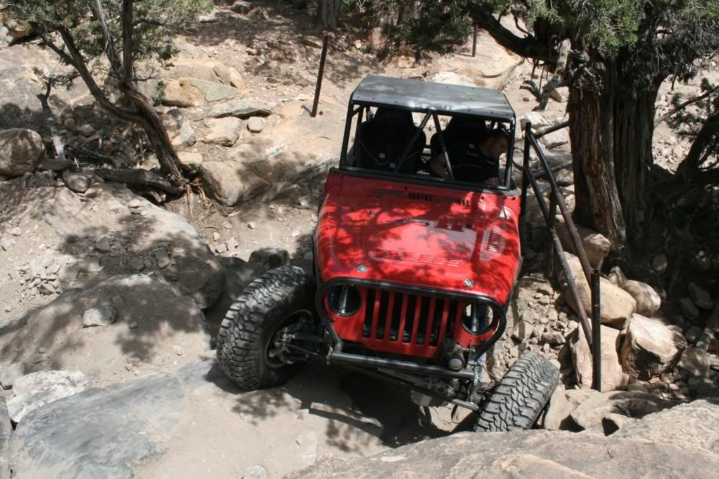

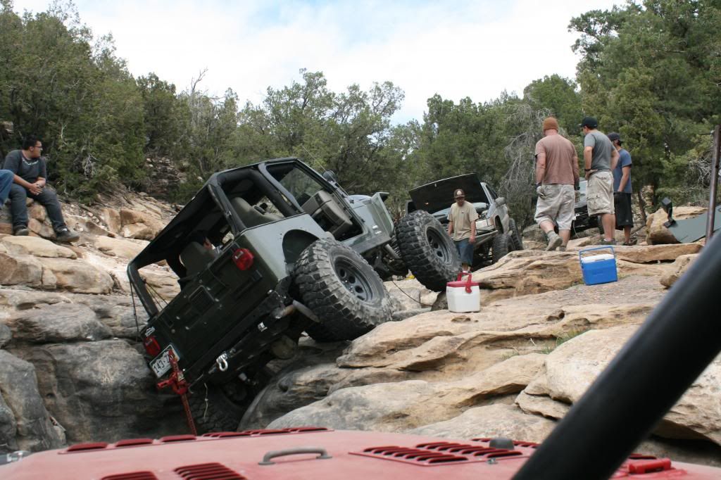

I eventually made my way to the obstacle they call A-Hole. It was a tough v-notch that was made even more difficult by the offcamber entrance into the hole. The jeep in front of me in this picture got in a bad spot, broke his axle shaft and then SHTF. Trying to winch him out of the top wedged his 37" Krawler into the crack, folding it back over itself and bending the wheel all to hell and broke the shock mount off the axle in the rear. Then his stock battery died trying to winch even with the engine running. It killed the jeep and left him with a dead battery. One of the yota's with us spun around and hooked up and started pulling him again. This just wedged him even farther into the crack and also folded his tie rod in half (stock TR on 37's...). Broken and stuck, we didn't move for almost 2 hrs. Once the TR was repaired with a High lift, we decided we needed to back him up and stack some rocks and then get a second winch on him. The ZJ running the trail with us attempted to turn around and POP, the pinion sheared right in half on his HP44 Now 2 were broken passed the difficult entrance and still had to be winched through the rest of the trail and out a very difficult exit. Lu and I had planned to hit the road for Moab by 3-4pm at the latest. It was about 2pm already and we knew we were in for a long afternoon.
