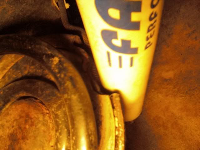

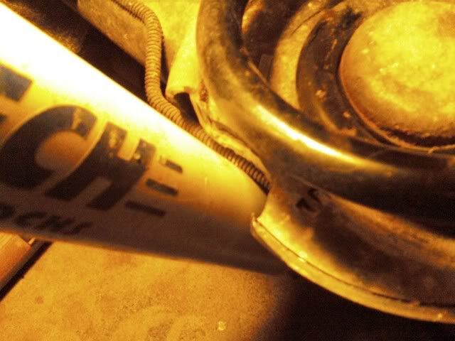

I did do alittle work on my jeep today. When i did my sye and dc driveshaft and rotated my pinion up, instead of relocating the lower shock bracket i decided to notch the lower spring bucket to clear the shock body. Well the shock body was still contacting the spring perch when the axle was at full droop. So, i finally got around to taking care of that today
Just a little work with the grinder and now i have the proper clearance
This is a pic of the passenger side at full extension
And this is the drivers side, plenty of room now
